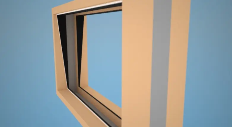

thanks man!! i understand now! : ) u r very helpful! well here in hong kong i can only buy rubbers that are 3 inch wide. so ill prob have to tape a lot the other way around to make them fit. is that ok too?
Keep looking. I'm sure you will be able to find larger sheets or rolls. If you tape it together, the tape will come off over time and allow moisture into the window cavity.
Just what ever you use, make sure that it is permanent.

quick sketch
grey is rubber
