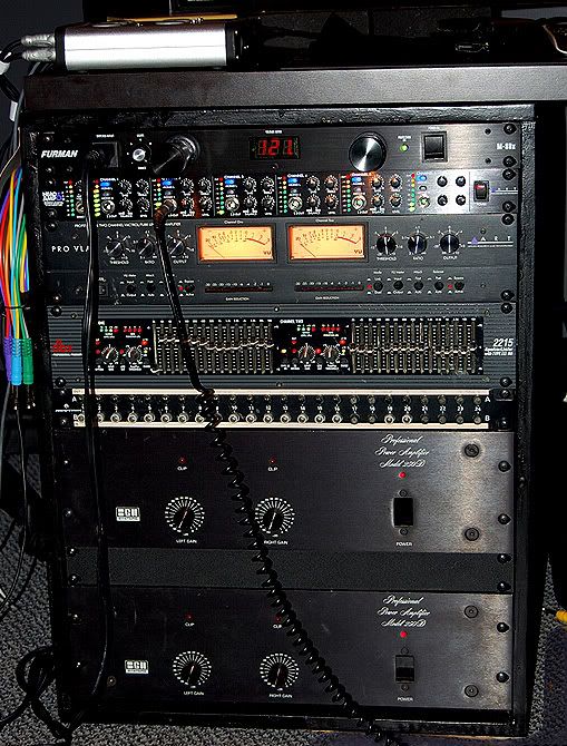

I usually have 2 different headphone mixes available I can set up 4. I have a 4 channel headphone amp that can take any of the 4 aux sends and have independent volume treble and bass controls. Each headphone amp channel can also take a mix of 2 of each console aux. I can run up to 4 sets of phones on each channel of the headphone amp (if needed) that's a possible 16 sets of phones. I do start to scrape the bottom of the barrel with which phones I have when more than 8 pairs are needed, which is almost never.
