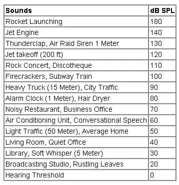

So that must mean everytime a truck passes by or Boray's exposed to city traffic, he passes out from auditory overload????????
I made my comment because Boray has a tendency to overstate and when he's caught exaggerating, he tries to qualify it even more, whether it's rational or not.
I mix at 85 dB, "A" weighted, slow responce measured at my mix position (a six foot equilateral triangle with the monitors in two corners and my head in the third). This ain't loud by a long shot and would say that for my taste, it is on the shy side of the level I prefer to listen at. I do check my mixs at lower and higher levels.
