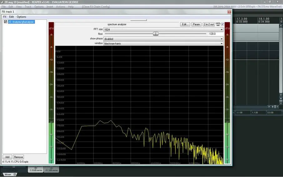

I solo'd the left channel as it recorded 90% noise (especially when there was no music.) I ran a freq. analyzer however, I'm not really sure how to read read one so I've added an image below. I think it's telling me that the noise is covering a large portion of the high end of the spectrum, but I'm not sure.

What do you mean when you say the noise bled? Do you mean that the noise from the left channel can be heard considerably on the right one?
If so then just using the right channel isn't an option, but if not, then as you said, just use the right channel in mono, and get rid of the left channel altogether.
If the noise is still excessive, I'd suggest a sampling noise reduction plugin. These types of plugins can sample noise and then target it with very complex algorithms, which is usually better than one could do with a simple EQ.
Keep in mind, ANY type of noise reduction, whether it's straight up gating, EQ'ing, or complex noise reduction plugins, will mess with the original sound. It's always a tradeoff with these things.

Phase inverting one channel wasnt a dumb idea, but for things to be cancelled out this way they have to be mono, meaning that it-s exactly the same on both the left and right channels. Since this wasnt the case for your recording, it didn't work.
As for some free vst plugins to dothis, maybe some of the other member can help there, or you might wanna try doing a search for noise vsts.
In Reaper, click "fx", pull up "ReaFir". Select under "Mode" "Subtract", "Edit Mode" "Precise". Check "Automatically build noise profile". Select a small area where you only have the noise you want to delete. Uncheck "Automatically Build Noise Profile". When you play it back it should eliminate the noise that you selected. I've only used it a couple of times, but it worked well when I used it. Good luck. I'm operating from memory on this, so refer to the manual for Reafir to verify the process. Page 309. Let us all know if that works for you.
