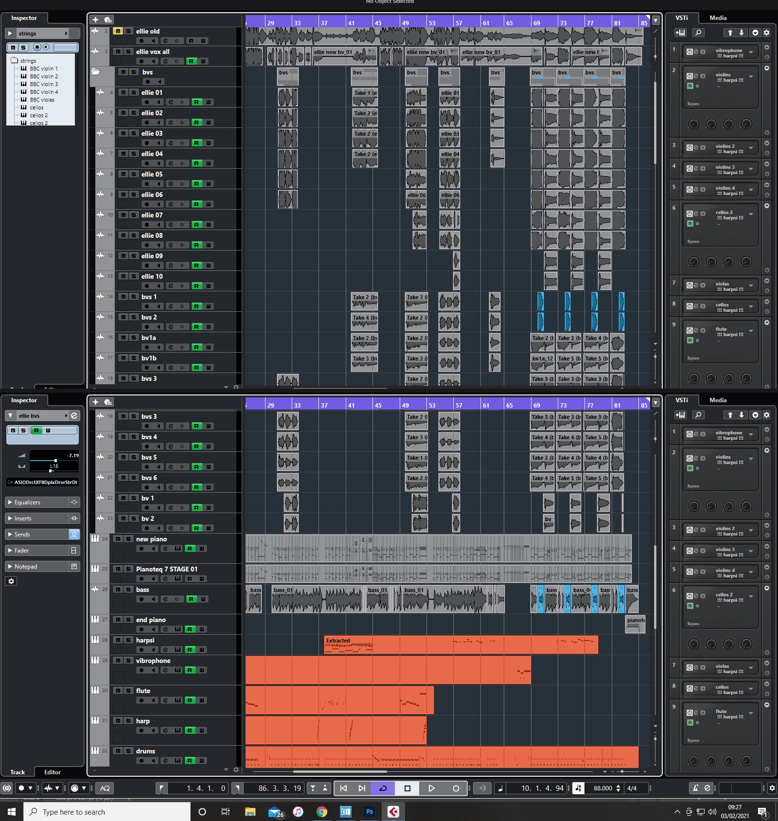

You'll probably hate this - but I can tell you how we did it.
masquerade after reuploading
close to you after reuploading
TalismanRich
It starts with having really good voices, then having very good harmony arrangements.
Here's an example, start to finish.

We do quite a few show tracks, and have got quite good at picking out things from commercial recordings - my colleague usually does the classical stuff, and I take the more poppy stuff, but he started a series of Carpenters tracks for a stage show, where the BVs were tough. We even bought an expensive sheet music package and discovered lots were actually wrong. His brother in the USA has been singing with another well known original band and got us a few studio tracks so we could listen to the stems and pick out more.
What was clear after a while is that what you think you hear is often not what you think. Where the lead line has clearly defined words, the backing vocals might swap some words for oohs or aahs, to stop the lead vocal merging into the backing - but the Carpenters do seem to have a bit of a formula. We know they did lots of harmonies, but the quantity sometimes is frightening. One line will be repeated with two takes, one going left the other right - so you can have her voice at least six times for three note chords, but some of their chords for one voice can be sometimes 5 or six notes x 2. Other times a line will split - two identical lines, that suddenly go one up, then one down - which when layered creates a really lovely sound. I figured I'd just share the cubase screen - Ellie has in one section TEN tracks - split half left half right - but other places just 4, as in just two note harmony. Richard carpenter has his BVs mixed lower, so we did the same, but again - the track count varies, and some you think are Karen Carpenter in the original are him, and vice versa. In some songs, she mangles the pronunciation of some words on purpose to make them fit - removing consonants with sharp edges - really clever stuff. I think with these kind of BVs the biggest headache is aligning them, but now cubase can do much of this for you - designate one BV as master and it stretches and shrinks the others for a better fit - which as we're not the Carpenters works for us! The sheer number of takes this must have taken with multitrack tape is scary - tiny timing errors would wreck it.cubase screen.jpg

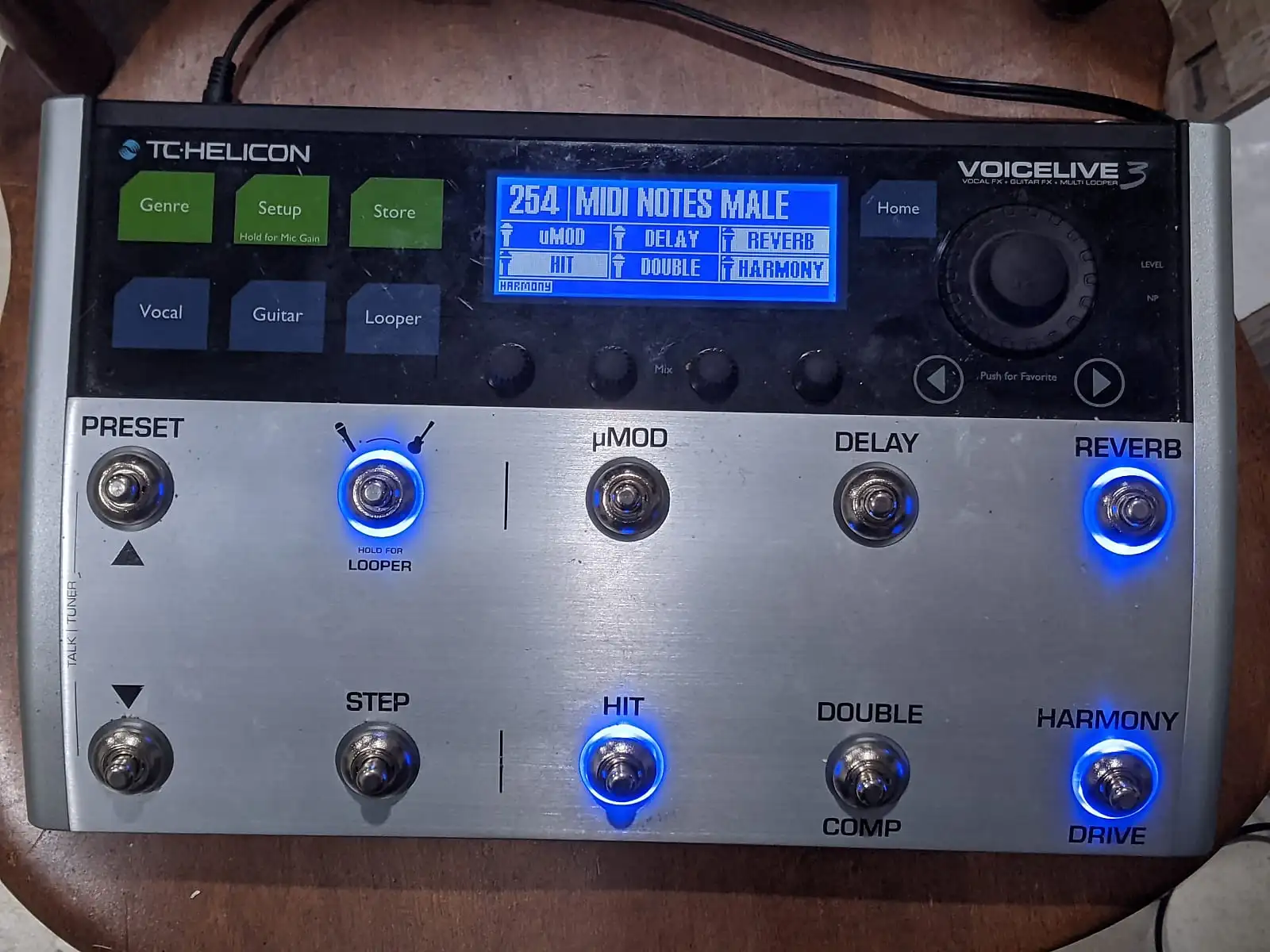

Here's how I do it...:laughings:
I really do get some lush harmonies from this unit ...but with multi tracking IMO it just takes a good singer / singers and getting them to sit in the mix well..That said I am not even close to an amateur in speaking of getting lush harmonies.

The problem with doing it on tape is that you have to make balance decisions very early as you build up the harmonies and wanting a little bit more or less of a voice when they’re buried in layers is impossible. Unless you have 16 or more tracks its just too time consuming and dull/boring for the people involved.probably minimum of four faders to balance in would be my thinking.
The one I shared back up the topic that we did a while back vanished when everything got deleted so we’ve put most back on YouTube, I added another with harmony stuff from the project they did it’s similar.
