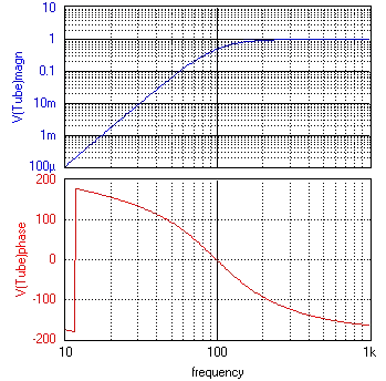

High Pass Filter is when you pick a freq and will only allow anything above (higher) pass through. So if you put a HPF on the guitar at 100Hz it will fade out from their down.
The top of this image is an example. Don't look at the numbers because this isnt for audio. Just look at the curve.
