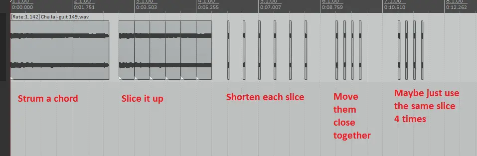

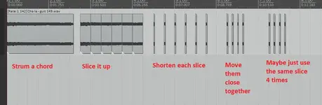

Doesn't sound like the physically interrupted the signal (a cheaper way to do that is to use the pickup selector and have one pickup turned all the way down.)
The way this one sounds, they probably strummed a chord and the cut out slices of it and sequenced those together.
Here's what it sounds like.
View attachment guitar FX.mp3
I also included a slight (.010 beat) fade out to prevent clipping.
You could do a variation on the above where you cut out sections of the appropriate length at the appropriate times leaving the remaining audio in place. That would be most like using a mute switch.
But I agree, the YT example sounds like an edit, perhaps just a repeat of the same short bit of guitar.
