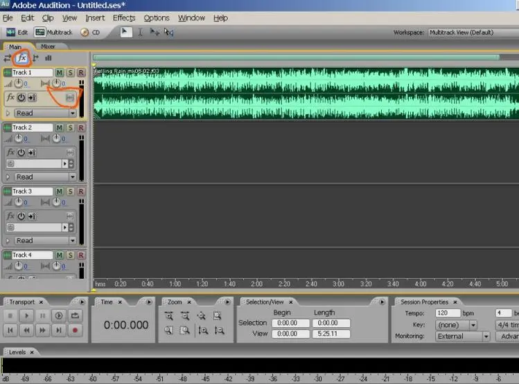

As suggested, while mixing increase buffer size until latency becomes counterproductive.
Other option in AA3 is to 'freeze' the track. This pre processes and edits (still not destructively) prior to play back, but you can not make running changes. i.e. you have to un-freeze to alter any parameter. Freeze is found in the FX tab of the multi-track view. see attached image
