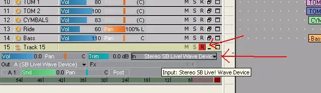

First, prepare blank audio track, and arm it for recording. Select the input from your SB/Audigy.

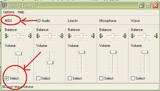

Now, open Windows Mixer (...that's what we called it :) ) by double clicking on small speaker icon on taskbar, beside clock...
click Options --> Properties --> Recording.
Select MIDI as the source. Set the level 75~95% to the top.

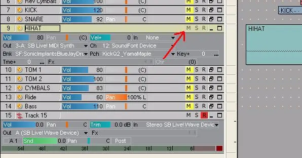

You can record all MIDI tracks using soundfonts into audio at once into one Audio track, however, this way is not recomended. It's always recomended to record them one by one. Each into it's own audio track. eg. MIDI kick drums to Kick drum audio track, Snare to snare, etc... so you'll have total control for each instrument recorded into audio track durring mixing session. In case one is too loud, just decrease the volume of the track in the mix, leave other tracks unchanged. Here's the next step...
Mute ALL MIDI tracks which using soundfont, EXCEPT the one you want to record...

Doing those steps means you tell Cakewalk to record from the soundcards input source (which we have assigned to internal MIDI synth / soundfonts). Now in Cakewalk, hit record... :)
If you do it propherly, then you will have audio track out of particular MIDI / soundfont track. Do not expect it to be right at first trial :) You need to take some adjustment on recording level, panning, etc. After several time of trial, you are ready to go...
Repeat the step (mute MIDI tracks, and record next MIDI track to audio) til you transfer all MIDI tracks into audio tracks. Mix 'em, export to stereo audio wav file, and burn to CD...
