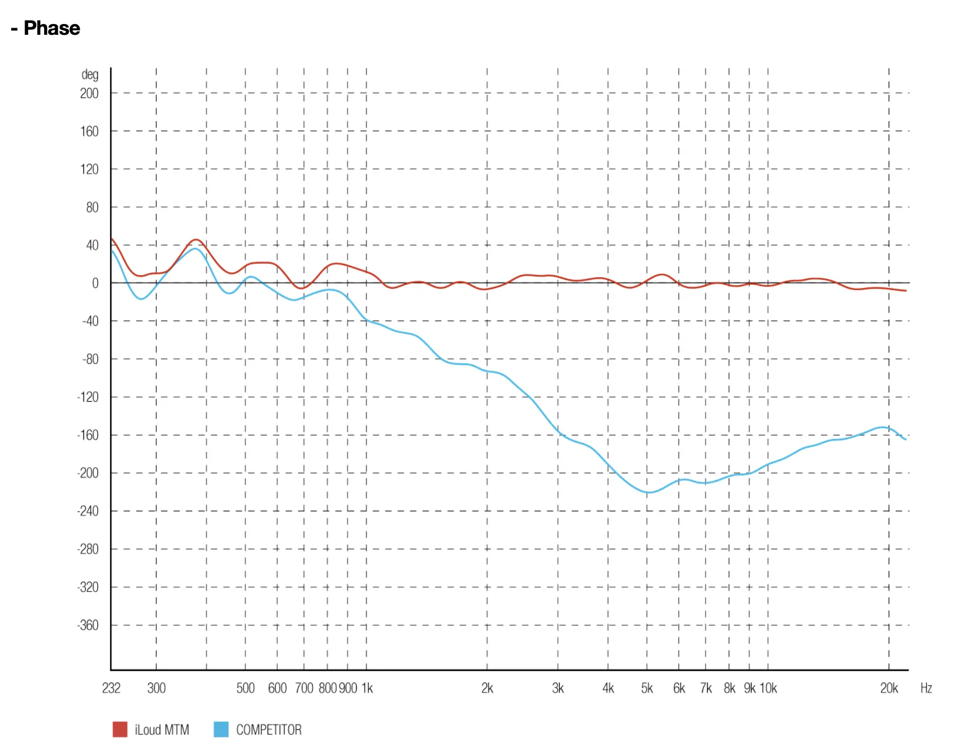

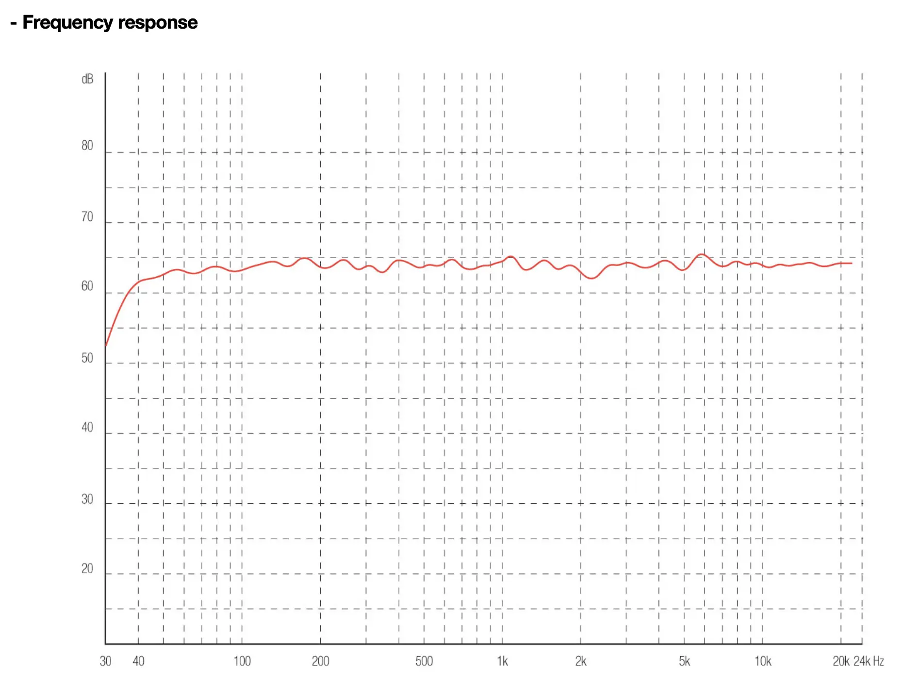

@jamesperrett I do tend to vary my levels a bit as that allows me to make sure the mix is adequate for all consumer systems. My main mixing 'phones are Sennheisers, HD 400 PRO more specifically. While they are quite good especially once you "learn" them, I went with the iLouds because they have quite linear phase and frequency spectra:
