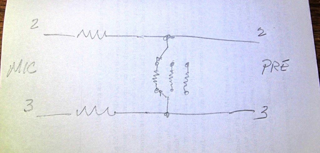

On some forum I was told that I could build an attenuator using 3 resistors in an H configuration. One resistor will be between lines 2 and 3 and the 2 others (2 identical ones) will be on line 2 and 3. This is how I understand the H configuration. I have 2 questions:
1- How could it work with condensers mic? I think that it will drop the phantom voltage, especially if the condenser mic draws a significant current.
2- According to the user guide for the Shure A15AS in-line attenuator, the input impedance is much higher than the output impedance. How is this possible if it is built using only resistors???
