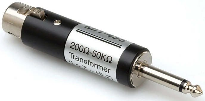

Low Z microphones into a HiZ guitar input = no volume.
Get some of these.
Alan.
