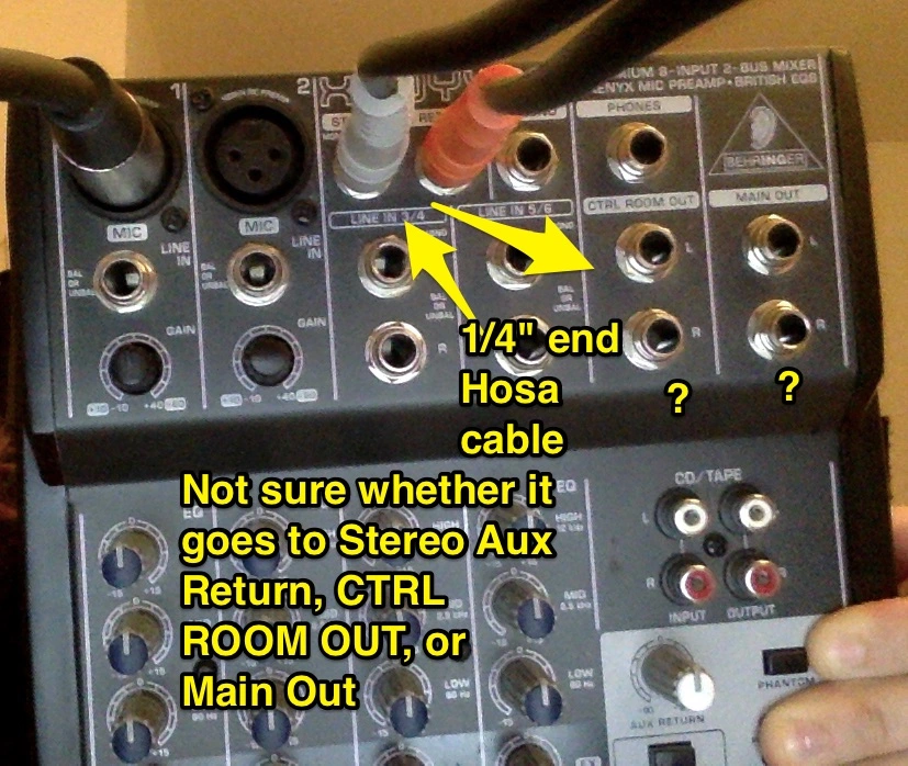

PROBLEM: I am trying to connect an XLR mic to a mixer to a USB audio interface to a laptop. I can’t get a monitor reading under Input in Sound settings in System Preferences in OS X.
I’ve used this equipment before so I know it works, but I moved it all from desk to desk without taking photos and now can’t remember how I hooked it up. I read the user manuals for the mixer and the audio interface but don’t understand them, and nobody seems to be using the kind of cable I have in their tutorial videos on Youtube.
Does it look like I need to move a cable or flip a switch anywhere?
Thanks in advance for any help!

Microphone: Samson C01 studio condenser (XLR cable plugged into channel 1 phantom connection on mixer)
Mixer: Behringer Xenyx 802

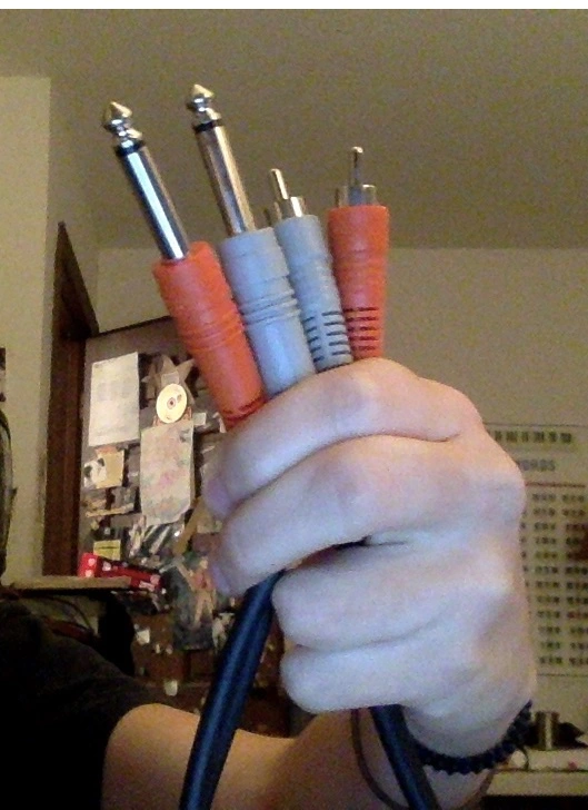

Cable mixer —> audio interface: Hosa dual 1/4” to dual RCA 2 channel cable? Not sure I know what it is so I included a photo below.

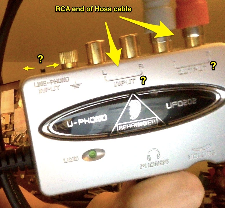

Audio interface: Behringer U-Phono UFO202 USB audio interface/preamp

Mic>XLR . Do the LEDs above Main Mix knob blink? (pan centre for now). If not must do at about -20.
Come out of Main Out jacks > Line in RCA on the 202. Plug AI into USB port. Now you need a mac person. In Windows it would show as being installed then you would need to find it in Sound Menus and set levels.

From the photo, you've got the HOSA calbes plugged into the FX send/return jacks. Like Dave says, use the MAIN OUT jacks on the Xenyx and you shoudl be good to go. But do look at getting a real audio interface in the future.
I missed that this is the PHONO UF0202 and that there is a ? by the LINE PHONO switch?
This simply means that you can plug in a turntable which uses a magnetic pickup and the Berry box will apply the correct equalization and amplification to it (in fact feeding a ceramic cartridge into such an input, by a strange quirk of electronical physics gives a near enough correct response) . "Line" is what you want for everything else.
--Erm, blue power and red phantom power lights blink. Clip lights never have; it's relatively new and I don't understand what makes the clip lights blink. So... you recommend panning the Main Mix knob -20?
--I am an idiot. The knob was all the way left to -∞. Is that why it looked like no signal at all? Thank you. I needed someone to remind me how each knob maps to each pair of jacks.
--Oh, it works! Now I get a reading and am OK. Thank you so much. It must be that I had the Main Mix all the way down.
