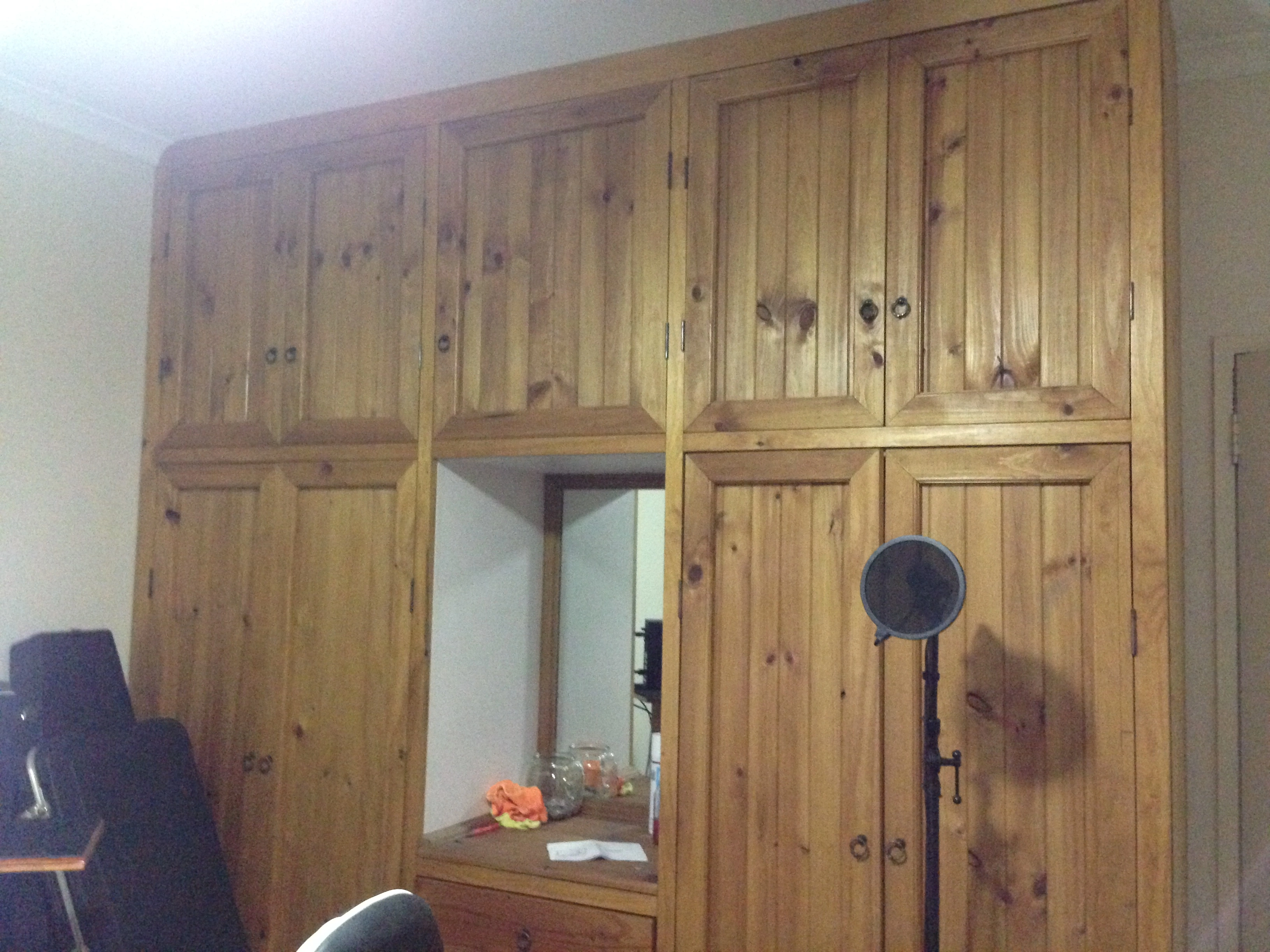

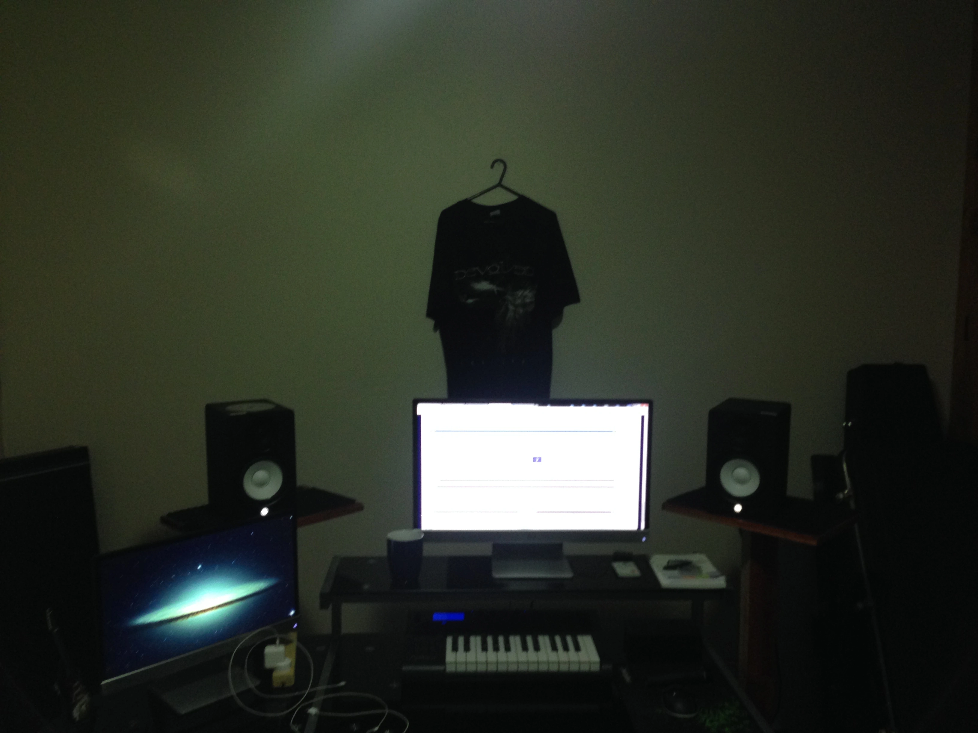

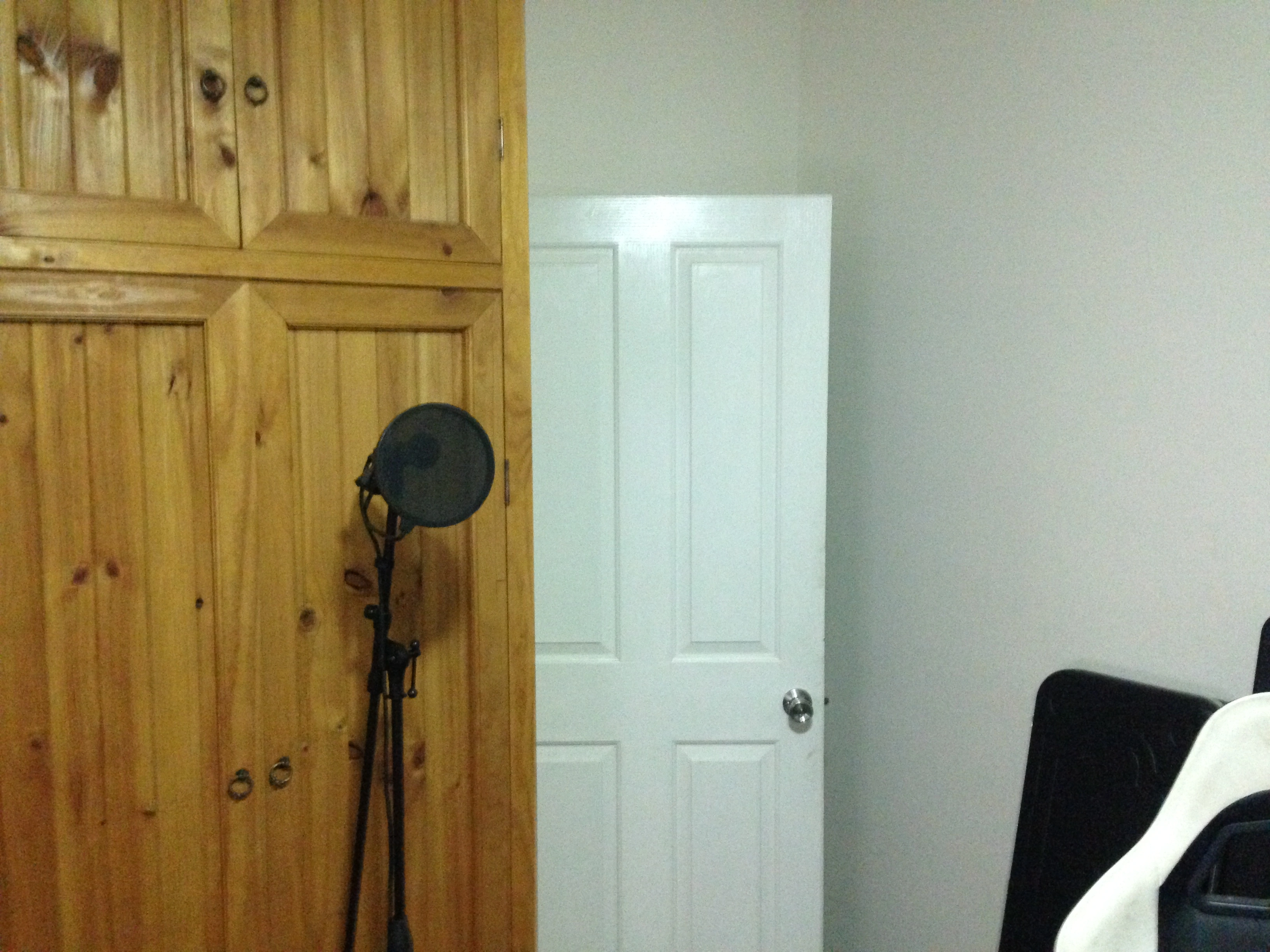

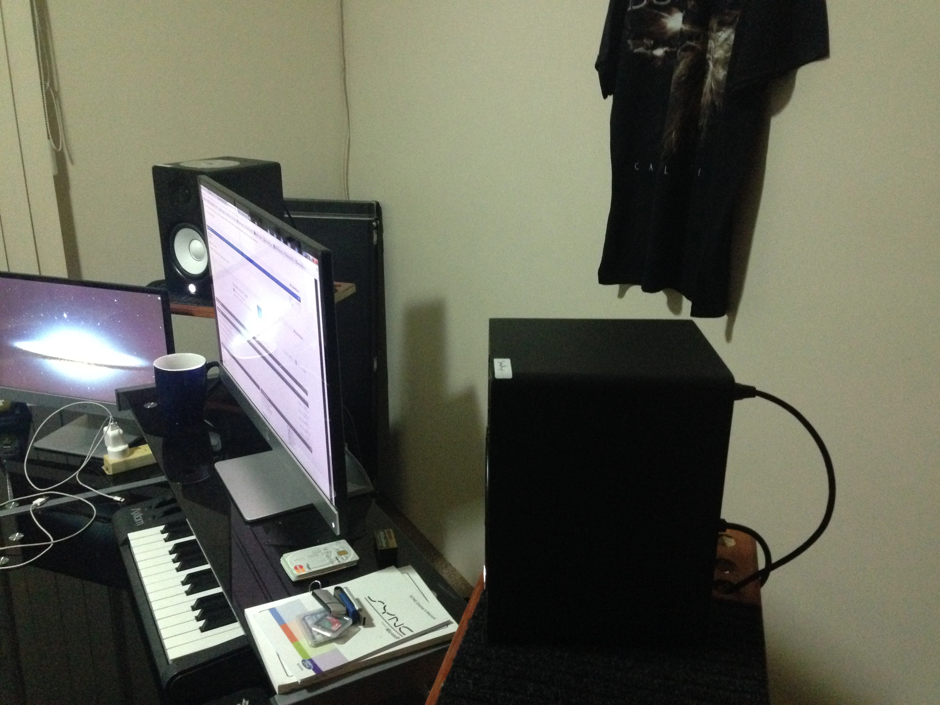

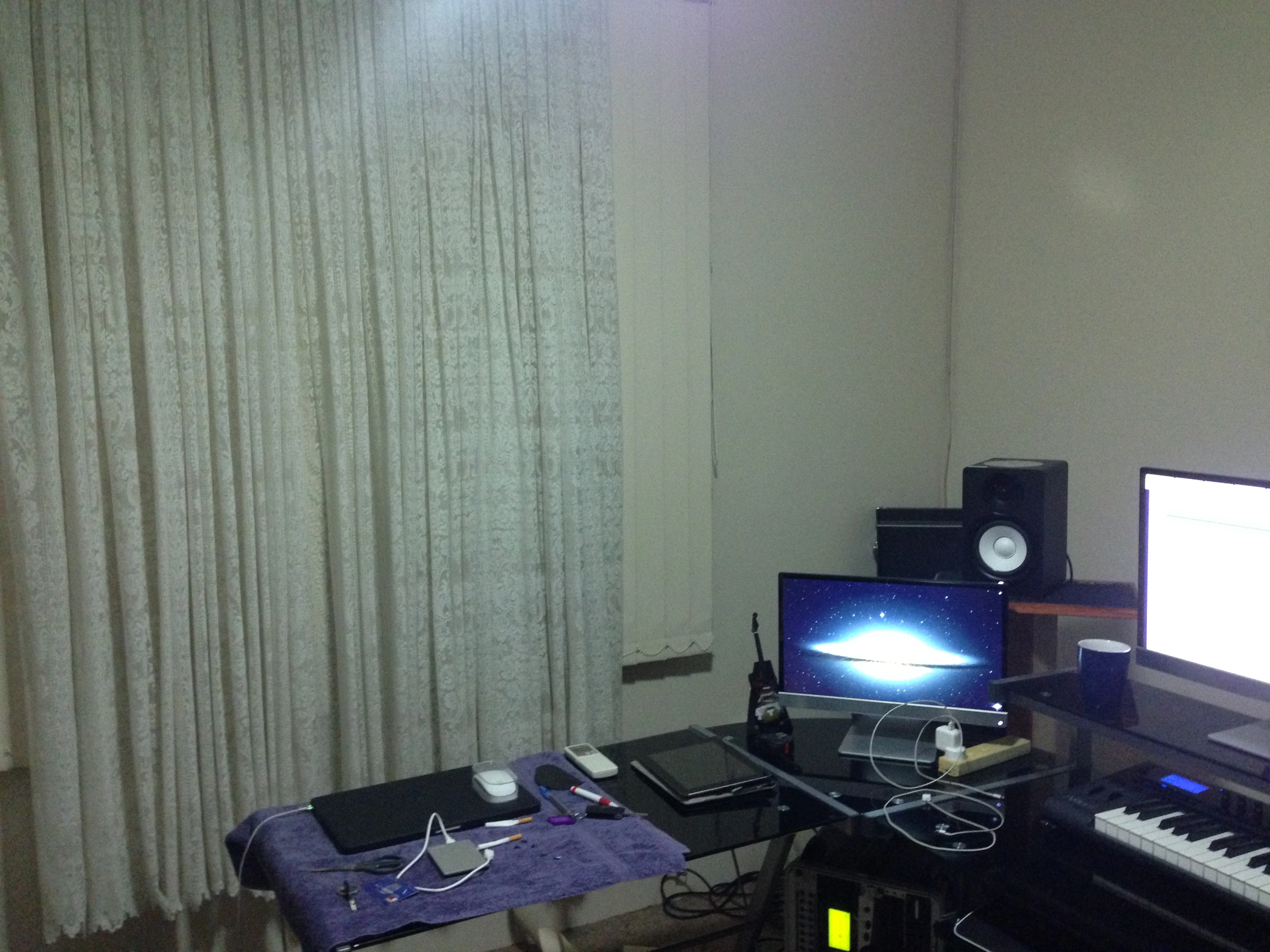

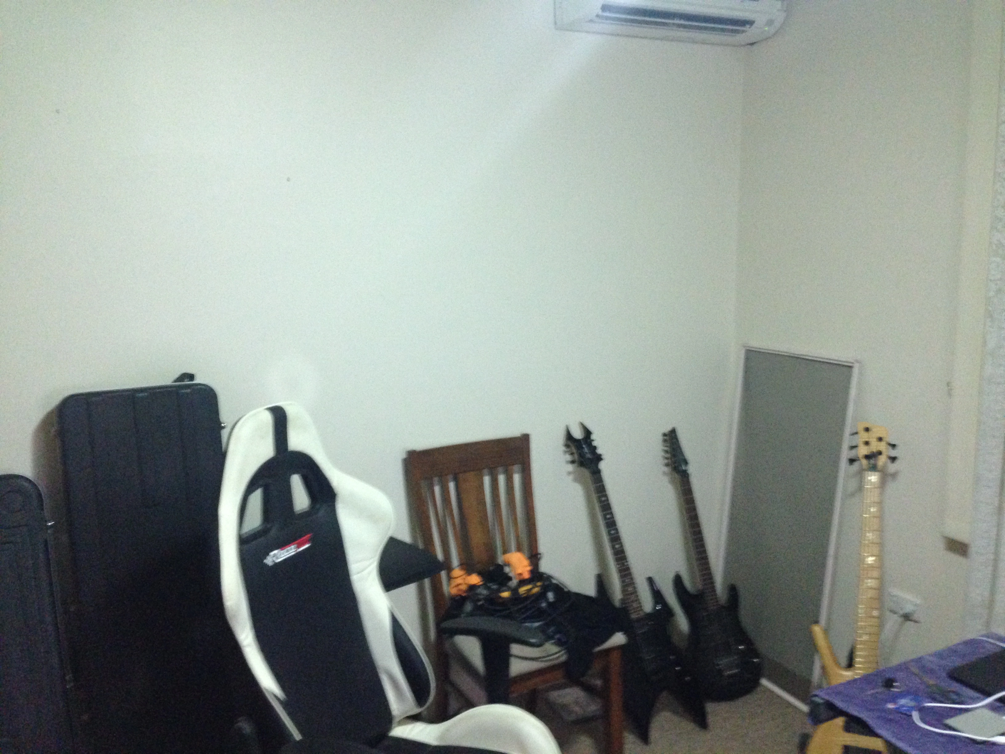

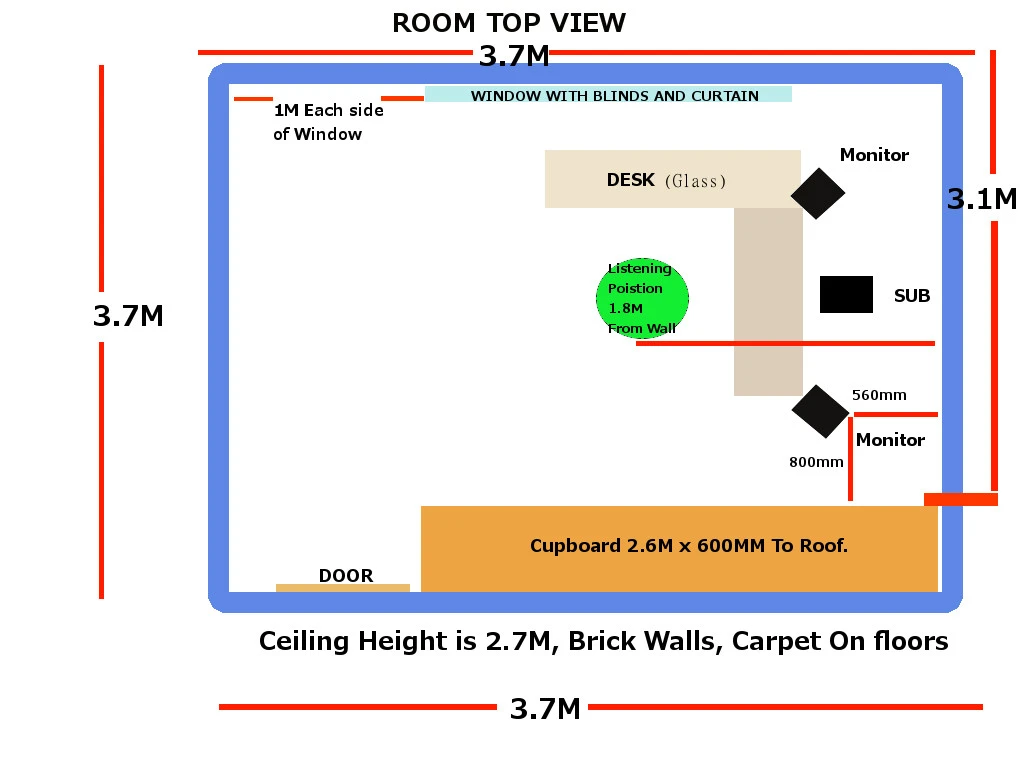

Hi guys,
I have Included Pictures, I do look through the forums and research this stuff but I'm just curious On what you think.
I would like some help with setting up my room a bit better as it is not treated at all and any thing I try mix translates very bad.
The house is a rental property so I cant do anything extreme here.
I have checked my room using pink noise with a spectrum analyzer, I would like to buy a corrective eq but I know its best to try fix the worst first.
I would like to improve the sound quality in here as I would like to mix/master my own music but I have all sorts of problems with the bass in here.
63Hz, 90Hz, 125Hz, 158Hz, 254Hz all seem to be very yucky and the low end in general is all over the place.
I would like to know what I can do improve all of this in the best way.
I can tell I would need bass trapping and some thing for early reflections.
I do have a problem with the room not the same either side of the monitors ( window one side, cupboard the other).
I know that my desk is glass now and needs to go.
My monitors need to be back further and away from speakers.
Any suggestions would be appreciated, I only want to do it once and get as close as I can with out too much.
I use a pair of yamaha NS50's and A yamaha NS8S subwoofer.

You've already figured out what you need - lots of trapping. Build some yourself, or if you don't have a budget limit, buy some. In all corners, plus the first-reflection points and ceiling cloud.
Yeah but I don't know what to do with first refection points to the left and right of desk??
Hang 2" or 4" rockwool panels in those places. You can make them removable so not in the way when not recording/mixing.
