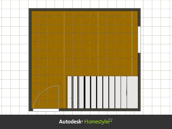

I'm studying music technology in college, so I thought it was only natural progression to move onto some home projects in recording. I am building an extension onto a 2 story shed which is going to be a new room, the roof of the new room will be the height of the 2 story's in the existing shed. The plan is that the new room with the high ceiling would be the live room, while the upstairs room in the existing shed would be the control room.
The new live room will be a basic square room with the stairs to the control room running along one wall on the inside of the live room. I attached a quick diagram of what the live room would look like, just to give an idea of sizes and where the door and stairs are.
The dimensions of the live room will roughly be 11 feet by 12 feet and then 12 feet in height, with a slight slope of about 5 inches from one wall to another.

Disclaimer that I'm not a person who does this for a living or anything - in fact I've got a thread of my own that I'm hoping for answers on (guess I'm now sensitive to threads that no one has answered :) ) I think most of us have to accept a space that's less than ideal - unless Don Henley or Paul Macarthy are lurking on here somewhere. So though I think folks here would say rightly that a room that is almost a cube is not a great choice, that the shape will create strong modes or "standing waves" that will re-enforce each other because the modes would be almost the same on all axis - I still think it can be a workable space if you know its limitations.
I'd like someone to check me, but I think droping the ceiling to a 15 degree slope would help - that'd be 21.6 inches of drop on one end I guess. Bass traps bass traps bass traps is what people I respect say, but I don't like it too dead.

Can you provide a Section drawing showing how your CR interfaces with the new room? Since your CR is on a second floor, and the roof of the new room will intersect the exterior wall, I'd like to see it. And or a plan of your CR as well?
