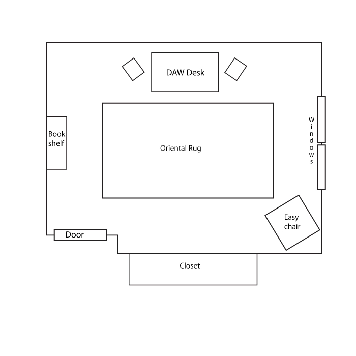

My home studio is set up in a room that is 12' x 10' (See attached diagram). The walls are made of sheetrock. (Standard bedroom construction materials). I have my desk and monitor speakers positioned in the middle of one of the 12' walls that is uninterrupted. Near the center of the wall to my left is a 3 1/2' x 2' bookshelf and in the wall to my right is 2 standard size windows, side-by-side (approx 4'x5' total glazed area). The 12' wall behind me is comprised mostly of a large closet enclosed by two sliding doors. The room's floor is hardwood, a third of which is covered by a oriental rug. I have a fabric-covered easy chair in the right-hand corner behind me (which I assume is soaking up some frequencies). The door to the room is in the corner behind me and to the left.
The treatment I plan is mostly standard - one 24"24"x1" acoustic panel at ear level on the wall to my left, one 24"24"x1" acoustic panel covering one of the windows to my right and two 24"24"x1" acoustic panels on the wall in front of me directly behind my computer. I may put one foam bass trap in each of the corners at about the 3' mark when I can afford them. For now, the immediate treatment will be the panels. The panel vendor will very likely be Acoustimac.
My question is regarding what to do with the closet behind me. Should I take off the closet doors and move the aforementioned bookshelf into the closet to act as a diffuser? I have another bookshelf about the same dimensions that I could place right next to it. Both shelves are full of books of various sizes. Maybe I could hang a heavy curtain in place of the sliding doors? Also, would it be better to cover the window to my right with venetian blinds instead of an acoustic panel as a compromise to window visibility? I believe I read recently that blinds can act as a diffuser.
Thanks for your input...

You should set up along the short wall. I would set up right in front of the windows.
Also, forget about "FOAM bass traps", that's an oxymoron. Foam doesn't treat a room for bass, even if the manufacturer calls them "bass traps".
+1 on all counts. Turn 90 degrees clockwise and start looking for proper broadband treatments for the space. In a space that size, you're going to need PLENTY.
I was in a space that size for a bit -- It took a dozen 2'x4'x4" broadband (not "foam" but OC 703 & 705) panels just to make a dent.
Noisy gear goes in the closet (which will be much more accessible once you turn to the right) and blinds don't act like diffusers (well, perhaps they might in a band so narrow that it wouldn't make a difference anyway).
Thanks, guys. I had considered turning the orientation length-wise and setting up facing the windows to take advantage of the longer freq travel distances, but was concerned about negative effects of glass behind my monitors. I can't exactly put treatment ON the windows to the extent of covering them up. Ideas? Leave them as is?
Yes, I read that foam bass traps are doubtful. I don't disagree, but I wonder why reputable companies make them, then? :confused: What DO foam "bass traps" do?
A small room like mine would need a ton of treatment? That seems a bit of a surprise. Larger rooms would need less? I read that some treatment is enough to absorb some reflections, but it is best to not over-dampen to the point of having a "dead" room. Time to head over to ethanwiner.com for a more in-depth read!
Leave them and let the sunshine in. Windows behind your speakers is not a major hazard. There are much bigger problems to worry about when it comes to sound treatment.
As suggested above, windows are not nearly as big of a problem as most people think. You would just treat them the same way as any hard surface.
