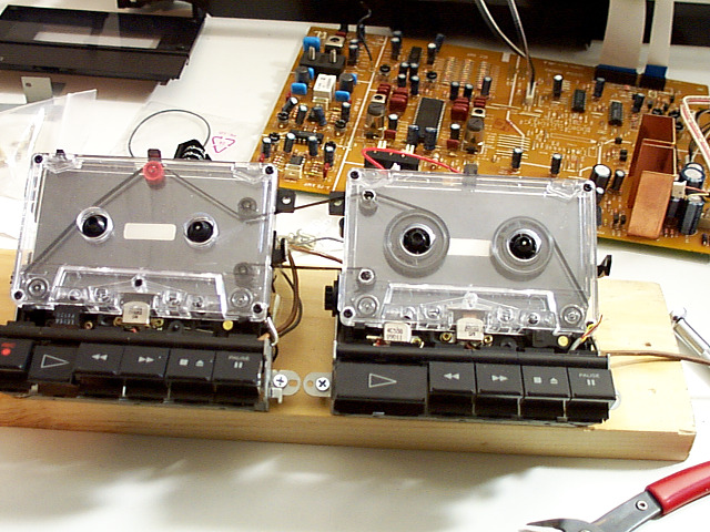

The idea here was to use two identical cassette tape transports, place them one next to the other, build a 'special two-cassette-one-tape' "cartridge" and re-arrange the electronics... so at the end to get one cassette tray act as record... the second as play while the tape runs from second cassette into first and then back into second... okey yada yada ..LOL

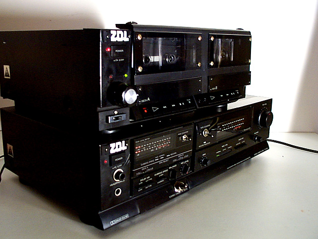

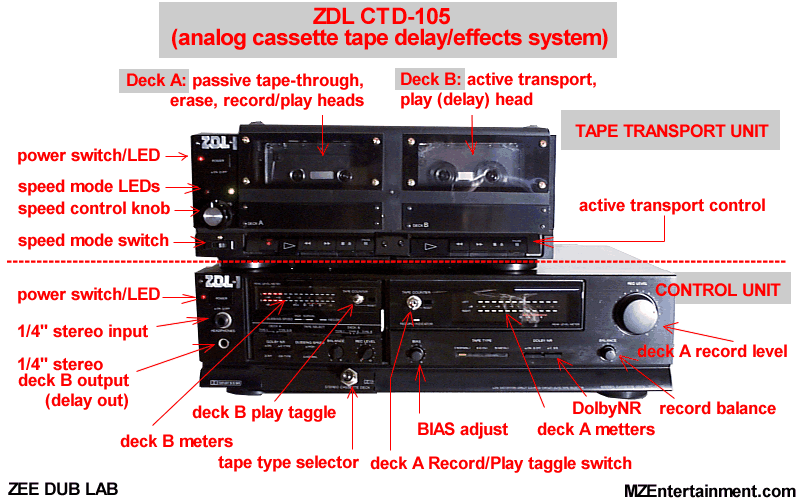

So here is the main front image with all main controls and functions:
as you see the 'machine' is actually two-unit gear: top unit is tape transport with speed control and the bottom unit is where all electronics/rec-play amps, ins/outs and the rest of it. In short to describe: I moved all the electronics from one deck into the other, and tape-transport deck was also cut-in-half and re-craftwed around...

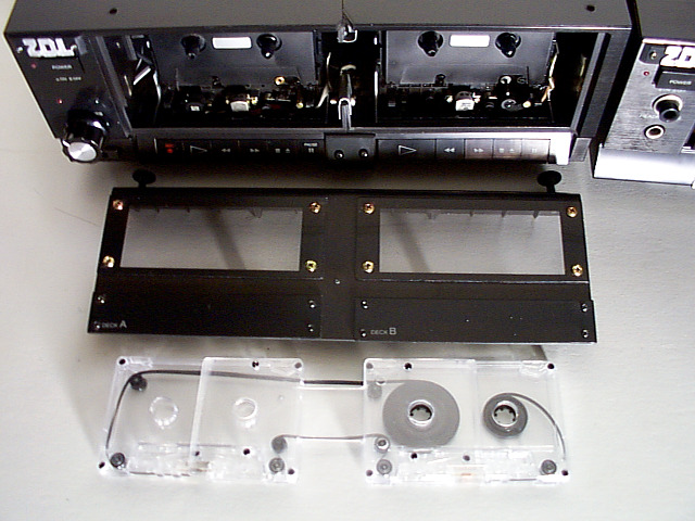

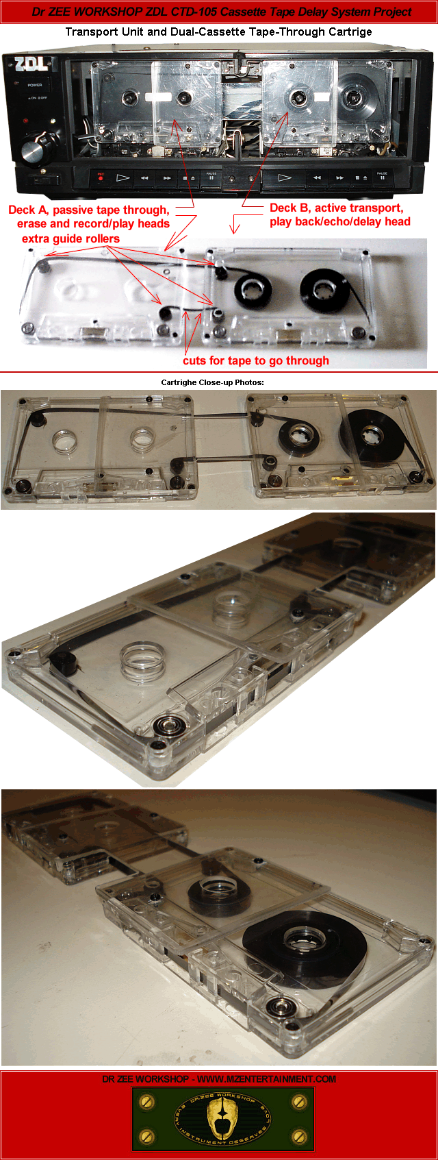

Now here's the 'heart of the idea'. This shows the two-cassettes converted into one cartridge. This was a pain-in-tha-neck to make ..heh heh , see the photo, you get the idea what the deal here:
Note, that only one deck is actually active-transport - the 'right'-deck (play head). The left deck (record head) is passive-through.

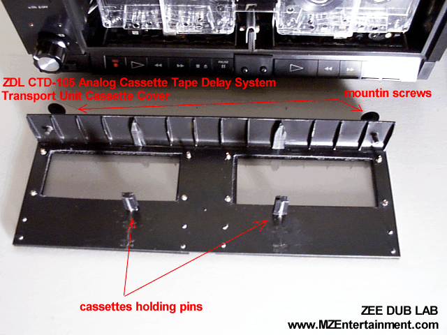

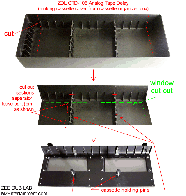

The two cassettes are actually joint-together by top plastic clear plate, and there are cut-holes on the sides for the tape to go through from one cassette into the other. You also see here a specially crafted cover-door, which also acts as cassette-cartridge holder (keeps it in place with plastic pins).
Here's a general view of the machine:
