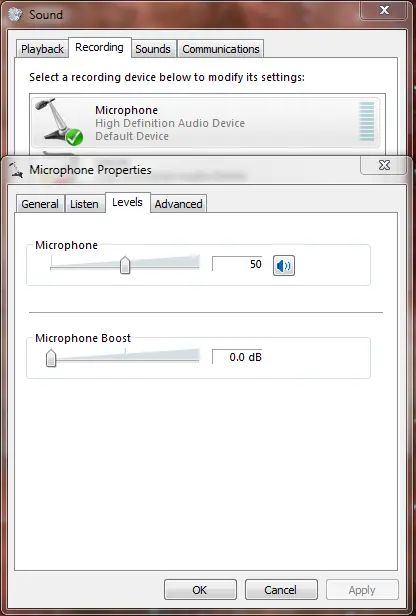

As Mike suggested look for some Windows settings that might boost the mic gain more than needed similar to the image below. There may also be other installed soundcard software that came with the laptop that affects the mic input (my desktop has Realtek Audio Manager).
