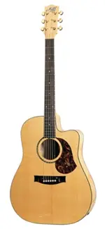

Personally, I still find my son's EM525C slimline easier to get a balanced sound out of than my CW80 and if I were to buy another Maton, I would give serious consideration to their Stage Maple slimline......see pic.
