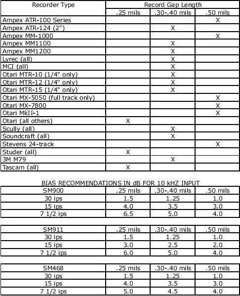

Here's a nice bias chart for RMGI EMTEC tapes
cjacek
cjacek
Analogue Enthusiast
I like that it's all laid out for you, based on the type of recorder, its record gap and bias recommendations for several popular RMGI tapes / speeds.
(Yes, our beloved TASCAM is also mentioned! :D )
I guess you can use those for Quantegy equivalents as well. The SM911 = Q 456 and SM900 = Q 499. Not mentioned is the LPR35 (1mil vers of 911) so the bias should be the same, as is for 1mil Q product like the 457 and 407.

Nice chart... I don't remember seeing that there before. Good to see their keeping things up. :)
Yup, the chart seems new to me too. Don't think they had it up before. Indeed RMGI seems to be NOT following in the footsteps of the Q company! :eek: Good for them .... and .... of course .... for US!! :D :D
