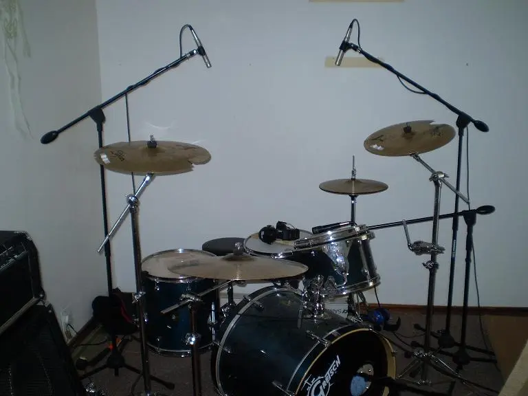

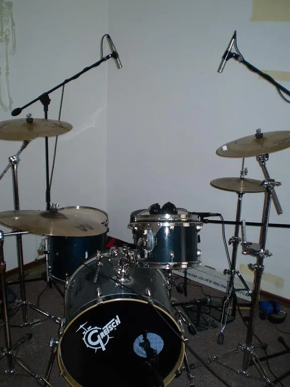

ok so rami and greg you guys said my overheads sounded a lil funky so i took pics of my setup and my room to show you!
the way i set up my overheads was this (read bout it on some techniques page thing)
you "draw" a line thru your kick and snare, and that should be taken as the "middle" of the kit and the overheads should be set up equidistant from that line to get proper left/right panning so the kick and snare are both in the middle when the overheads are panned hard left and hard right.
dont know if this is a proper technique so let me know what you think

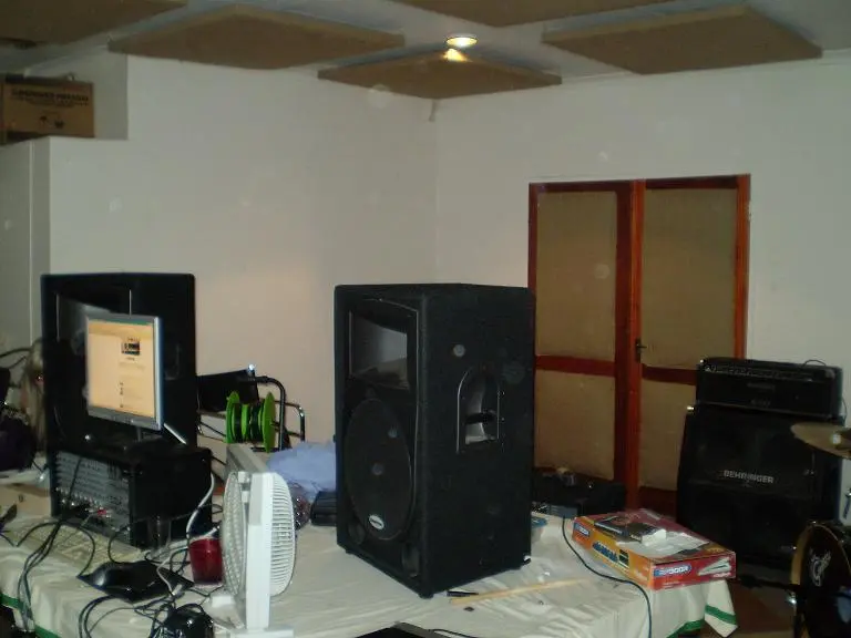

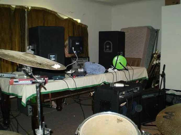

and heres 2 of the room im recording in.

You might try making enough room to move the drums out of the corner and into the room more. It looks like there's not a lot of space in that room, but having them in the corner is less than Ideal.
I noticed that you have a mattress in that room. You could try putting that against a wall next to the drums or spread across the corner behind the drums. It should be pretty decent absorption all the way down into the low mids and should help to tighten up the drum sound.
There are lots of different overhead techniques and you should try them. My 2 favorites are x/y and the recorderman technique. https://homerecording.com/bbs/showthread.php?t=39030&highlight=recorderman+technique
Try this..........
Hi Skiz,
Your set-up with the overheads seems to be the way that most people do it. The funky sound from the cymbals could be because of the condition of the cymbals. I noticed that one has a real big chunk out of it.
Here's what I have been doing and I really like the results. Use only one boom stand for your overheads and get a double mic mount. Set up your sdc overheads as a coincidental stereo pair (that means positioning them at an almost 45 degree angle to each other and almost touching(but not and set up so that they are almost crossing each other. Position these mics directly over your kit up about 20" over your highest cymbal with the center of the two mics almost over the rear part of the center of your snare rim. The end result is a very nice audio picture of your entire kit with both the advantages of overheads and a room mic. Unless you really pound your cymbals, you should with the proper EQ get a very good over all sound. Then you snare mic and kick mic will be on two seperate tracks and you can use them to add more meat.
I think that this will give you a sound that you like.
And get new cymbals man, I mean - OUCH.
I really can't see how cymbals get in that state - are you the only owner? Because somebody needs to sort their technique out :eek:
Your mics seem to be over the snare, with the cymbals 'behind' them from where you sit.
I would try moving them further away from the snare, still equidistant and pointing towards the snare but with the cymbals in between. At the moment they are closest to and pointing at the snare, so you'll get tonnes of snare with a bit of cymbal sneaking in through the side. If you bring them round to the front of the kit, you might find they pick up more cymbals.
