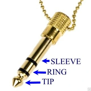

When I listen through headphones using one of these - the sound only comes out of one ear.
I have the same problem with my PA head when I try to listen through headphones.
Please correct me if I'm wrong but is the problem that I'm using a mono adapter and I need a stereo adapter? Would this work? (I need to use 2 pairs of headphones)

The adapter that you posted "When I listen through headphones using one of these" is a TRS (tip, ring, sleeve) stereo adapter. However, the mixer only has TS (tip, sleeve) Mono output. So you will only get it in one ear.

The mixer is designed to mix line level signals, the output is line level. All the signals are mono and unbalanced line level. There is no headphone out.

If you are plugging into a mono source, then you need one of these to sound in both stereo headphone earpieces. Assuming you're using 1/4" connections.
