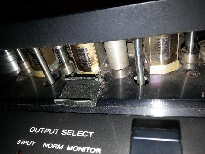

Those heads look pretty worn. +the "disclaimer" of the seller, i think the writing is on the wall. Even if you get it for $200, that machine doesnt look good and you will spend probably a significant amount of time and money on it. Replacement heads for that are also very hard to find. The heads and other parts for the TSR-8, 38, 48 & 58 are easy to find. You can do better with any of those other machines, here's my take in priority order.
