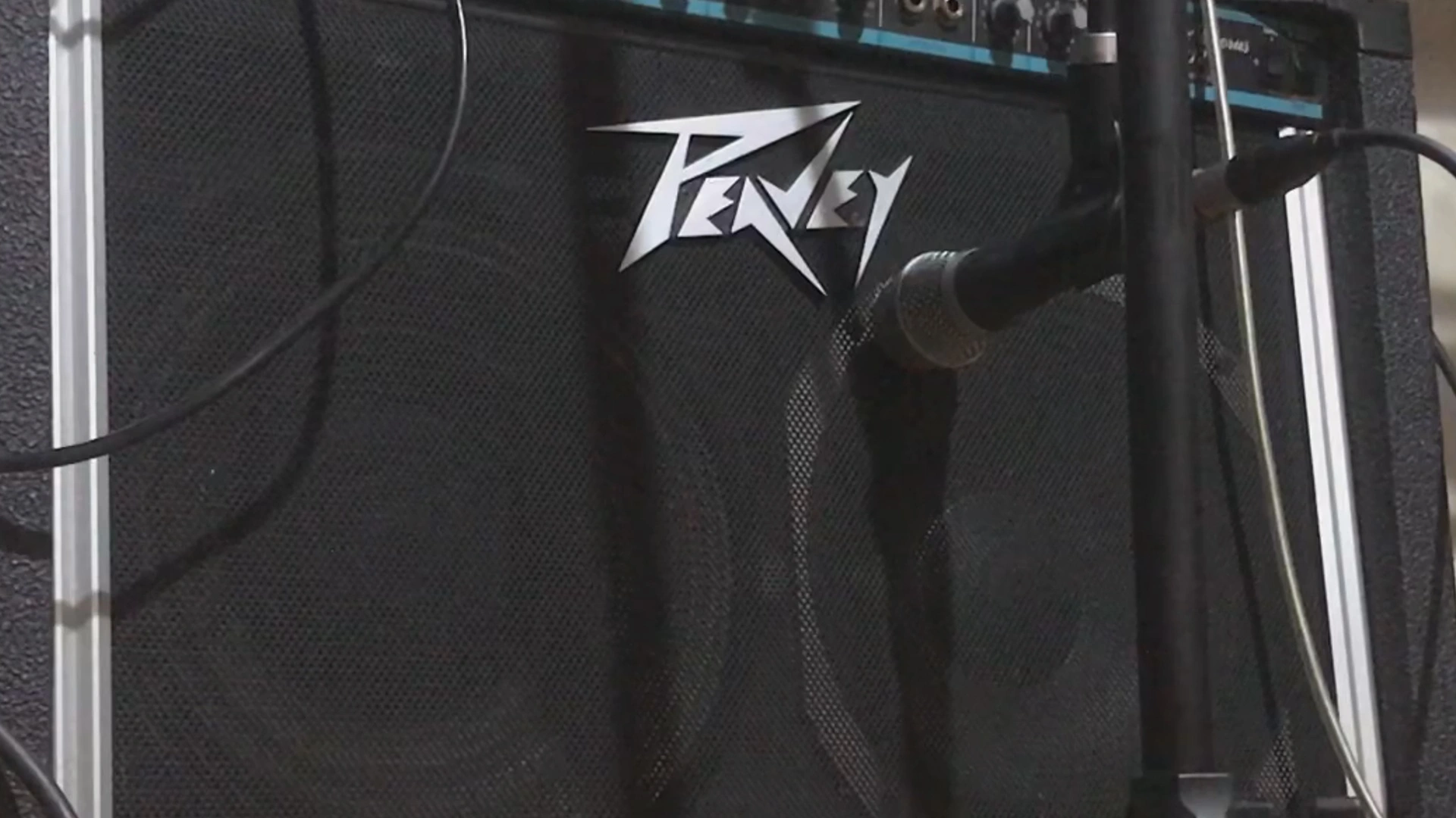

I got a shure beta 87a mic from christmas and i'm planning on mic my guitar amp.
I know that is a mic for vocals, fuck that.

The Beta 87a is of course a capacitor mic and therefore has an extended high frequency response and this can make a guitar amp sound "fizzy" but, peeps do use cap mics on G cabs so give it a shot. Maybe have the mic off axis a bit?
You don't say what the interface is but that mic is some 6dB hotter than a 57 and if you run the amp loudly you might clip the AI's input.

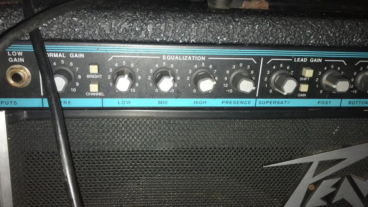

This is a demo that i made, what you guys think about the tone?
I'm not using the gain channel.
