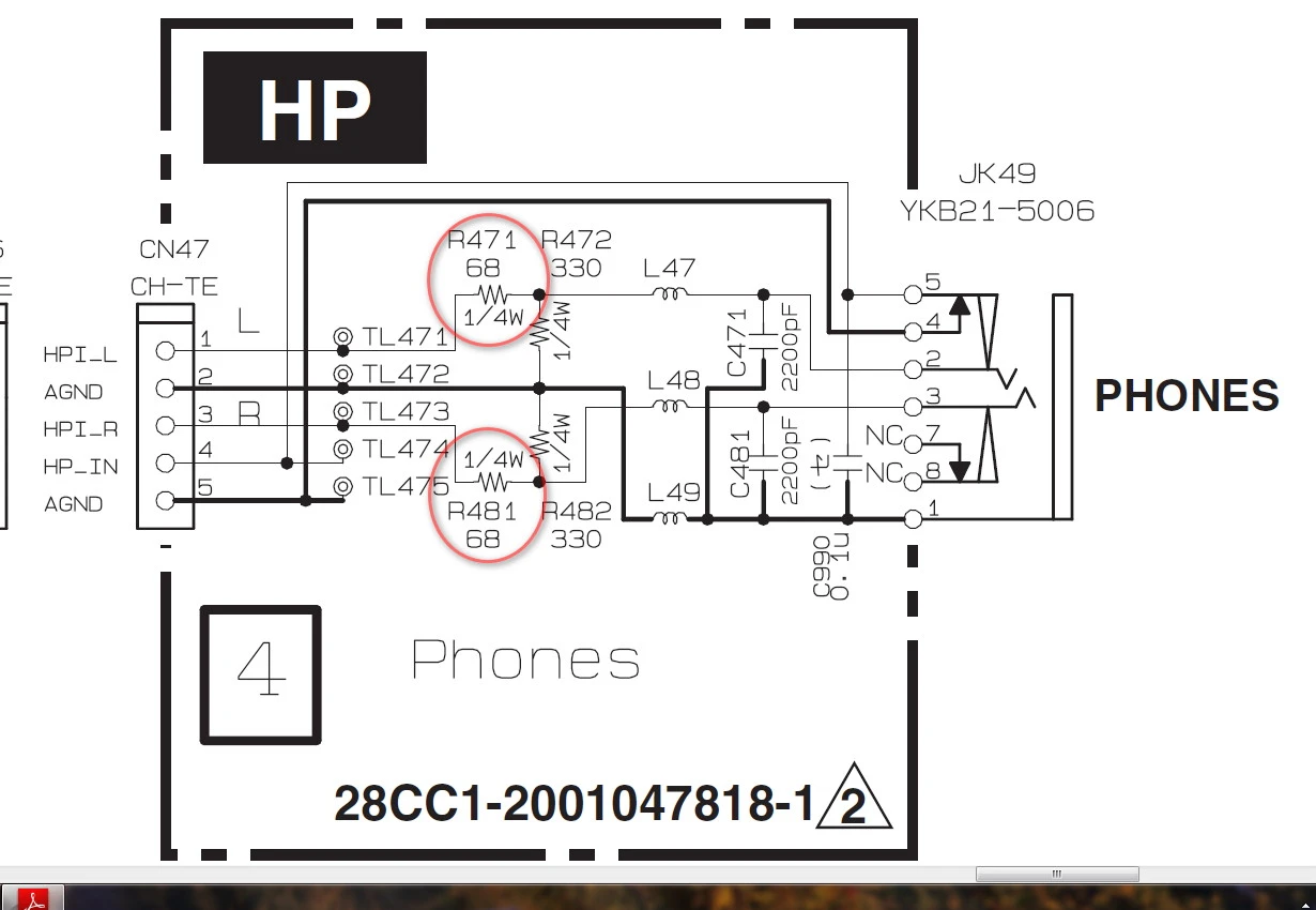

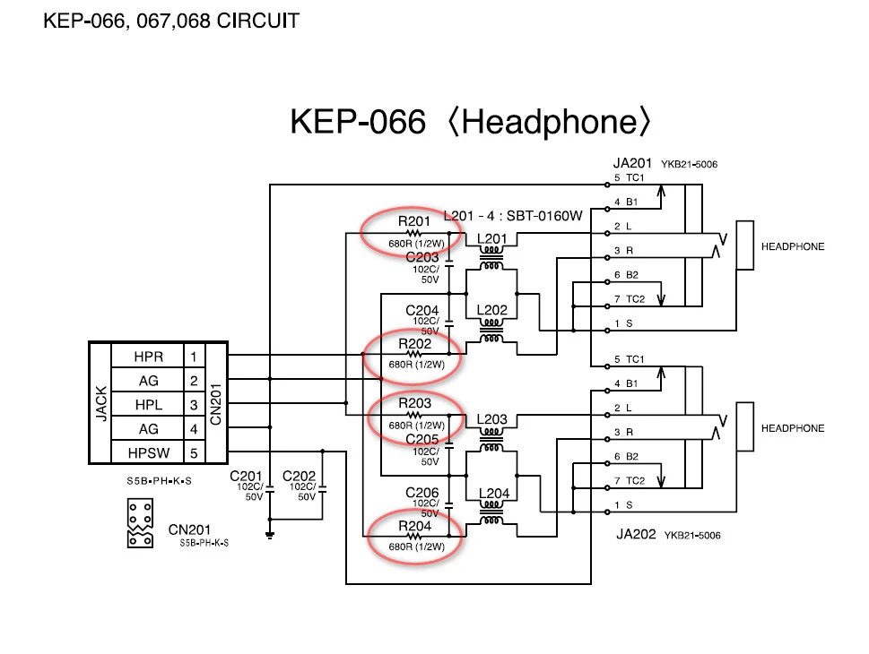

Would generally agree. Most well designed headphone circuits, such as the one on this Yammy keyboard 'should' have resistors to limit current (see image below) in the event the headphones short or an incorrect plug is inserted. If the OP tries the TS cable and it works, we can lead him in a direction to use the headphone jack in a more proper way.
Yes Mark, no sane manfctr would make such a vulnerable headphone amp these days and anyway, in my book, Yamaha never made a bad ANYTHING! Mixer, piano, motorbike...A TS plug IS going to happen!

Kawai CN series digital piano headphones circuit in this picture with limiting resistors...... :)
