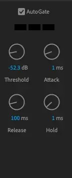

So I'm back in Audition and applying the noise gate (Dynamics in Audition). My understanding is if I have a noise that is -59dB and I apply a noise gate at -52dB, it should take care of that -59 dB blip, right?
For some reason when I do that, its not taking care of all of them. When I ran it twice it did, but I'm not sure why it didn't take care of all of the little blips the first time. For example, the first pass did remove a -54dB blip but left the -59dB blip.
Is this an issue with the release or another setting? I'm not really sure what the other settings mean besides the threshold. Screen shot of my Dynamics settings is attached. Thanks!

The other noise gate setting you have are
Attack time - How long it takes for the mic to go from off to on, as a fade in.
Hold time - How long the mic should stay on after the volume has dropped below the close threshold.
Release time - How long it takes for the mic to go from on to off, as a fade out.
You might have a small peak that is above your threshold for a split second. The release time will hold it on for 100ms. You might play with adjusting your release time as since 100ms is 1/10 second. Cut it by 50ms and see if it helps. It can't hurt to play with settings as long as you don't save the file. You can always reload the original if you don't like the results.
