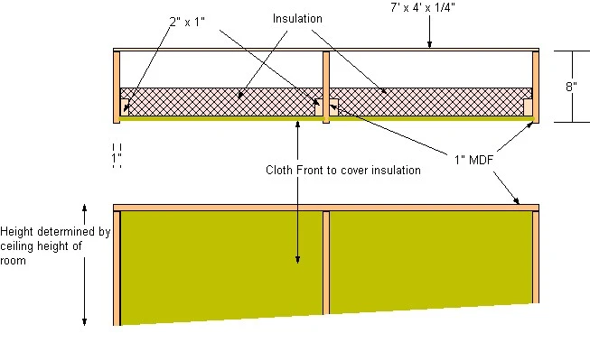

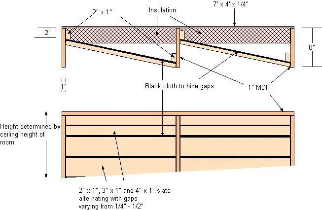

Hey in this design is it sealed air tight? I there a top and a bottom? Also, does a peice of plywood go behind the cloth or nothing at all..which by the way would NOT make it sealed.
this is the pic I meant to post.
Yes Voodoo it is sealed. The only air access is via the gaps between the slats. The cloth is there only to hide the area behind the slats so it looks neat and clean.
The gaps act like bottle necks, each with its own frequency, thus the variation in the slot width and the depth from the wall.
cheers
john

So I have to cut out a peice to fit over the top and the bottom? If the cloth lets air through the slats is it still considered sealed? Should I apply caulking tpo the back of the slats too?
