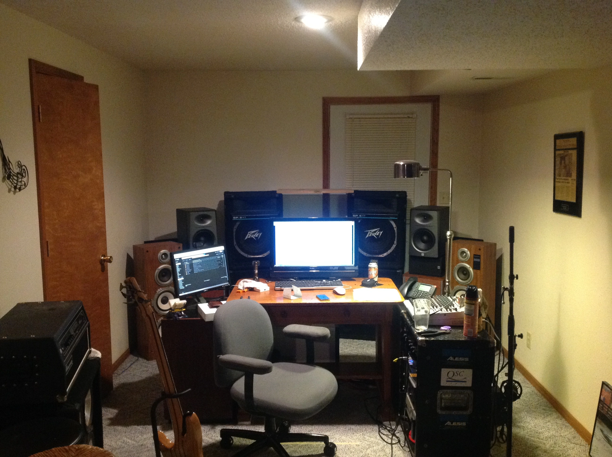

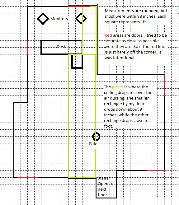

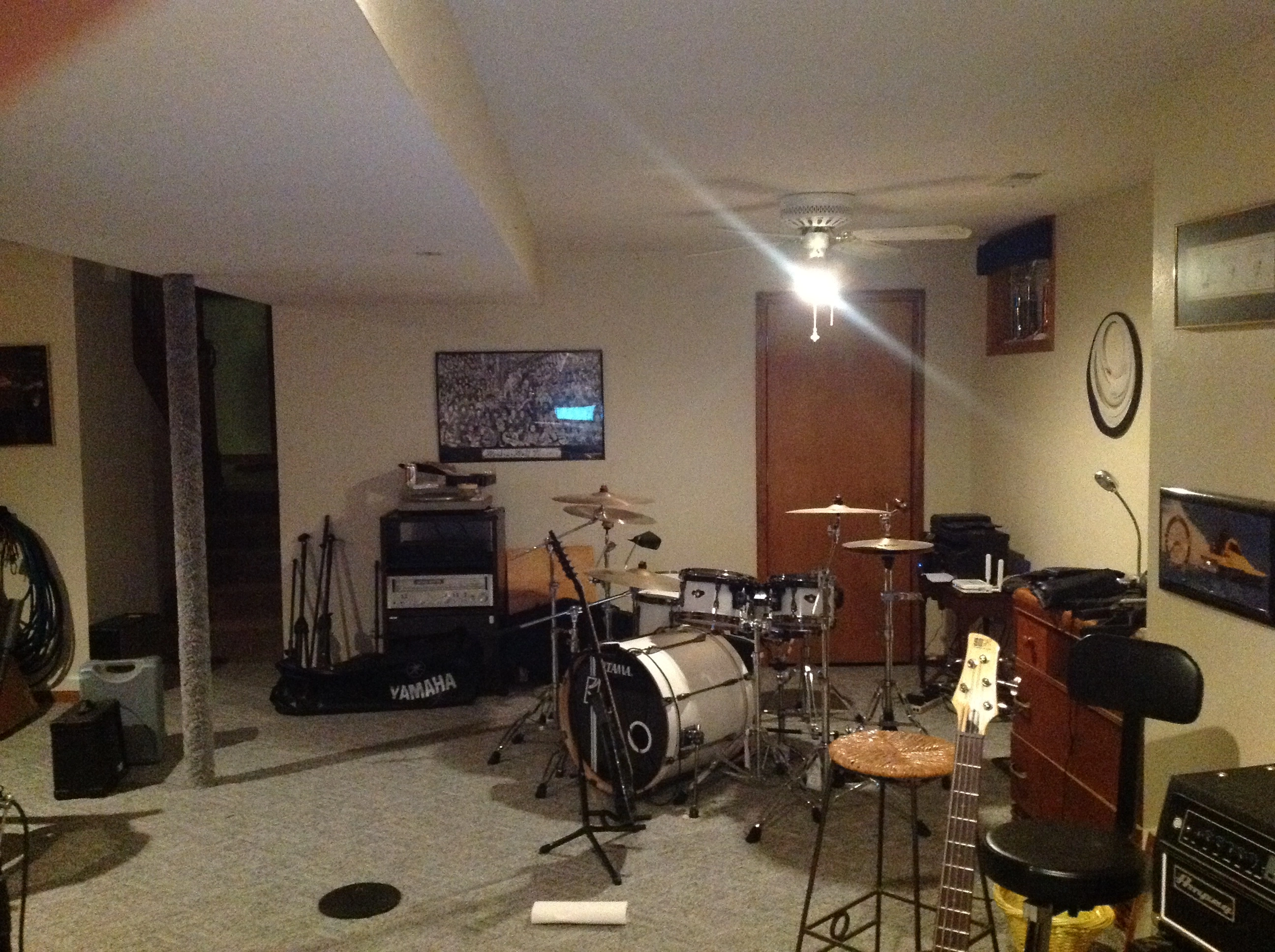

Below is a diagram of my basement floor plan, as well as a couple of pictures. I know its a mess, its not nearly as cluttered when I get it cleaned up. I'm just in the process of rearranging. The 200 speakers behind my desk will not be there, just my JBL LSR2328 monitors. I plan to build some monitor stands also. The stacks of old speakers have served their purpose though.
I know that the air ducts and the pole will require extra treatment.. Unfortunately I can't just remove them. The bass in my chair is rather weak. Usually when I mix something there I end up having way too much low end in the mix. But if i stand up and walk backwards about 2 ft (along the edge of that air duct) you get to the point where you are just hammered by bass. I assume that the bass is being canceled near my chair and that the bass traps will improve this.
Basically I just need some ideas. I really don't know how much I'm going to spend yet, but I'm not just made of money. It depends on how much it costs to do what compared to how much it will end up improving the sound. It would be nice if i could do something to make my drums not sound so harsh, but I know that's just a small room for you.

looks nice except the low ceiling and the big alcove type of design.
Anyways, 4 inch or thicker stacked 4x2 traps made of frames with either Owens corning 705/703 or ROxul SafenSound in each corner. I made mine to be portable if I move. Corner traps great too, if ur permanent go for it.
Side wall 3 inch is fine 4x2 staggered offset on adjacent walls.
Next likely will want a few ceiling sound clouds specially with the uneven ceilings.
This is a good start and you can make all of this yourself.

Yes, make some 2' wide, 4" thick bass traps - tons of info here and on youtube how to do them. If your ceiling/corner height is less than 8 feet, make some traps less than 4' long. 2'x4' is standard size because thats what the insulation comes in. Put them in the two front corners, and the back corners, and you'll probalby want some trapping or diffusion on that back wall between the door and opening to the stairs.
First reflection point traps on side walls (you may need to hang one on the door to your left) and a cloud over your mixing desk/chair area - these can be 2" or 3" insulation, but 4" won't hurt.
