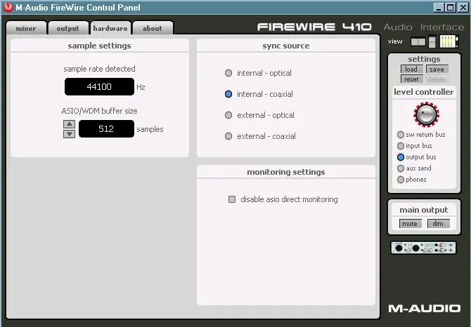

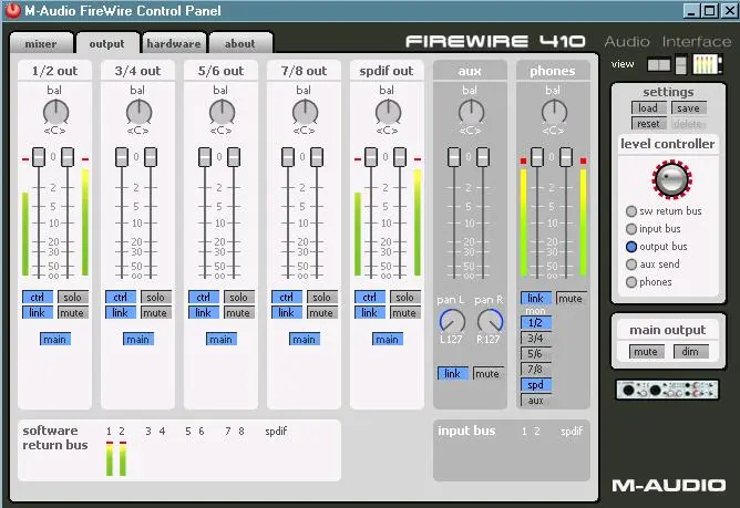

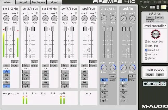

pls look these pics of the mauido console if you want to see the pic of jack audio connection in maudio and cdplayer too i would post that...

I think every thing would look ok in the pictures the green light for the spdif out also is on in my firewire 410... i just think the problem is on the connection its just my guess...
like either the connection is between digital and analogue domain or .. the thing might be dead...
very confused

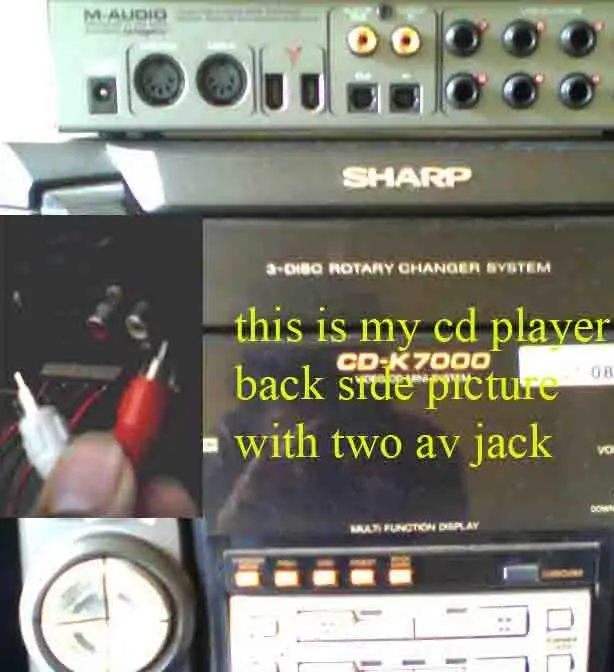

Sounds like the CD player does not have SPDIF can you post a pic of the back of the CD player? I know what the 410 looks like in the back.
i am thinkin the same the cd player dont have spdif connection ...
so now i realised or am i true to play the sound output from the computer i should use the 1/4" jack ... output as shown in the picture
my computer sound to my cd player ..........
my signal chain
computer -- firewire 410-(1)- cd player-- speakers
(1) is the connection between firewire to cdplayer.. where i can connect with spdif if my cd player allows..
i am thinking of 1/4" jacks into firewire 410 output .. via rca cable to my cdplayer...

I think i got the answer the .. rca connector is able to connect with digital spdif coaxial connector too so i was confused....
http://compreviews.about.com/cs/soundcards/a/CompAudioPt3.htm
i think i have rca input in my cd player and digital spdif output in firewire 410 so the connection cant be made...
since the the connector and the cable are similar i may have been confused... what do u think guys ... am i right now...
so instead i am thinking of a connection 1/4" output from firewire to my rca jack input in my cd player i just need a jack.. this would work i know...
yeup. it's quite easy to see actually, as an rca s/pdif cable actually carries a stereo signal, whereas the input on your CD player is quite obviously 2 mono RCA ins (the white and red denominate L/R).
so yer best bet is to get 2x mono 1/4" jack to mono RCA.
