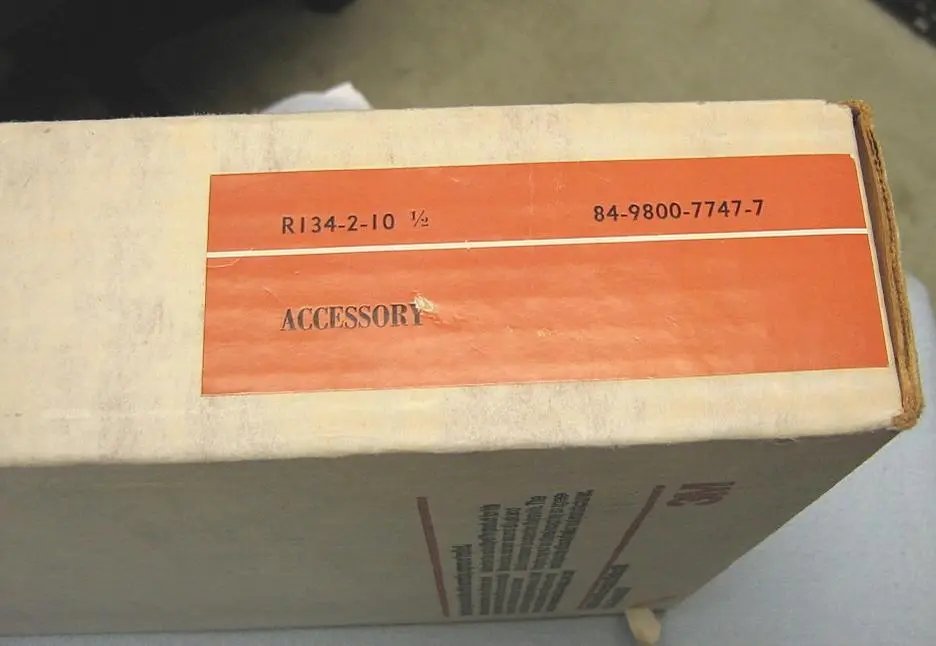

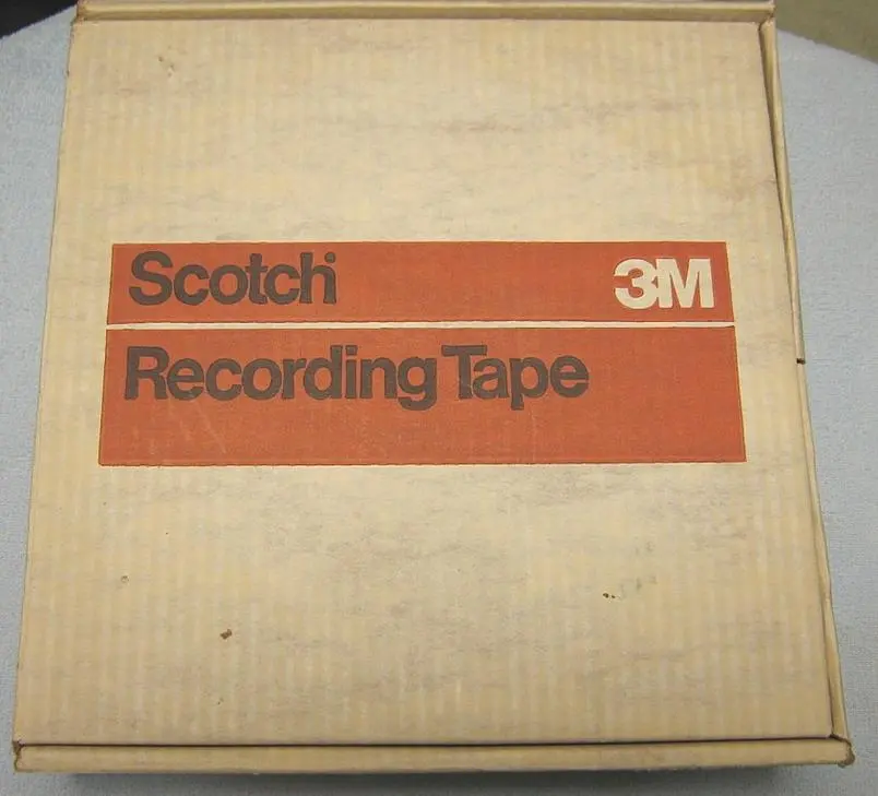

I have a roll of 2" audio tape.

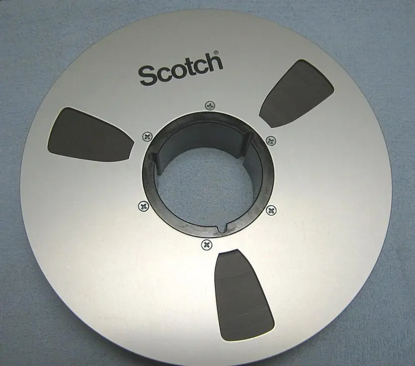

The reel is SCOTCH.
The box states:
ACCESSORY
R134-2-10 1/2
84-9800-7747-7
What I notice about the tape is that it does not degrade in my fingers as does Ampex 456. So it does not appear to be a sticky shed issue. I can't be sure, because I don't yet have a 2" machine upon which I can run the tape until Cory decides to sell me his!!!

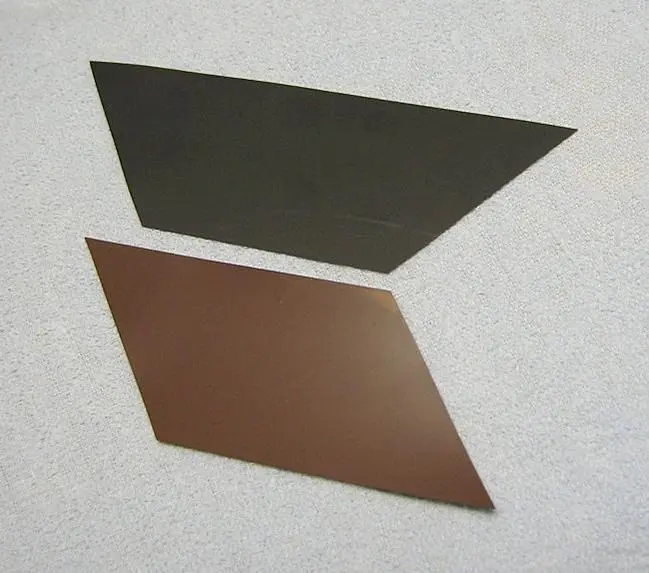

The tape has black oxide-type coating on the outside and an almost reddish-brown inner.
Check the photos to see if the riddle can be solved.

The only thing you know for sure is that it's a Scotch/3M 2" reel. There is no telling what type of tape has been spooled on to it.
Short Answer:
Yes, what Rick said is correct.
Long Answer:
This is the number one problem with buying used tape. Unless it’s sealed you can’t be certain what it is. It might not even be 3M/Scotch tape. Once the seal is broken it could be any brand of tape someone has put on the reel. And in this case there are even fewer clues because the product number from the box is for an empty NAB reel. R134 is a 3M silver NAB reel.
The designation, “ACCESSORY” is the first clue. If the box were for audiotape from this era it would say, “Audio Recording Tape” on the box. It would also say what type. For example, half-inch 206 on a NAB 6-screw reel would say, “206-1/2-2500 R134 84-9800-7722-0.”

I could tell you whether it’s Scotch, Ampex, or BASF/EMTEC by the smell, and you can tell whether its 1-mil or 1-1/2-mil by how long it runs at a given speed. You can also narrow it down because it’s backcoated. You can get an idea of whether it’s in the +3 or +6 category by running it on a machine calibrated to a standard like 456. If you record @ 0VU and it plays back a couple dB lower then you know you have a +3 category tape like 206, 406, etc…. or it’s a +6 category tape with sticky-shed. Beyond that you’d have to send it to a forensics lab to know with any certainty. ;)

The box looks like early '80s era, and it could be that it was sold as an emtpy reel ("accessory") and someone spooled the tape on it. as to what kind of tape? anyone's guess. most common 2" tape for that era would be Ampex 456, Scotch 250 or Scotch 226.

I don't think it's 456, because it does not shed in my hands as did the globs of 456 I recycled.
So I am thinking it's Scotch but certainly could use Beck's sniffer to verify!!!
i think 250 would be my guess, it might shed but probably less inclined to than 456 or 226. Agfa 468 maybe?

I’m afraid my sniffer could only tell you what the tape is not, and only to a degree. If it’s not Scotch it could be any number of products from another tape company. If it is Scotch it could be any number of Scotch products… 206/207, 226/227, 250, 808/809, 908/909, 966/967, 986, 996, etc. And I would need a good chunk of it to sniff. 206/207 has a darker oxide than what I'm seeing in your photo. However, it could be my monitor or your camera not rendering the color quite right, so it's anyone's guess at this point.
Backing is very dark and almost black.
I could send a good length of it.
Would not surprise me to find it to be 206 or 207.
