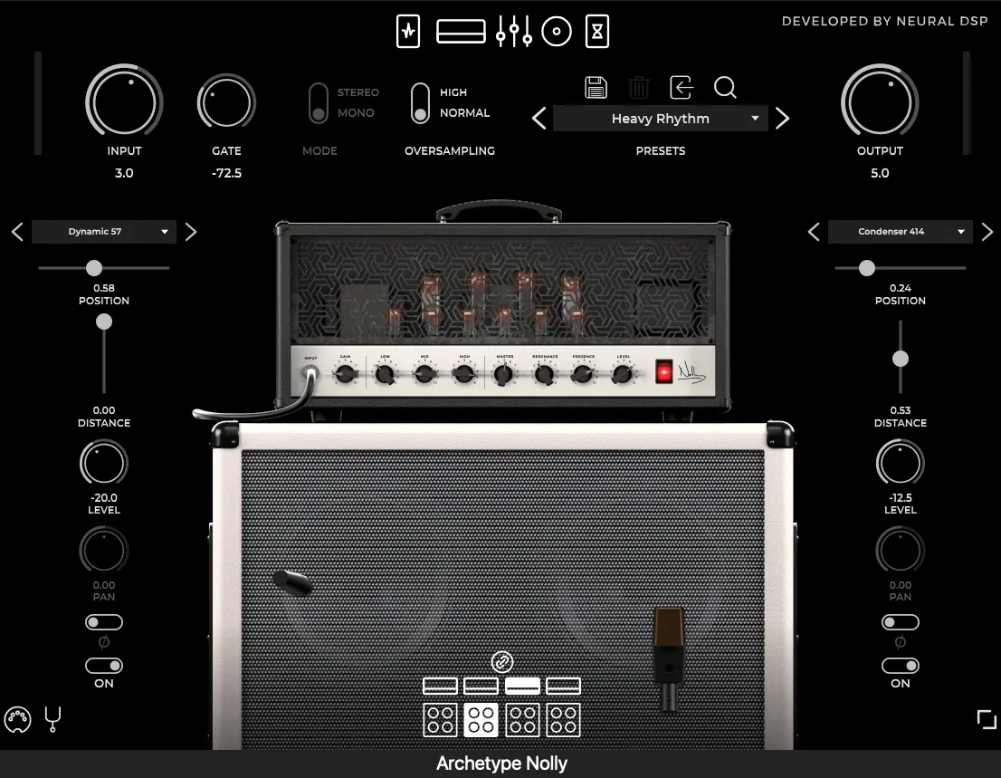

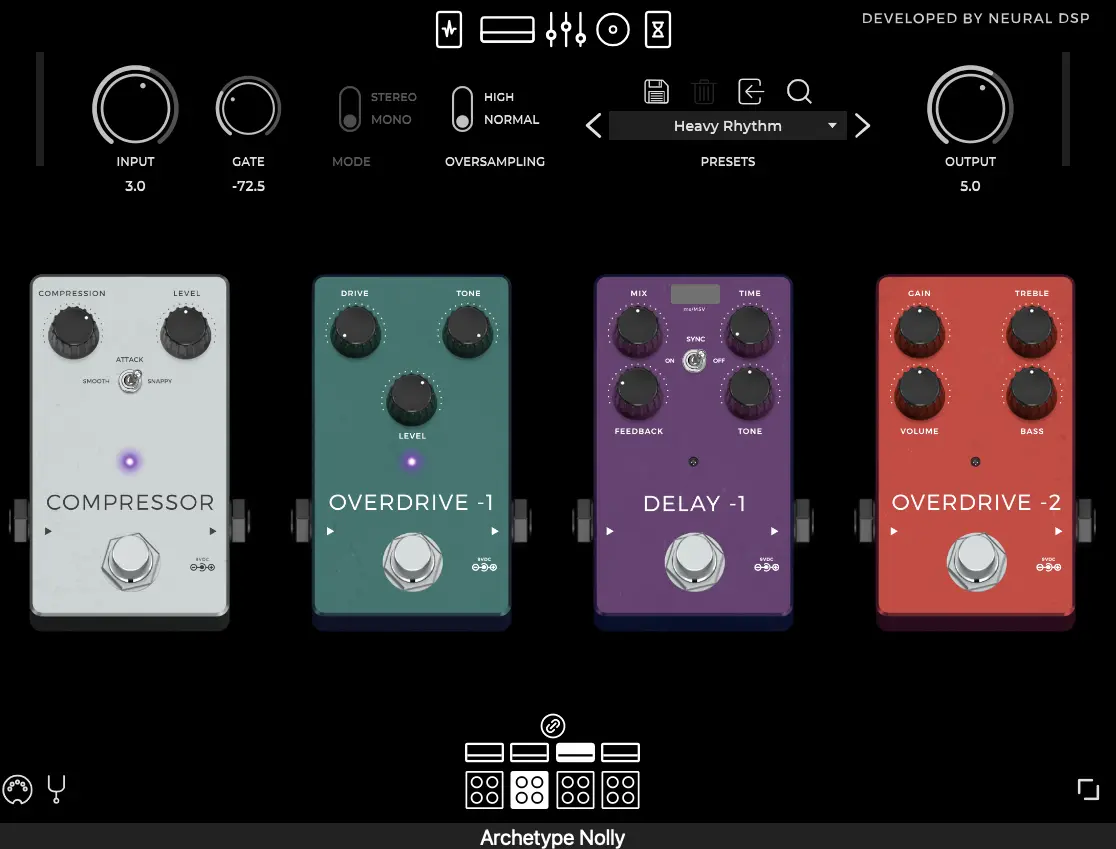

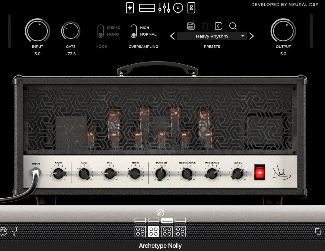

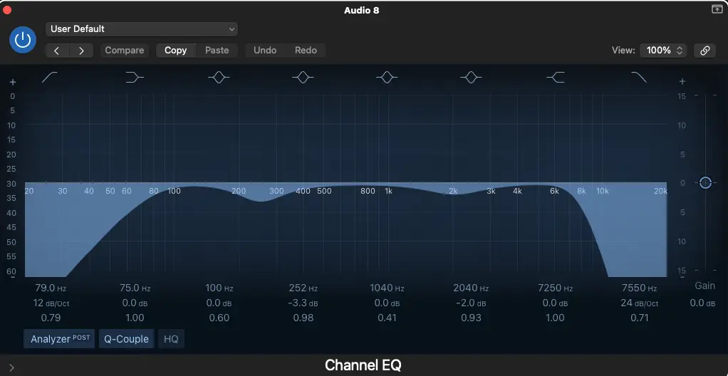

Ive attached screenshots of all my settings as well as an mp3. Ive got the input gain on my scarlet basically at zero as well. Ive played around with everything but I can never get something I like out of these plugins. But Ive listened to lots of other people play using these plugins, and it always sounds amazing when they do it. I mean, the demo for this specific archetype Nolly amp sim is one my favorite things Ive ever listened to on youtube. Whenever I play through my actual amp, my tone sounds awesome, but I just don't have any equipment to record that, so Ive opted for the digital route. It just always comes out sounding very strange to me. I don't know how to describe it. Just sort of fuzzy, compressed, low quality-ish. I don't know what Im doing wrong, but hopefully you can listen and agree/understand that something is clearly wrong.

First, if you're saying it's too compressed, turn off the compressor. Do you really need the OD pedal going into a metal amp? I hate to say it, but it sound pretty much like the Nolly videos on Youtube.
It seems that the plug-in comes with some presets. If you turn off the pedals and play with the presets, do they sound like this? Metal amps are, by their nature, spitty and harsh.

Dude - the distorted tone in your clip is not far at all from the tone this guy is getting in this youtube video.
I mean... if "archetype nolly" is what you're shooting for - you're definitely in the ballpark - to my ears anyway.

Your clip isn’t bad at all - I would try some different IRs - Back down the Presence and Treble knobs - Boost your Midrange a bit - and dip your bass a fraction - dump the EQ on your Channel - add a tiny bit reverb - and drop your gain a little - and then no listen in isolation- but with drums and bass (Keyboards?) - you might be surprised how guitars are setup for the studio.

I would start by ditching those pedals, and try to get a good sound from just the amp.
If that virtual amp does not give a good sound, try some others.
This sounds about what I'd expect, lots more highs than you would normally get on a cab recording except in the most pristine conditions (which is how these IRs are often made). POSSIBLY some intonation stuff going on, but really, with a low pass or a different impulse, I would have ZERO trouble using that tone in a modern metal mix

DI-ing gives a really crappy EQ to your guitar, put an EQ plug in on your channel before the Virtual Amp. and maybe afterwards too.
