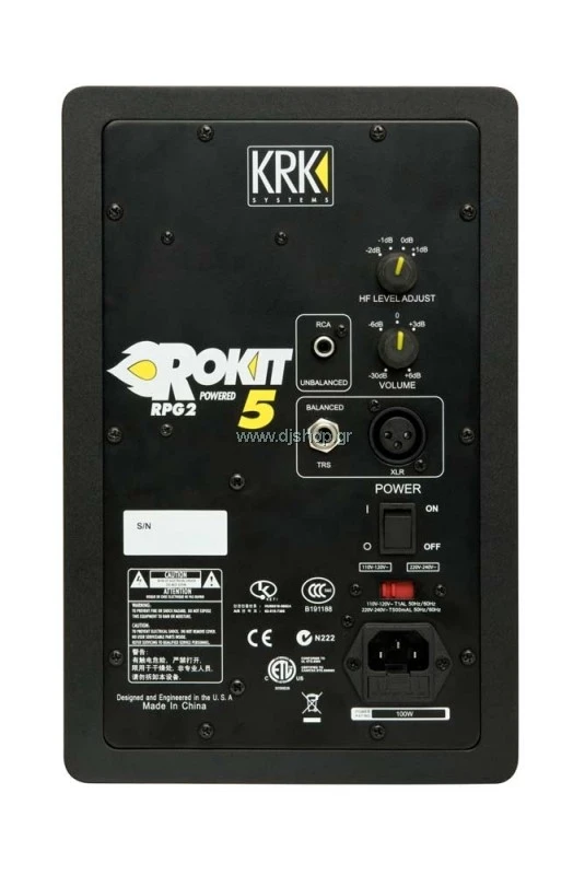

You need two RCA/Phono cables, one for the left speaker and one for the right. A lot come with L/R pairs stuck together in one cable but you only need singles. (If you have trouble finding them, nothing will be hurt if you just buy two stereo cables and only use half of each one.
Before you ask, assuming the Tascam is in a convenient location, just set the speaker volume to the 0dB position and use the monitor knob on the interface to adjust your levels (if this is too quiet, move both speakers up by the same amount--but start at 0dB.
Leave the "HF Level" knob on the speakers at 0dB unless you have a darn good reason to change it.

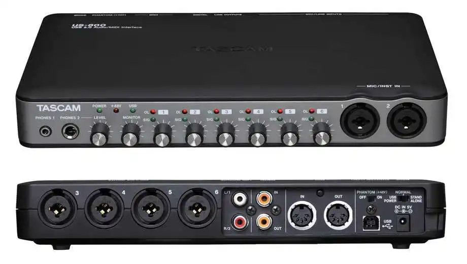

That photo you posted sucks, because the labels for the rear panel are on the top, and its the only thing that cannot be read in the photo.
Page 8 of your manual tells you exactly how to do it. Did you look at the manual yet?
