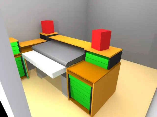

ANd how to fix the big desk (where i have the mixer and the keyboard) to make it solid ?
I would like to make the mixer sliding back and forth, and the keyboard to be inset in the desk... (if my english is not too bad to understand what i mean :D)...

I cannot figure out how to make it slide out anyway...
If i put drawer slides then the mixer would "lean out" and it weights some !...
And where to put the slides ? They should be on the sides, but i either have a piece of wood underneath the mixer that is my "drawer" sliding thing (and to do this i would have to have no real table in the middle of my desk, just the two side towers for the rack units to wich i attach the sliding panel)...
OR i could have a fuxed surface that i cut to inset my keyboard, and then my mixer slides ON TOP of it, like on rails...
Is this possible ?
This is the final layout, the one i am gonna build...
See what u think of it...
Behind the mixer there is some space for a couch or place to sit a guitarist or bass player that wants to add some lines....

Flash - the keyboard on on a sliding panel, the console is fixed. It allows you to slide the keyboard under the console when you are mixing or overdubbing guitars etc.
If you place them both central in the room then you will hear a symmetrical stereo image from the speakers when mixing which really helps in getting a good outcome.
cheers
john
It's exactly like that.. keyboard sliding and mixer fixed :D
