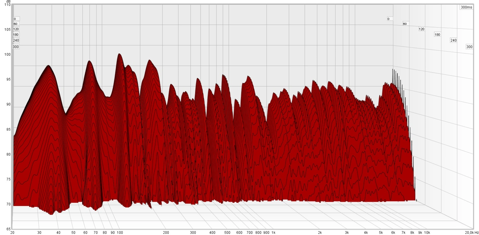

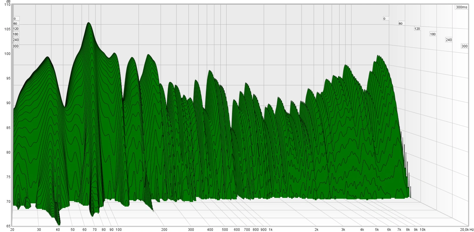

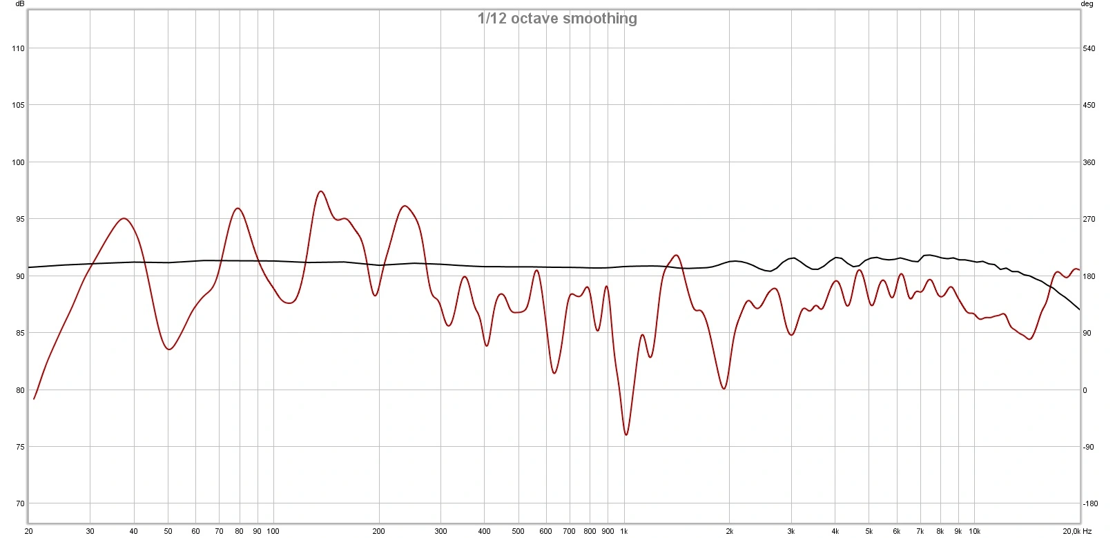

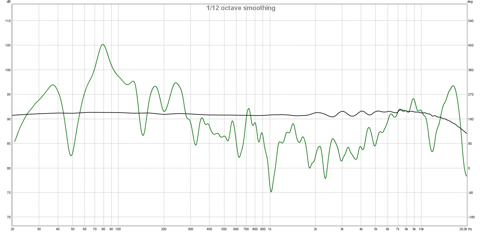

Hey guys, as you might have expected I still haven't moved on... :D
Anyways, I did some tweaking of the sub and did some new measurements I'm uploading the before (green) and after (red) pictures.
What do you think, is it an improvement or is it even worse..? green spl.webpgreen waterfall.webpred spl.webpred waterfall.webp
I don't how much better the "red" is...you've managed to reduce some things, for sure, and you've smoothed out the highs from 2k up, which I think is more critical than the sub lows you are chasing. The bigger concern are the two huge dips at 1k and 2K...which are you upper mids/highs, and is the area most associated with clarity and harshness for a lot of instruments and voices. With those big dips, you might over-correct in that 1k-2k range, which might translate to harsher upper-mids/highs...so something is wonky there.
Again...turn off the sub...work the room to get the best measurements possible without it...and then just turn on the sub and place it where you think it *sounds* best...without doing any more measurements....and just use it for listening, not for monitoring.
