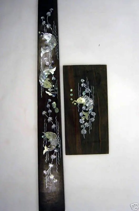

I bought a fretboard, ebony, with two chinese dragons in abolone inlay facing one another and breathing fire. I will have to install it and cut the fret slots and install the frets. Wish me luck, it will be my first time.
Much like the one pictured here, but chinese dragons.

WOW!!
Hey DW, check out Stewart Macdonald's fret placement templates. Might be worth the trouble. And if your machines will do the measuring, go with the fret calculator; you can access it from the Stew Mac website and it will calculate fret placement for a given scale length.
Where in Hades did you get that fretboard?? :eek: :cool:
One other question - if I send you the materials and specs, can you machine some fret slots in phenolic for me? :cool:

I bought the fretboard on Ebay, it is from Taiwan, cost me I think, 22 bucks.

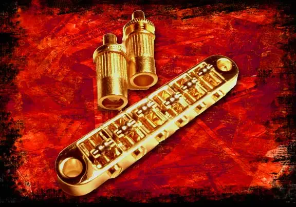

bought a gold roller bridge today, should be here in a week or so. :)
