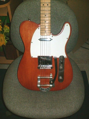

Here is a pick of my MIM Tele, I put a bigby on it, it was tough and I still need a new bridge pickup plate. The red lace sensor's are HOT! Great sustain.
It used to be a black guitar. I just had to make it my own.
I say go for it! The bigsby is so much fun, and looks so cool.
It worked out great, stays in tune but hard to restring the first couple times.

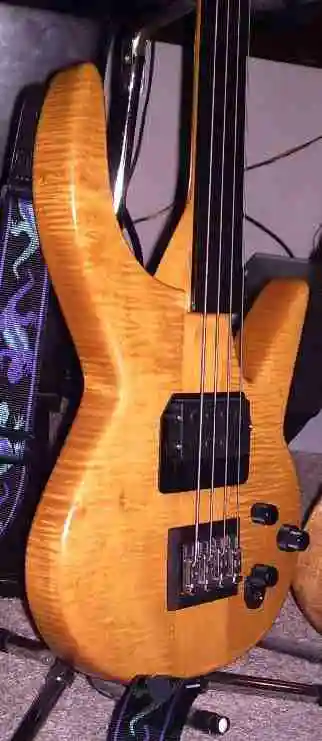

So much so that when I built my fretless I ordered a Carvin neck for it. They have outstanding quality control, wood and I love their ebony fret boards!
Here is my creation
http://www.homerecording.com/bbs/showthread.php?t=50918
And a close up of the flame...body not from Carvin though - hand cut from "Neck blank" of figured maple from Stew Mac
