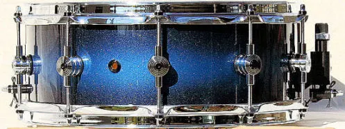

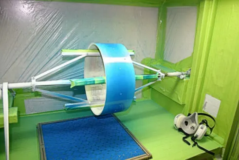

I like painting though. :D
C'mon Crankz, you're just showin' off :D .
Just seizing opportunities :D
Atterion said:
Looks good Crankz1 :cool:
Thanks!
Now if I could just find the time to wet sand and buff the rest of the shells.
With any luck, I'll be able to hit em all before I'm 40. :o
One thing I'd like to stress to anyone contemplating painting with Urethanes or any solvent based product ..... SAFETY people! Some of these chemicals (isocyanate's specially) can mess you up for life.
Trust me .... I know
Trust me .... I know ;)
