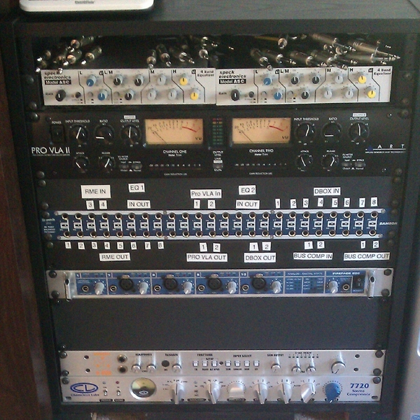

Okay so I think you'll need to get yourself a patchbay
here is how I am set up and i have some of the gear that you mention. I got all of it via eBay, Craigslist, local consignment stores etc and I was able to get this entire set up for under $3400. so keep your eyes open there is a lot of good stuff out there for reasonable prices
This will allow you a lot of flexibility without having to crawl around plugging and unplugging your gear just patch in and out of the bay. I didn't want to deal with all of the "Normal & Half normal" stuff and so got a patch bay that allows to just pass a signal straight through (Samson S patch)
I'm not going to tell you what to get, obviously I like what I have or I wouldn't have it but do not have first hand A/B comparison experience with all of your choices. But I do like an SSL vibe so the Speck EQs and 7720 bus comp were a good affordable choice for me
As far as converters go I don't know that I buy into the "Only the greatest converters are worth the round trip to use hardware in your mix" nonsense
If your converters are adequate to record tracking through and adequate to monitor through then there is no reason why you cannot send a track out and back without any serious damage to the sound. If they were really that awful you'd hear it when recording tracks
It's easy enough to test for yourself. Import a professionally done song into a track on your DAW send it out and back through your interface with nothing else in the chain (just two line outs to two line ins) and record the result to a new track, listen to the recorded track and see if it sounds any different to the original
If you want to get really anal you can even line them up and flip the phase and see how close to nulling the two tracks are. Even using a cheap a$$ m-audio converter I was able to get a single round trip of a full stereo mix to null down to less than -65 dB so any difference was basically inaudible
This gives me a few scenarios
1) tracking:
Mic > External Pre > VLA Compressor (via patchbay) > EQ (Via patchbay) > Interface line in (Via patchbay)
2) As an insert on a recorded track during a mix:
route track to output on interface. Line out (via patchbay) > EQ or compressor or both (via patchbay) > Line in on interface (Via patchbay)
3) Full mix for outboard summing and FX:
mix to 8 outputs in the DAW
2 mono outs (Bass & Vox for example) > 2 Channels VLA comp> 2 channels of EQ > 2 inputs on D Box
3 stereo stems 6 outs) > 6 inputs on DBox
2 outs on D Box > Chameleon Labs 7720 > 2 inputs on interface to a new stereo track in DAW
2 SPDIF channels sent interface to D Box to monitor the returned stereo mix post conversion in the DAW
With the patch set up you have a ton of flexibility in terms of ease of integration with your hardware and interface during tracking and mixing and mixdown
this will also keep you warm in the winter and look really cool when you mix with the lights out :)
