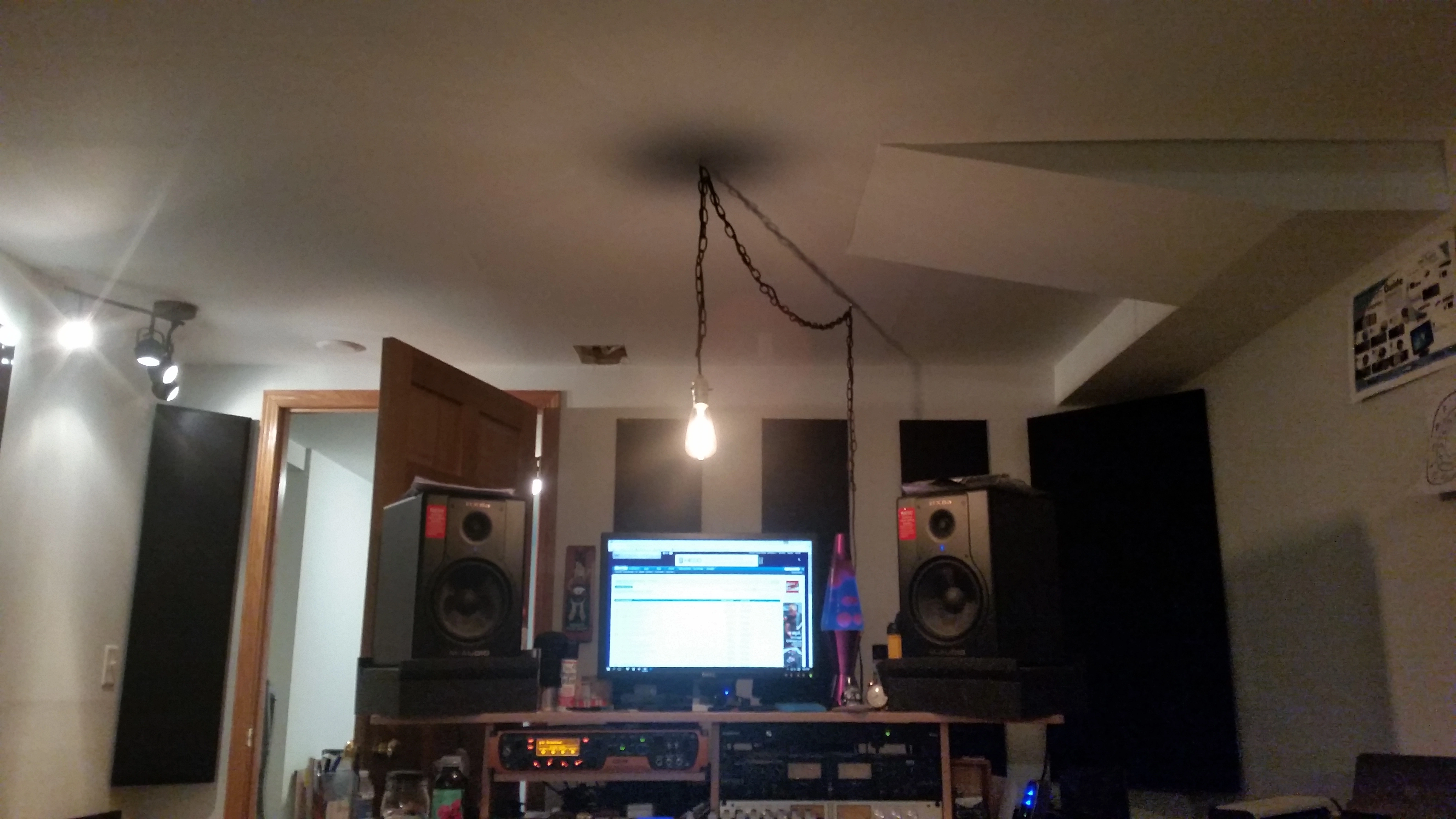

From everything I've read I think you'll want to double up that OC703 to 2" thick. 1" x 2" pine is cheap for frame making, the 2" thick rockwool will be a little thicker, but wrap with cloth tight, and it will 'sag' 1/2" or so . 4 eyebolts and hooks for each one - total cost not including the rockwool and whatever cloth you use should about be less than $20. I used bargain basement cotton sheets for the cloth - 1 full size flat sheet is more than enough to do two 2x4 panels.
I found my studs in the ceiling to see my placement options, ran screw/hooks in. Hung the cloth wrapped fiber boards in lite chain loops.
I can just lift them up off the chain, change the angle -flat?, angled to put their edges lower, make a 'tee pee whatever, or change their overall height adjusting the chain itself etc.

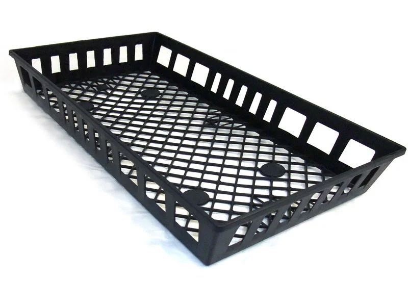

If you don't want to make frames, one tip I saw in a studio design book was to use planter trays from a garden centre and put the 703 into them, you can then wrap it if you want.
Alan.

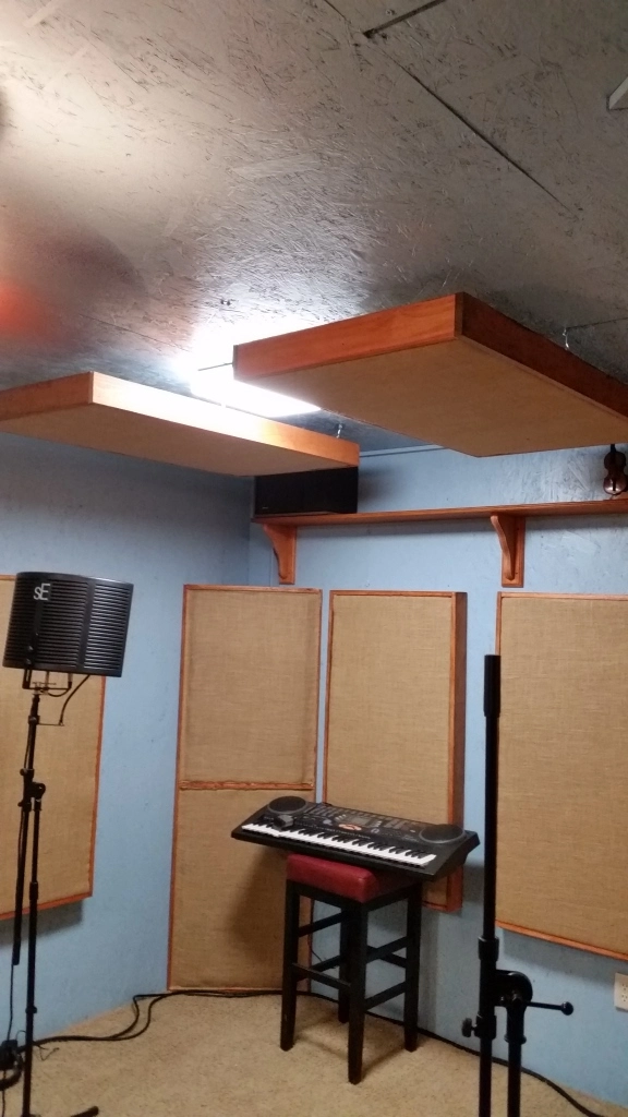

I used 1x4s for the frames, I found them for 2 bucks each, I got 2 frames out of 3 boards. I used hooks and eyes to hang them. I used Burlap to wrap the panel in. I think they came out nice. :D

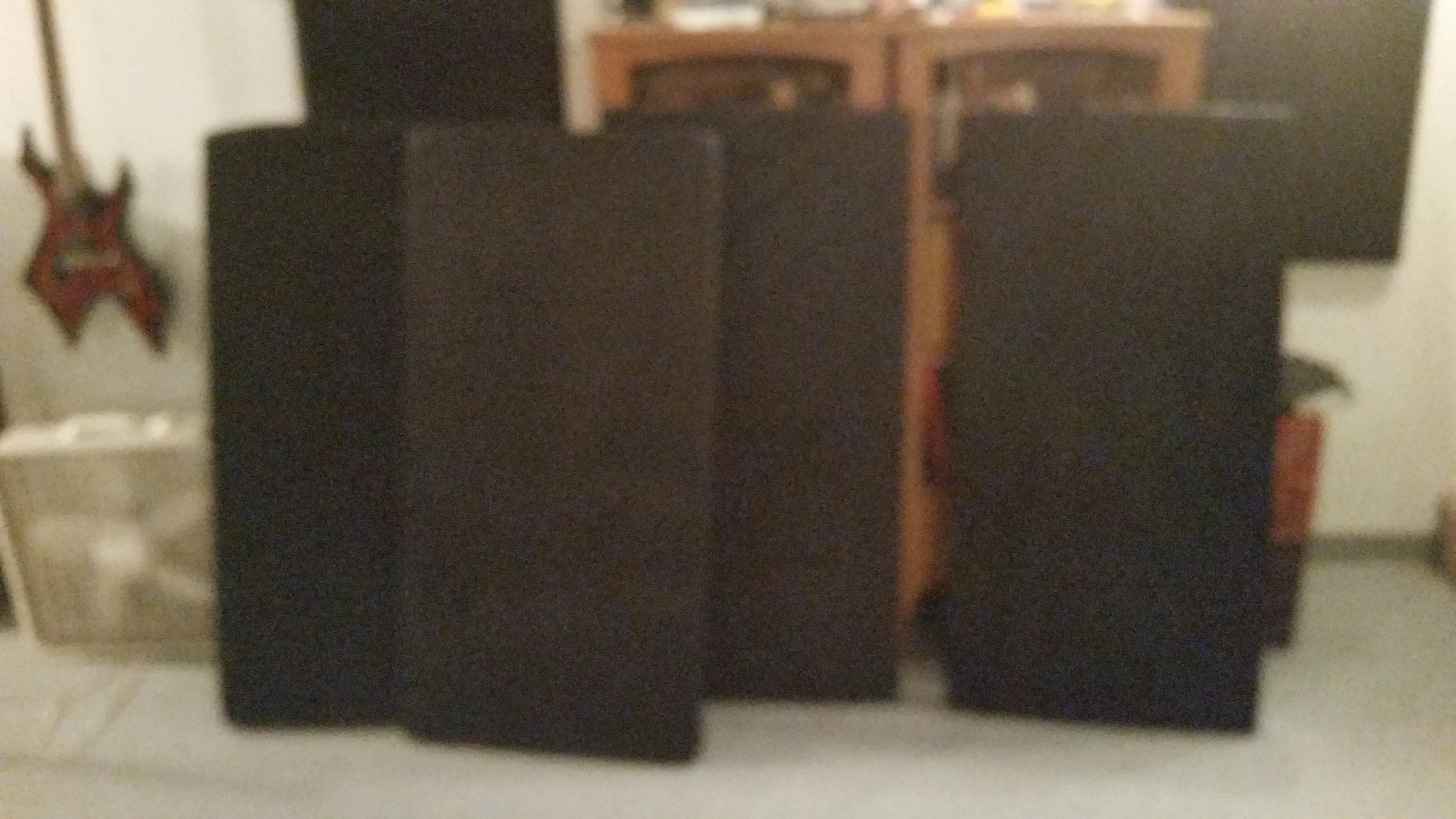

My cloud project is progressing. I have 4 panels wrapped and ready to hang. I'm going to use scrap 2x4's and screw right through the panels using the largest washers I can find to keep the panels from falling on me. I glued 4 of the 1" panels together to make 2 -2" panels :thumbs up:
So tomorrow I will go to the hardware store and get black screws and black plastic washers. It should work.20160211_180550.webp20160211_180428.webp

I've got 4 panels hung.
I've come to the conclusion that the stacking of 2 - 1" panels works, but is not ideal. The 2" panels are much better.
I still want to hang 4 more 2" panels. It'll have to wait a while.
