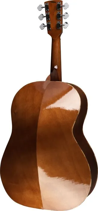

The challenge is that the back of the instrument is radically arched and the heelcap is at a radical angle in relation to the surface of the neck. Creating a caul to properly clamp this joint is not going to be simple task. The caul will have to spread the clamping load across the back of the instrument and hold in place under pressure. It will probably have to involve a frame that anchors to the other end of the instrument to keep things from slipping out of alignment during clamping and a pad that matches the contour of the back. I can't think of an easy way to describe it in a thread.

I see what you're saying. Like a frame that includes the heel-clamping caul on one end and wraps around the endpin area on the other, to stabilize the position of the caul and keep it from sliding down towards the neck when you put the clamping pressure on. I wonder if you could do this with a strap (or two), instead of having to build a frame. The only thing I'd worry about there is the strap pressure caving in that back; I don't know how heavily these things are braced.

If you think the job through, a pair of straps could work very well. Straps will spread the load such that there should be no risk to the back. The challenge will be to compensate for the fact that the straps will stretch as the load is increased. Strap or no strap a clamping caul will have to be made that fits the back and heel on one side and is parrallel to the face of the instrument on the other.

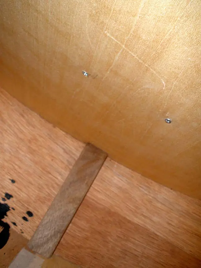

This shows how they screwed the bridge on from below. So one more screw in this instrument won't hurt.

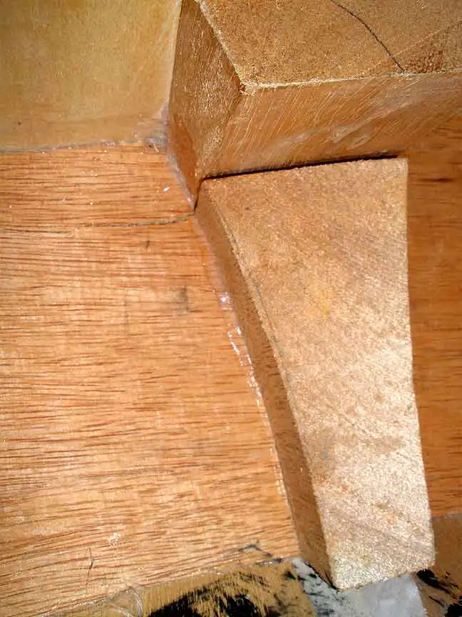

Here's the heel from the inside, showing that the heel and neck extension are two different pieces of wood, and don't really look like they were ever glued together. You can see the crack in the side extending out to the left of the "joint."

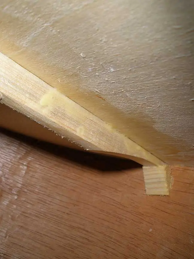

The loose brace. Nothing holding the top and sides together except, apparently, glue.

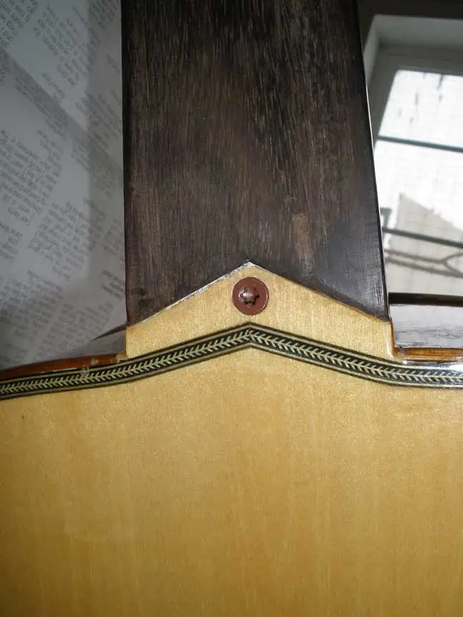

So here's the 2 1/2" deck screw through the neck and into the heel, after liberally applying Elmer's white glue to the crack. The screw pulled it together pretty well.

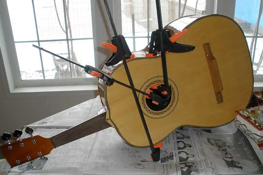

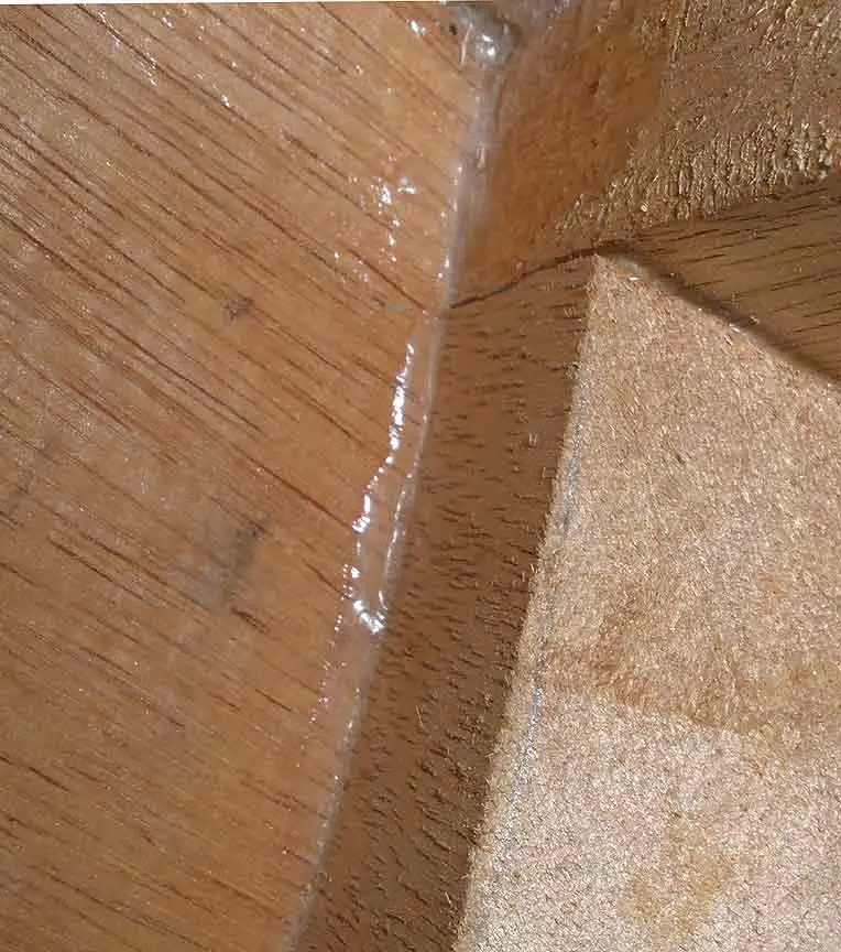

The top clamped onto the side where it split off, again with Elmer's. The loose brace was also clamped and glued.

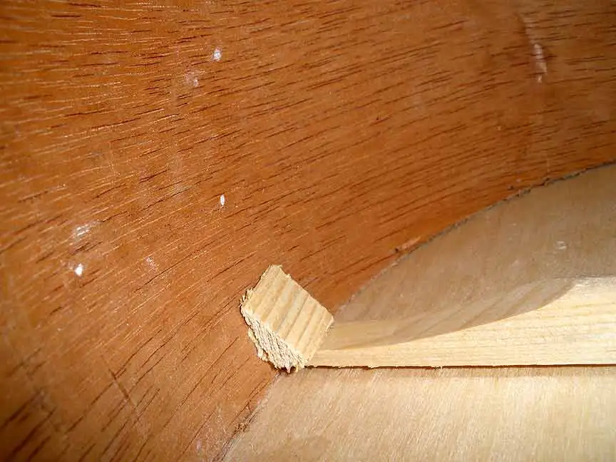

After gluing, here's the inside at the heel. Didn't pull the neck piece all the way down - I should have put another screw in here through the top.

The brace is not tight enough either, but it will suffice.

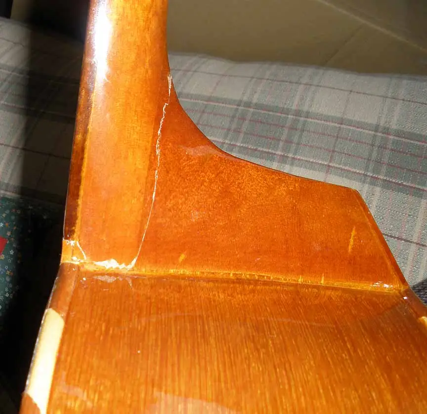

The heel from one side.
