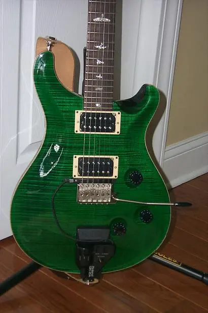

As referecne, here is what the PRS Custom 24 looks like with the GK-2A pickup.
Ed

cool, thats what I was thinking but they were talking about drilling so...
