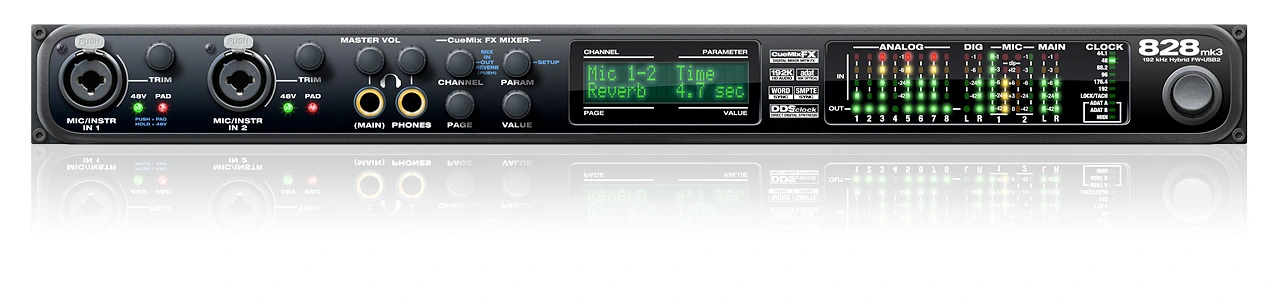

hi everyone, i'm just started to get into audio recording in logic using logics complete rigs and i also have guitar rig 4. i first create an audio track then say i choose to use logic's complete rig preset called neu metal. i am using a motu 828mk3 firewire hybrid as my interface. right off the bat the signal is too hot. i was told by some people to shoot for -12. on my mic instrument input i have the trim all the way down and the signal is still no where near -12. so i open up the amp designer plug in on the channel strip and lower the output. the reason i do this is because i was told that to get your full pick up sound on your guitar you always want the volume on the guitar all the way up so i chose to lower the output on the amp plug in. i finally get my -12 level and hers where my problem starts. once i arm the track to record ( click the r button with the in put monitoring button lit through this whole process) my -12 level goes away and the level jumps up. can some one please help me with this because first i would like to start recording more guitar driven music and second i am on the lesson in the apple pro training logic 9 book where it explains about recording audio and this problem i am having is not only confusing me but also holding me up on progressing any farther in the logic pro training book. my interface is a motu firewire hybrid and the trim knob on each of the two mic/instrument inputs start (meaning as low as i can go) at +0 all the way up to +53 in 1 db increments. can anybody please help me with this problem?
On the Motu....does it automatically sense Mic VS Intstrument, or do you have to manually choose on the panel?
If something set for Mic level...but you're plugging/playing instrument level...it will be too hot.
there is no switch or any thing to choose from on the 828mk3 hybrid 828mk3-large-front.webp
I beleive that on that unit, the two Trim pots can be pushed in to get a 20dB pad since they are preamps. When stick an instrument level signal into them, you would want to pad them.
the manual says " the mic input (xlr jack) is equipped with a -20 db pad so "hot" signals are best connected by an xlr cable so that you can use the pad. since the pad is not available on the trs jack, the hot signals connected via the trs jack will probably over drive the input." some one on another forum told me that you never want to use a pad on a guitar. also i got in touch with motu earlier and there solution was to lower the gutars volume to get recording level.
The front inputs on that unit are mic-XLR, or instrument jack so stick to the jack input on the front.
Hmm, unless you're using an active instrument your signal shouldn't be too hot.

i agree. i tried the cue mix experiment and it still clipped. when you mentioned about an active instrument steenamaroo, i don't think these pickups are active. i even tried another guitar and the same clipping happened. i don't know what to do any more. it's like i paid 7 hundred bucks so could never plug a guitar in my interface and use amp sim software. so upset..... so frustrated.

Now, one thing that's just come to mind is, each analog input has settings for -10/+4, and an optional boost button.
Google image tells a different story so maybe it's different for each OS or whatever.
I see a 'focus' option per input that I don't actually have.
Either way, take a look at these in cuemix and see what's on and what's not for your first two inputs.
Cuemix will change the settings stored in your hardware. These settings affect your inputs even when cuemix is shut.
