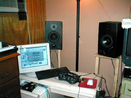

Got my Yorkville's YSM1P a few days ago...
  • Thread starter Thread starter frank_1
frank_1
frank_1
I'm concerned with the positioning with them... Is this gonna cause some problemos?

I think so. First it's best to keep your monitors off the walls because it reinforces bass waves. And it's doubly bad when a speaker is in the corner like your left speaker. Unless you have a pretty big room it's hard to keep the monitors off a wall but at the very least you could move the setup to the middle of a wall so the left and right are more balanced with each other.
