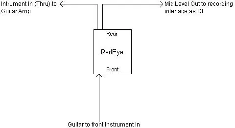

Sweet. It'll work for all that I need it for!
See my crappy picture I sent to Jonathan at Little Labs for illustration.

Call me crazy, but will the redeye actually let you split to two amps? It's great for re-amping, sure, but you said you wanted a DI and a split too, right?
