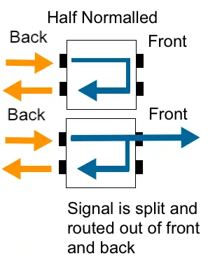

....For the record. The diagram I posted is for HALF NORMALLED. I.E. The top jack is always hot but plugging into the lower input breaks the thru' signal allowing an external input signal.

Well ... it doesn't "break" the thru signal. It splits the signal. Is that what you meant?
Err? Plugging into the bottom jack breaks the 'thru' signal from the top jack. Pretty sure I have that right?
As I said, the contacts are shown external to the jacks for clarity when they are of course part of the jack body.

This is the way I've always understood half normal to work. Is this not what you mean?
Edit: Oh crap ... you said plugging into the bottom jack. My mistake! Sorry about that. :)

Edit: I just re-read this and realized it could have come off a little as "you did this wrong!" I didn't mean to sound like that. It will certainly work the way you have it. It's just that you will have to use patch cables every time. That's not a big deal, of course.
And if you set up patch cables from your effects send to your Nanoverb in and then from your Nanoverb out to your effect return---and then just leave them there---you're essentially accomplishing the same thing, albeit with a bit more clutter.
ahhhhhh...... I got it!!! I thought I understood this, but I guess I didn't entirely......now I do!! ....now the challenge is to remember it :)
