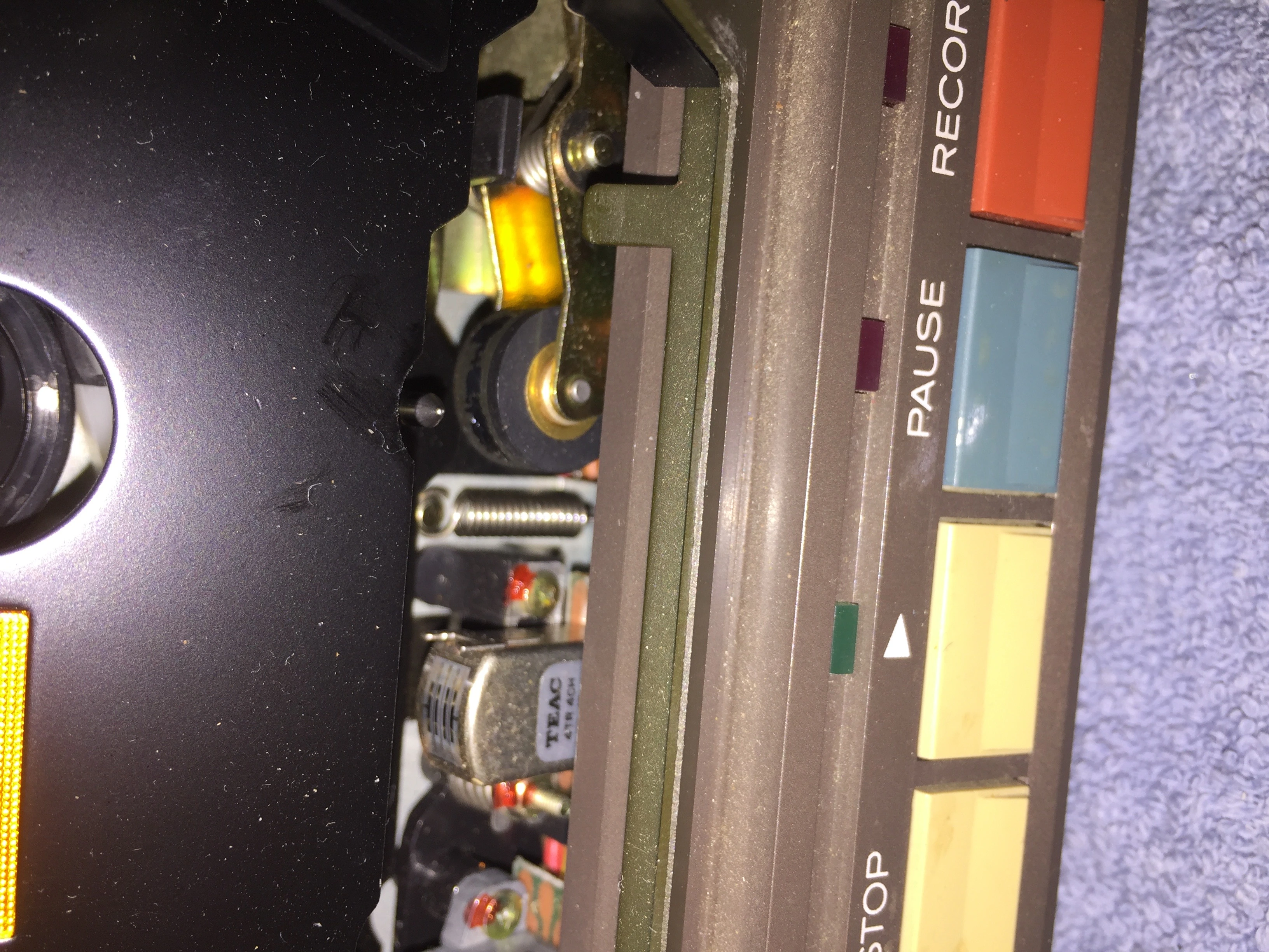

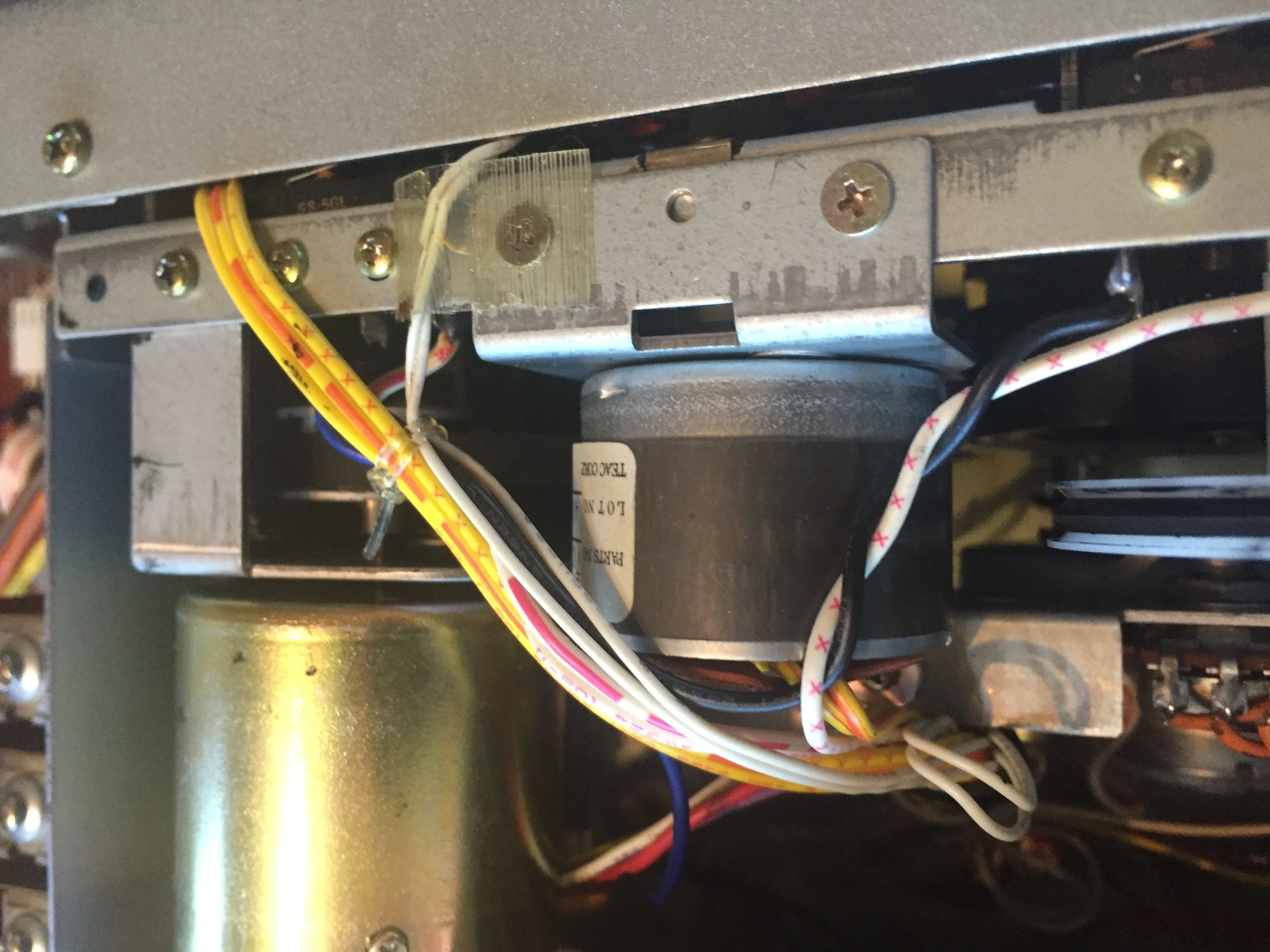

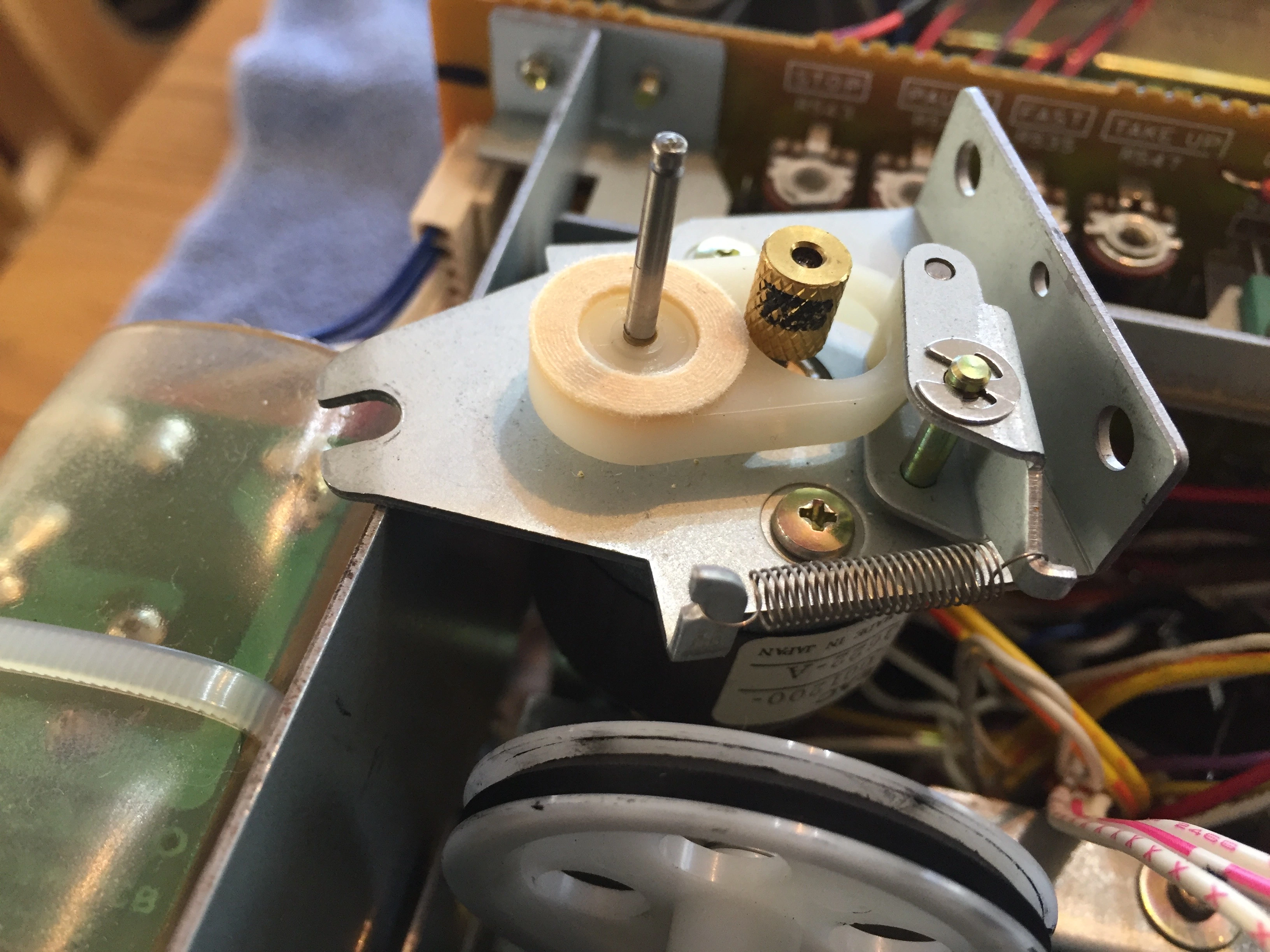

Alright, I took a little bit apart again this morning and answered my own questions.
1. I think the cam is fine and
2. Yes there are idler tires.
It looks like the motor can be removed with these two screws and the idler tires will come free.... pretty easy huh???? Don't worry, I'm not disillusioned..... nothing is easy in Bradland.....

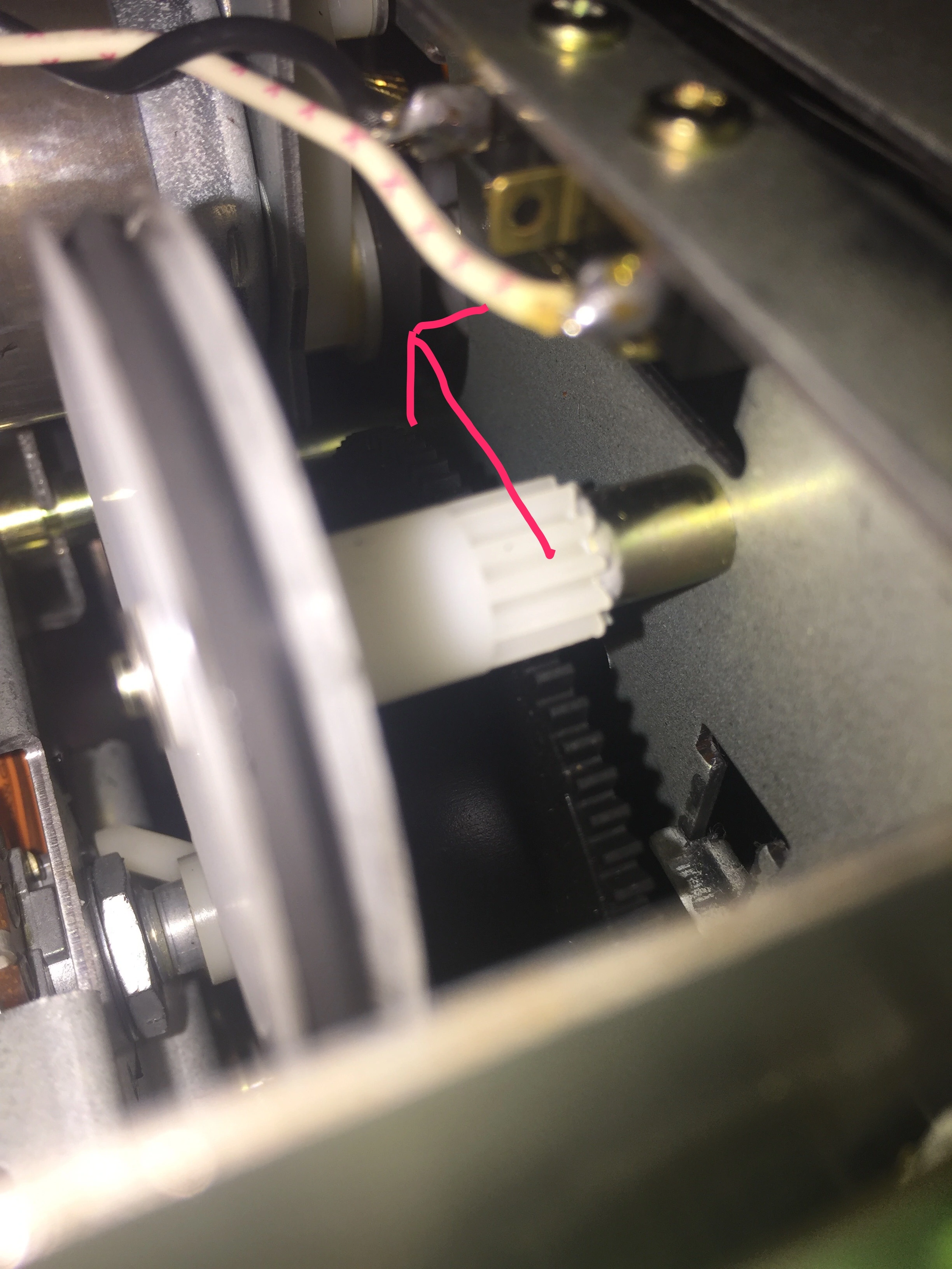

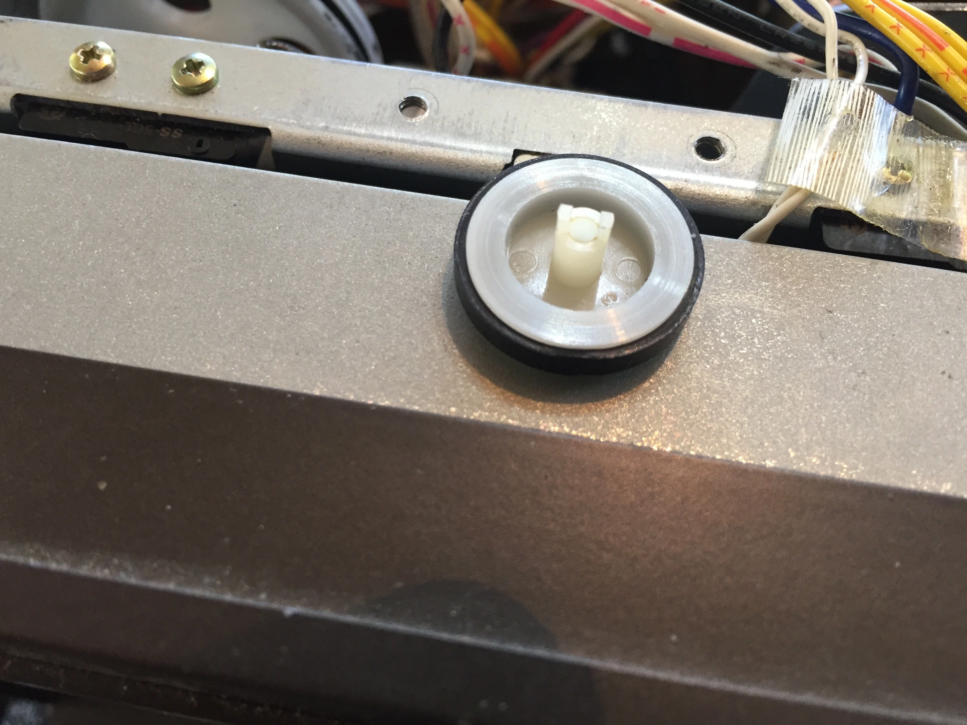

ahhhhh...... I found the problem....Well.....one of em.......
The wheel was just stuck to the knurled pulley.... well, I the wheels are the same size as the 244 (not the same thing though). I had a couple of washers sent from Dynamic Technology for the 244, but were way too big. I used an old idler wheel, chucked it up in the drill with the oversized washer, and put em on a piece of sandpaper. Put it back together, and the transport worked well.....well almost......

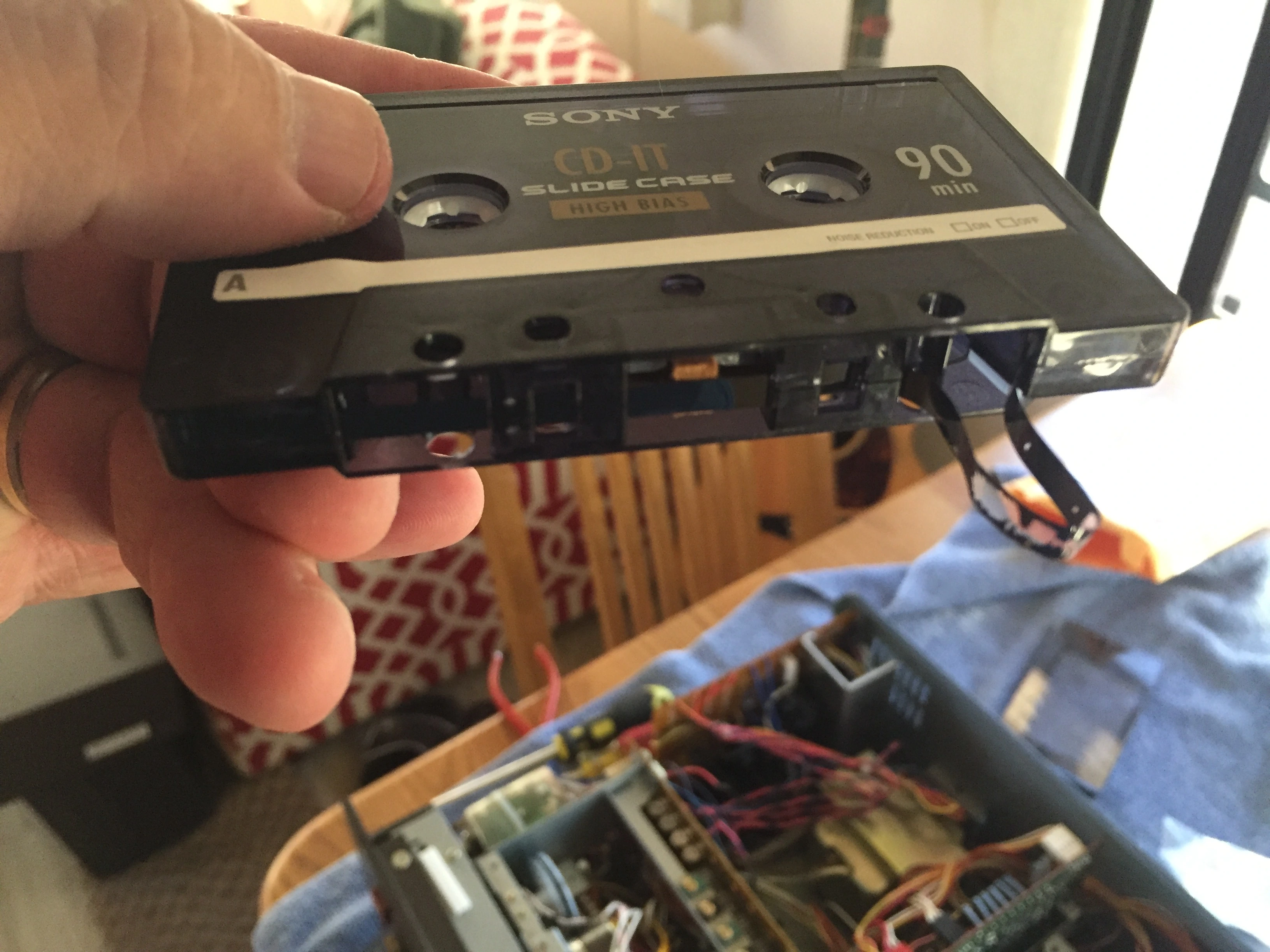

When I took the tape out, this is what I found....

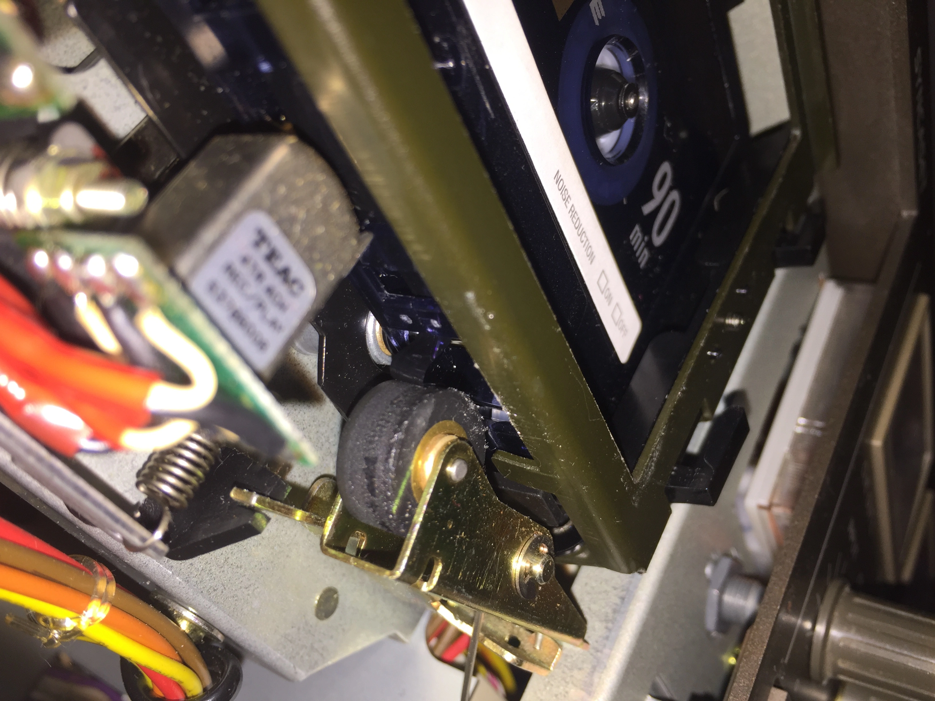

The pinch roller has some tape on it.....
Soooooo...... I'm thinking a soft pinch roller right? Well, the pinch roller is hard as a rock and as round as Orsen Well's chef!!! The tape is relatively new from and I recorded on it recently.... Right now I'm thinking (maybe just hoping.....), that the pinch roller had some sticky tape on it.
I hear a bunch of different things, what do y'all recommend to clean a pinch roller ??
More diagnosis this morning and even though it feels hard, I do believe I have a sticky roller problem!!
I tried an Emory board on it.... I figured what did I have to lose...... The bad news is I emailed Terry and he's going on vacation. It'll be a month until the roller can get done.... so I'm going to shelve the project for a while, and hopefully not take apart the 244 again to get to it's pinch roller...... it's awful tempting......

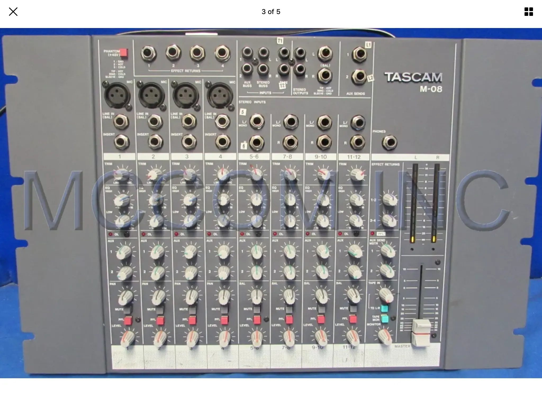

You all will have to excuse my ignorance on this one. I've only used a Portastudio and am looking at how to hook up a mixing board to the tape player. Here's what I have:
Right now, I'm using a Portastudio 424 as the track tape player (eventually, I hope it's the 234).
I think I understand that I will bring the line outs from the tape player into channels 5-8 so I can still use the eq. Recording to the tape player, is where I'm having the problems.
The board only the stereo outputs and the aux sends. Would it be best to come out of these as line ins to the tape player?

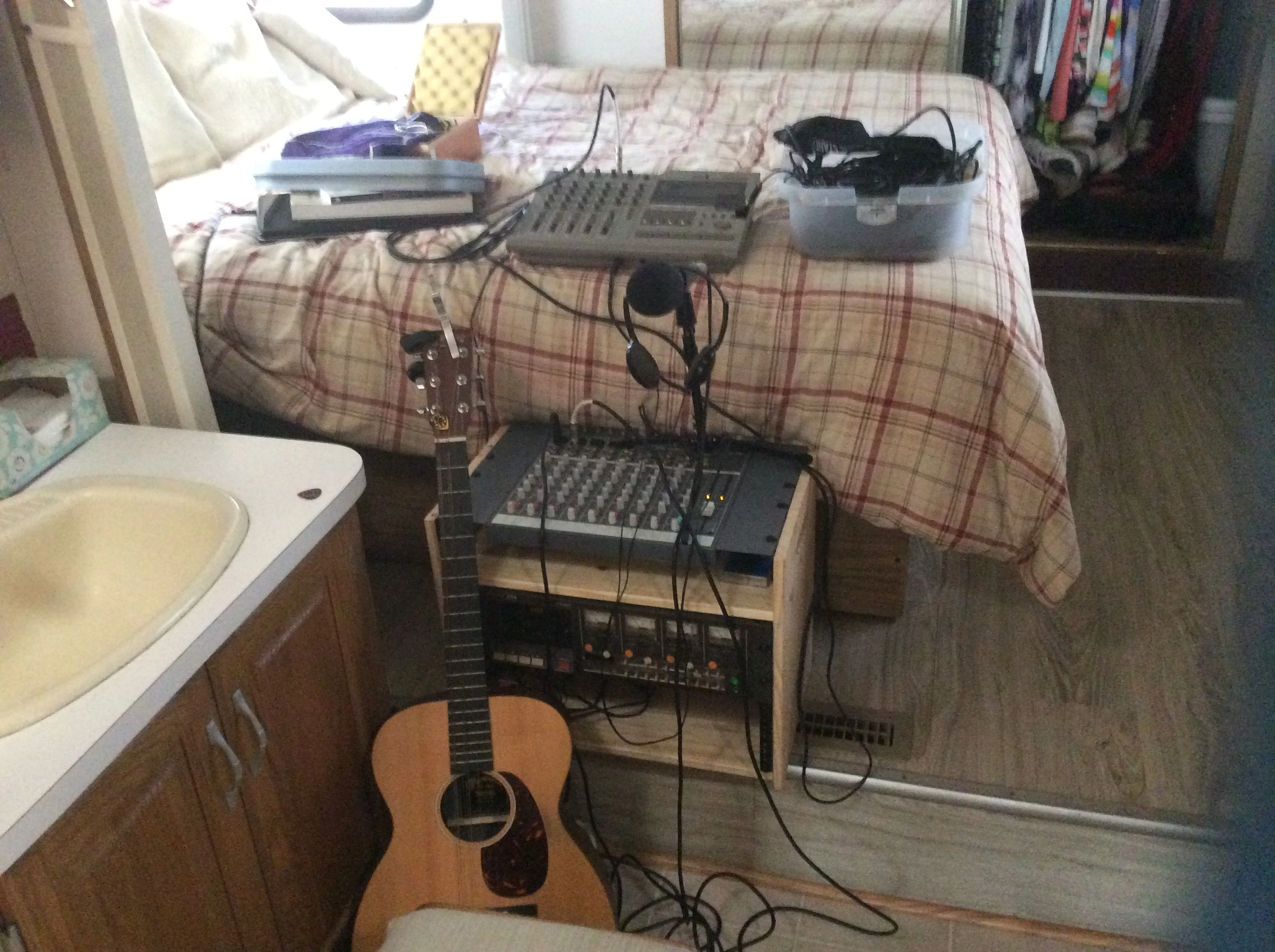

Here's the new version of the studio as we speak....
The big advantages.....
1. I stay away from my wife's clothes closet
2. I can mix two instruments when I'm doing these 4-track collaborations. Before, I'd have to space a mic between my guitar and my voice since I could only use one track. Now I can get dedicate an input to each and get the levels right before.
3. Same with effects. I couldn't separate the voice from the instrument.... if I added delay, I'd have to do it for both.
4. I can put a cutting board over the sink for the mic stand, (I'll probably do this to free up room on the mixer)

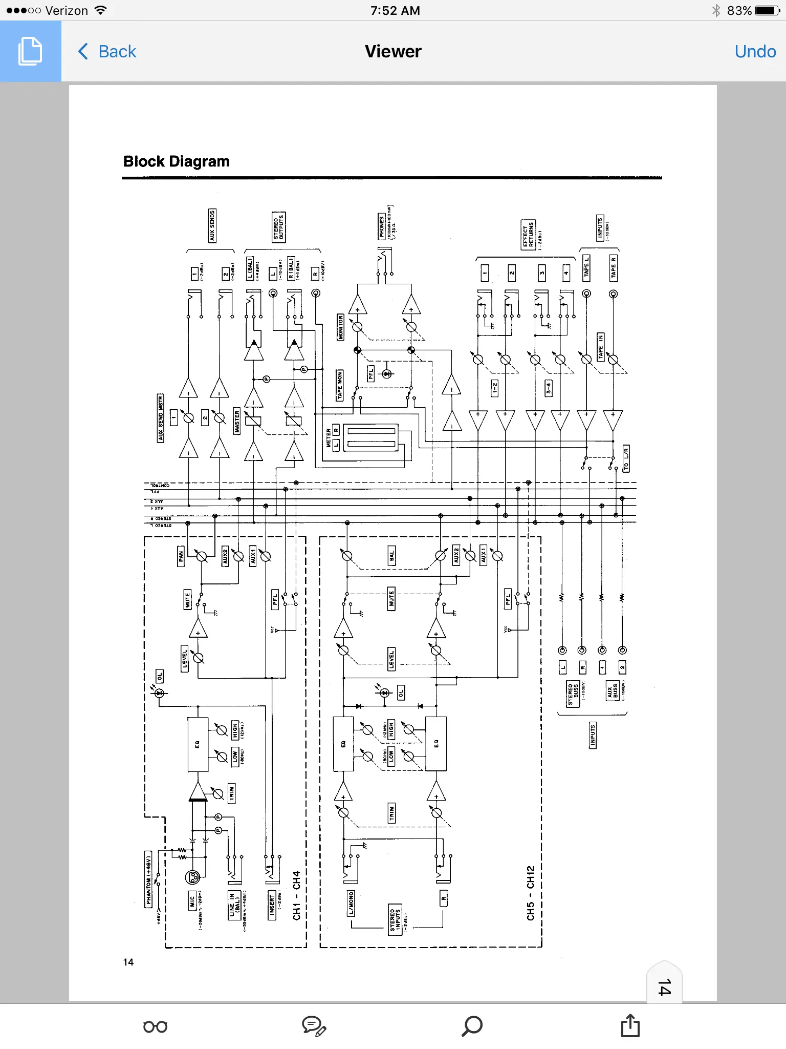

I was just kind of trying to get a feel of what I need to do when the Tascam 234 gets rolling. The Mixing board only has a right and left stereo out. It also has two aux sends (which in my mind would be the other two tracks sent to the tape player). If I do this, I won't have the effects chain available right?
Also, I was playing with some sub mixing last night. Very useful when you only have one track of the tape to record on (like when I do those 4-track collaborations).
Ohhh ok ... gotcha. I thought you were talking about using the mixer with the 424. I didn't realize you talking about the 234.
Hmmm ... that's a good question, because there aren't any program busses on that mixer ... it just has the main buss plus the auxiliary busses. I'm trying to figure out how you won't get a feedback loop.
You could do this:
When tracking:
1. Run the track outs of the 234 (tracks 1-4) into the 5/6 and 7/8 inputs on the mixer for playback. This will give you basic monitoring control while tracking
2. Plug your instrument or mic into channel 1, 2, 3, or 4.
3. For recording on tracks 1 and 2: Run from Aux send 1 and 2 to the track 1 and 2 inputs on the 234, respectively.
4. For recording on tracks 3 and 4: Repatch and run from Aux send 1 and 2 to the track 3 and 4 inputs on the 234, respectively.
When mixing down:
1. Run the track outputs of the 234 into Channels 1-4 on the mixer.
2. Run Aux send 1 to the input of your FX processor.
3. Run the stereo outputs of your FX processor to inputs 5/6 of your mixer. This will allow you to EQ the effect.
4. If you have a second FX processor, you can do the same with Aux send 2 and inputs 7/8.
If you want to use your compressor while tracking, use the insert jack on the mixer channel (1, 2, 3, or 4) you're using to record. You'll need an insert cable like this one:
Hosa Insert Cable (Stereo 1/4" TRS to Two Mono 1/4" TS), 3.28 Foot, 1 Meter, STP201
(Make sure it's long enough to reach where your compressor will be)
If you want to compress one instrument during mix down, you can do the same thing on the mixer channel 1-4 (which would be track playback at that point).
In order to compress a group of instruments (or the whole mix), you'd need a second compressor (or one stereo compressor), otherwise the end result would be mono. However, you can always compress while you track (as long as you're recording one track at a time).
But, you know ... those DBX 163x compressors are so affordable, and that one HALF rack model is going to be so lonely sitting next to that empty half rack space.
<insert wicked laugh> :)
Anyway, someone else may have a better way to hook it up, but that's what's coming to me off the top of my head.
