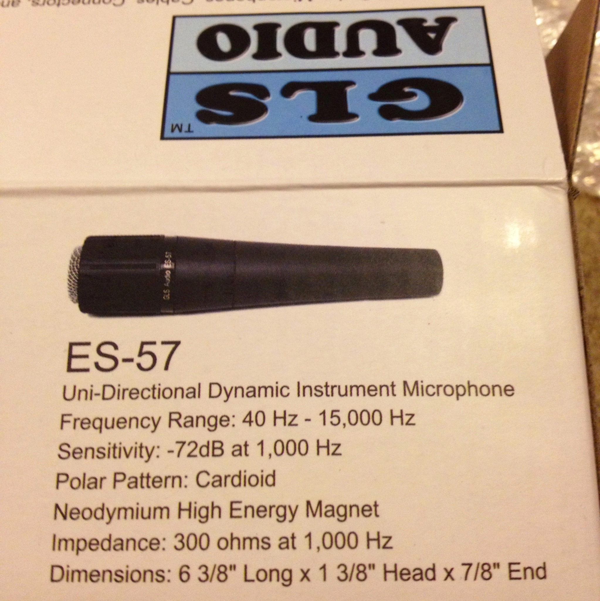

Anyone know if the GLS Audio ES-57 has a transformer like the SM57? And are they any frequency graphs to be found anywhere for the ES-57?

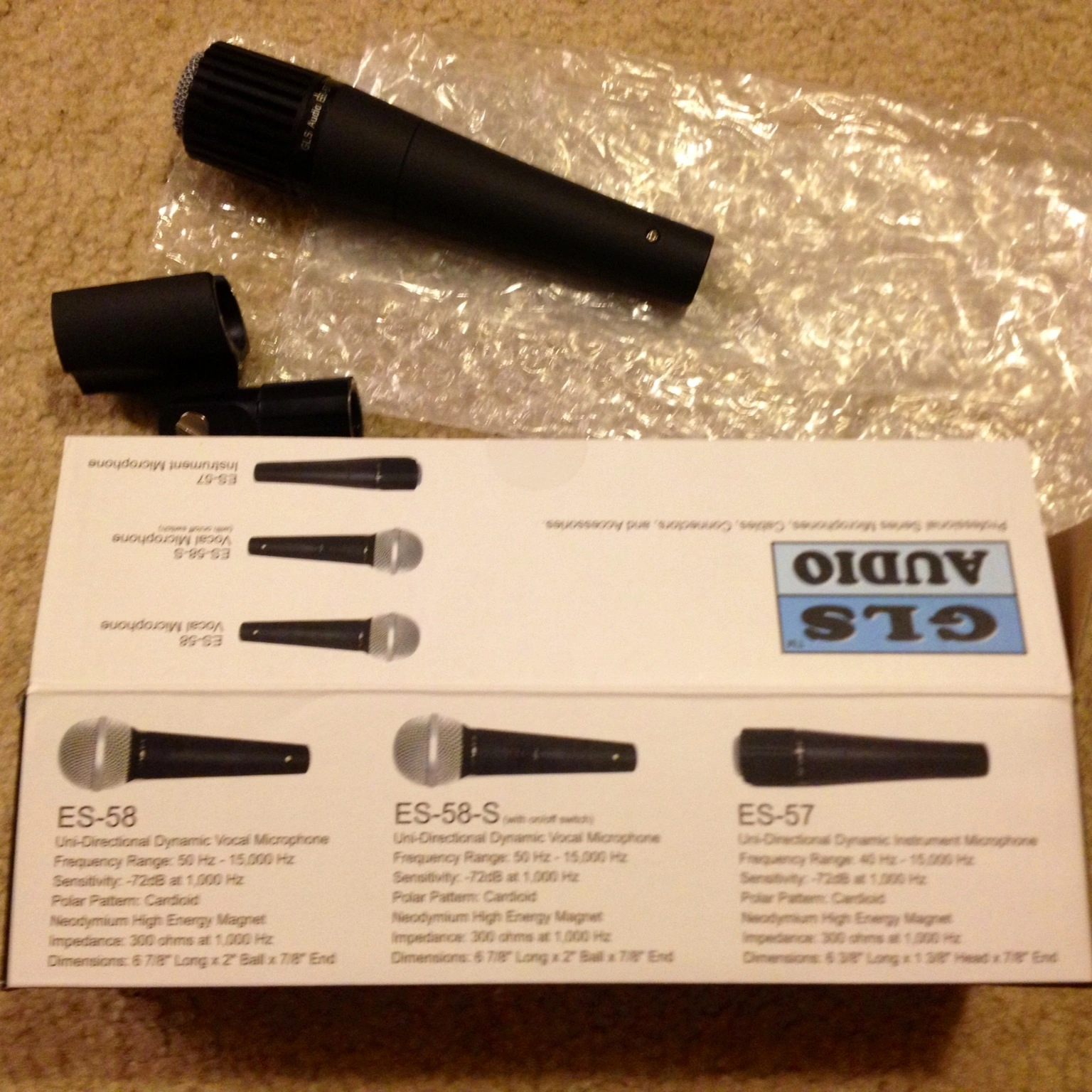

No idea on graphs, here's all that was packaged with the mic:
Can't seem to unscrew it even right now by hand to have a look inside...
Interesting if it has a neodymium magnet then it should be more comparable to a beta 57 then right? I mean tech wise.
At the risk of pissing more people off by bumping this thread I think I'm going to shoot this out against my beta57 soon.
Usually neodymium magnet mics have a hot output. I'm not sure how the -72db@1000hz of the ES-57 compares to the SM57's output of -56dbv/PA. Did the ES-57 seem to need more gain than the SM57? An SM7b has a rated sensitivity of -59dbv/PA and needs a butt load of gain, so -72db is a strange number.
Nope. They were recorded with identical settings at the exact same time (this is why the D/I argument on this thread is moot, unless we open the spacing can of worms back up, but whatever).
The test is confusing because I chopped the files up and offset the recording with the recorded part proceeding repeating the part before it. HUH??? Confusing. In other words, if you listen to the video, I am playing all at once with Mic A into input 1 and Mic B into input 2 recording at identical gain settings on the preamp and outputting to the mixdown at identical 0db faders. So what you are hearing gain/level-wise is an even playing field. Identical source sound + identical preamp + identical faders = GLS mic hotter than Shure mic.
