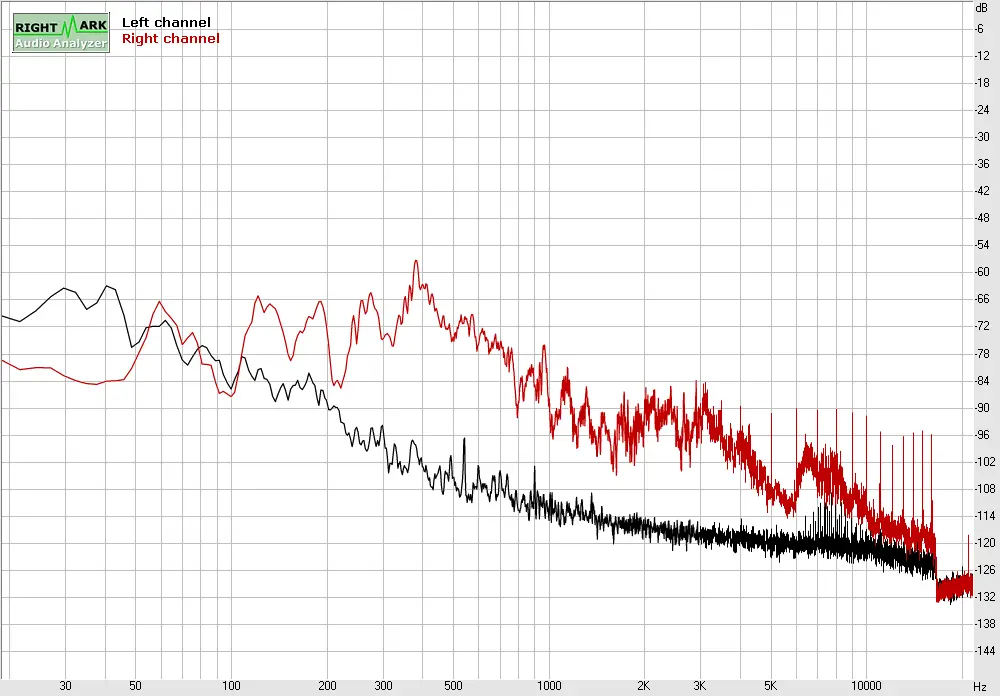

No sign of a noise on the spectrum of that intro?

Ok. Well I recorded that clip. Chopped out the intro and ran it thru Right Mark spectrum analyser (free btw)
Just looks like a normal ambient noise spec' to me.
So your saying it's just amplifying a noise heard in my studio?
