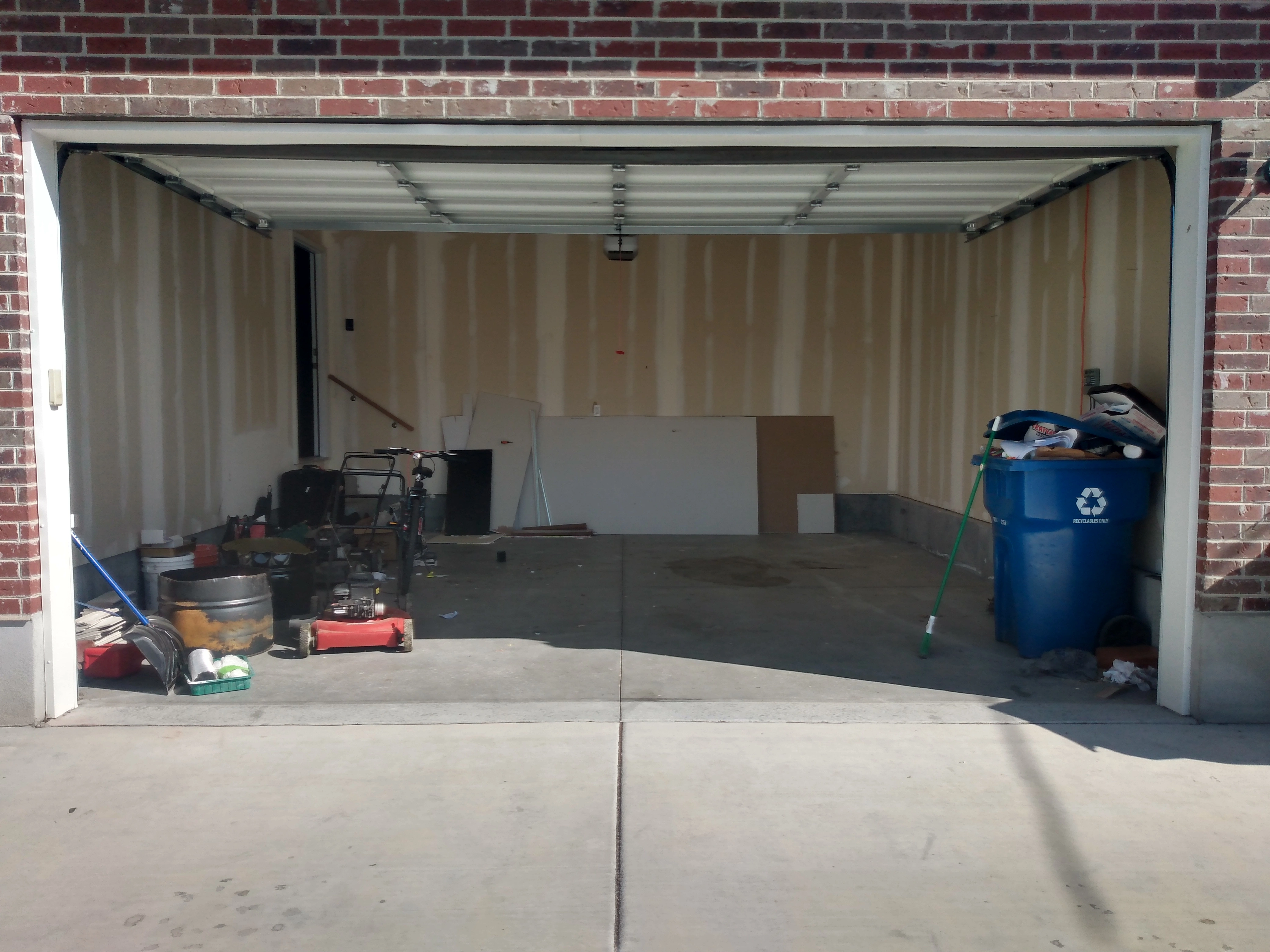

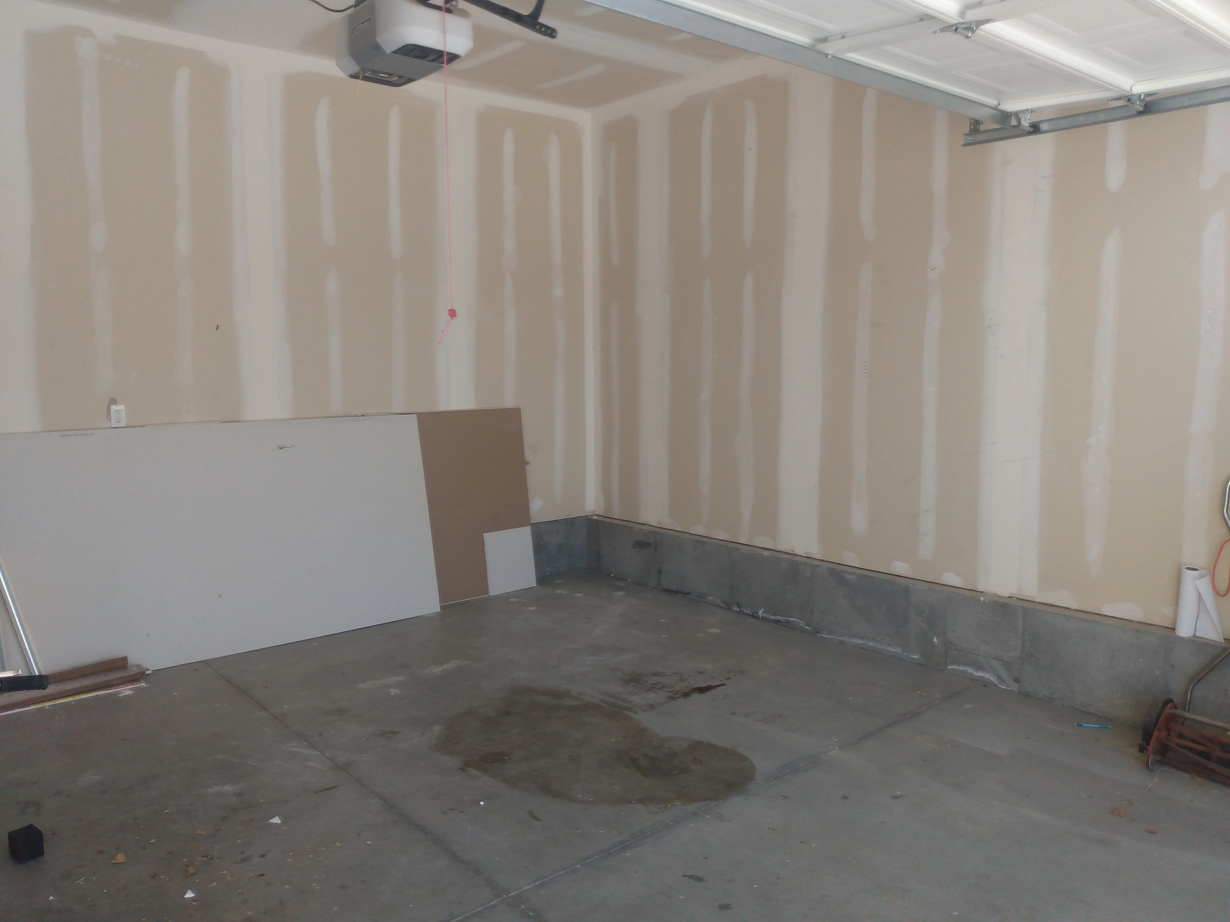

I'm new and haven't built a home studio yet and need an at-home, garage studio easy but effective guide to follow.
Is it okay to setup my home studio and record in my garage? If so, what are your recommendations based on the photos I attached? Acoustics, considering the walls and ceiling,; reverb, etc. Not sure on all the specs? But overall, again, I would very much appreciate expert advice on how to tailor my garage studio to work?

Home studios encompass everything from a laptop & mic in a bedroom to full on professional level spaces. In the end, we are only limited by circumstance or budget. So lets talk about those things. Permanent conversion? Dimensions? Isolation requirements (both keeping noise out and in)? Usage? Live drums & screaming guitar amps? Neighbors, traffic? See where I'm headed with this?
What are you going to be recording? (Vocals, acoustic guitar, full band, etc)
Are you leaving the door as is, or boarding it up?
What recording gear do you have now?
What you are going to need is lots and lots of full-frequency traps (sometimes called bass traps). Compressed fiberglass or rockwool (not foam).
Recording vocals and mixing hip hop music predominantly and possibly mastering as well. As for the door I'm not sure what you mean? Unless you are talking about the sectional garage door that I just had risen up to take a picture and have you see the size of my garage?
Recording gear I have includes a condenser mic/accessories for it, midi keyboard, retina display MacBook, logic pro ableton live, pro tools and an audio interface so far.

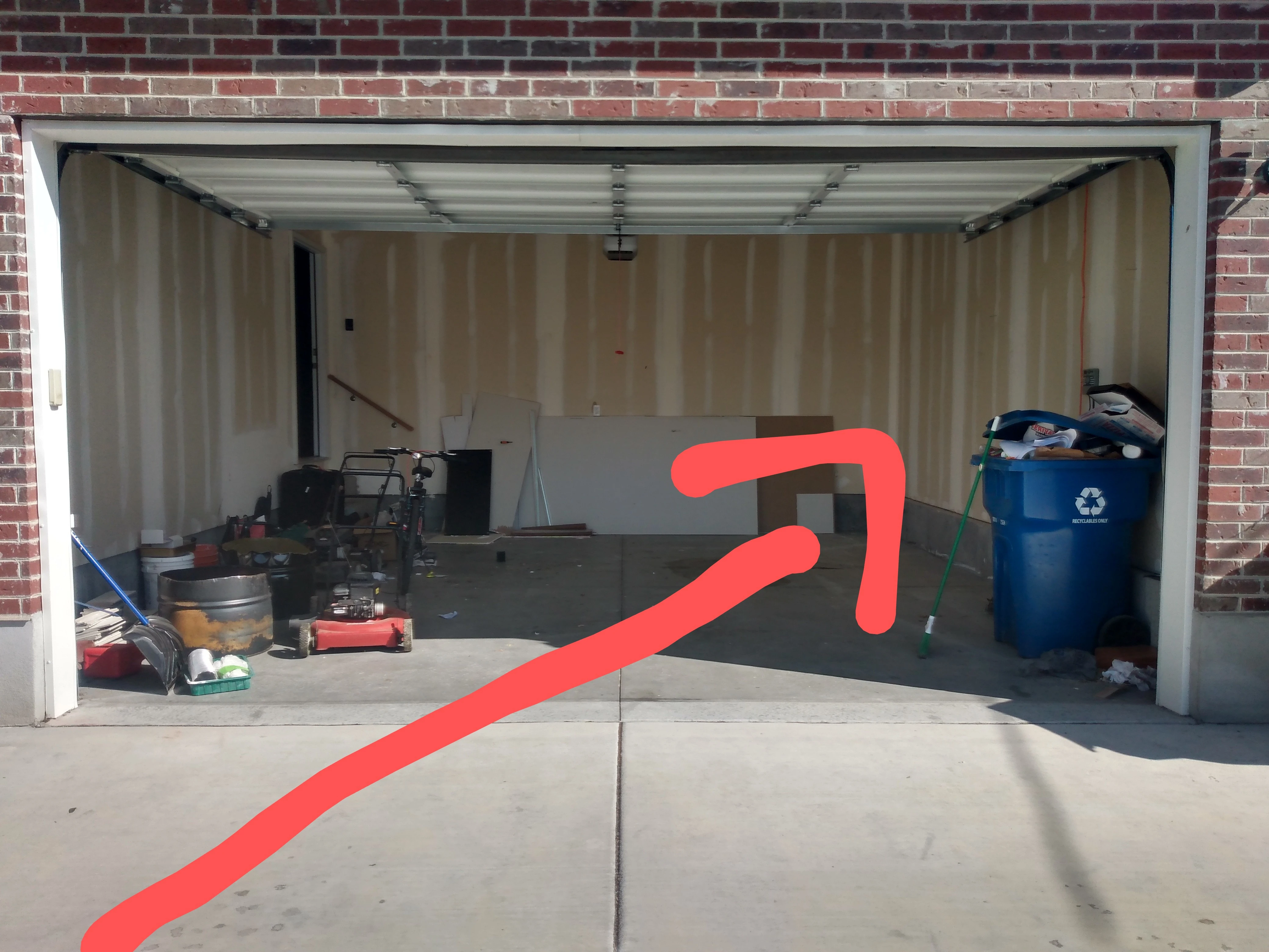

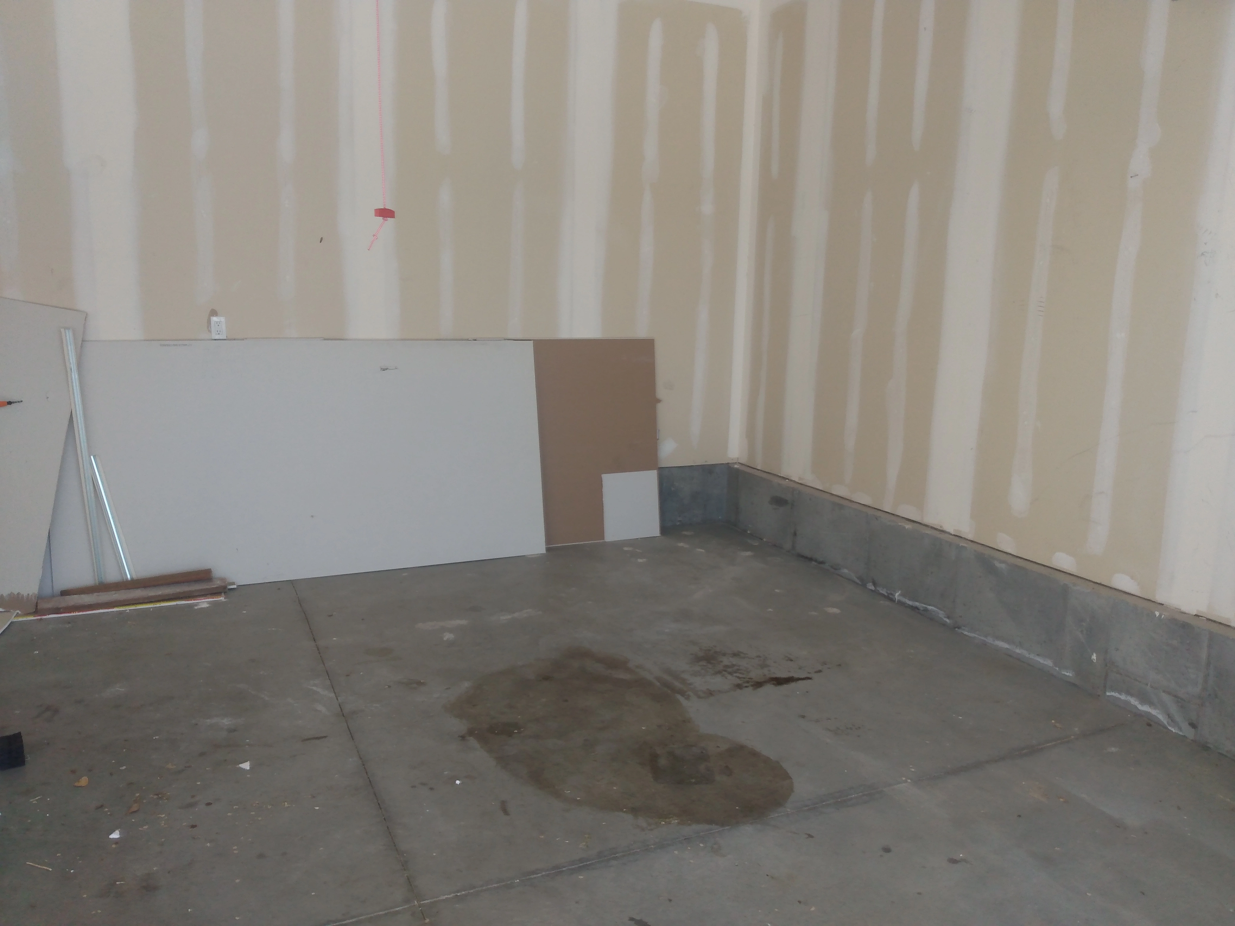

As to the bass traps that's what I imagined I needed I just couldn't think of what they were called. I do need help understanding how they work, how many I should have and based on the pictures I provided where they should be placed? Furthermore, does it matter the position I set my recording space with my desk, etc.? Is it okay to be in that corner area (see attachment I arrowed in red) or in the middle of the garage? Reason I ask is for receiving best efficiency in the acoustics/reverb. Does it matter if my garage door is up to let fresh air in or have it closed? Questions like that.

What you could do is leave the door working, and build a new wall across inside, but your questions suggest you're not yet up to speed on how these things are done. Essentially, you need to isolate - and the normal way is to build a room within the garage space - the layers of plasterboard on walls and c ceiling and the concrete floor can reduce e sound getting in and sound getting out - depending on the thickness. The sound treatment to make it sound nice inside is totally different. Usually you stop the transmission, then make it sound nice in two separate stages. So much depends on how good your DIY skills and available tools are. There are plenty of proper books (not online suspect material) from people like Rod Gervais. This is it the book on amazon.
With care, you can produce a garage studio that can have thump bass played loud and only just detectable outside, at night. Years back, I discovered my teenage son had his mates in my studio many nights when I was in bed and I never noticed! Sheet material has audio specs you can find on the net - but for a room within a room - two or three layers of 12mm plasterboard (US sheetrock?) is a good starting point. Timber framing is still the simplest and most forgiving.

Generally, you do not want to set up in a corner. Bass notes bounce around in corners, which is why corners all need to have bass traps in them (floor to ceiling.
