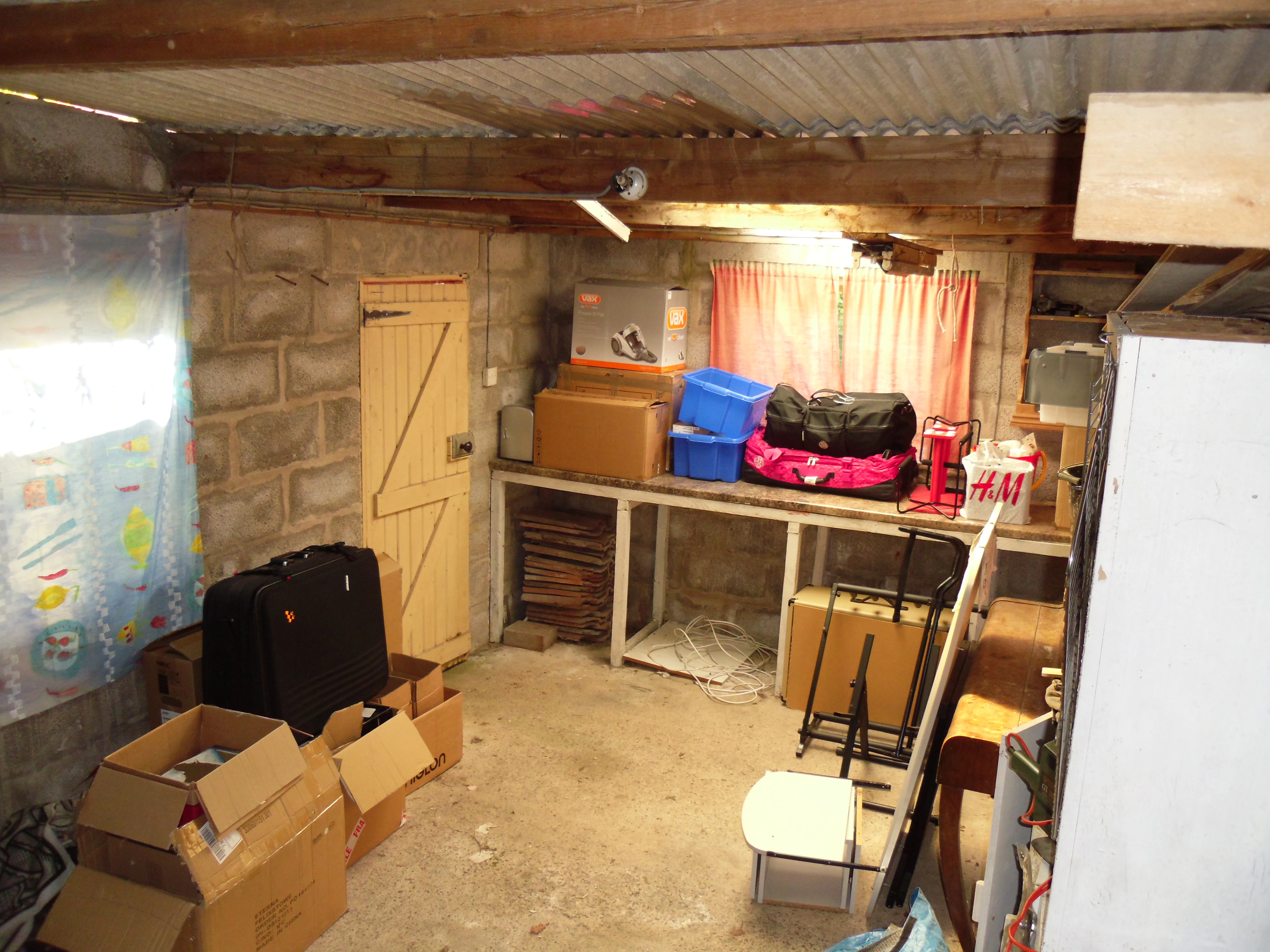

Picture of how it looks currently -

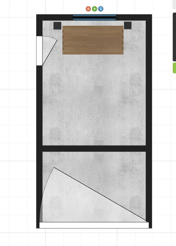

I plan to build a stud partition wall, around 13' down the length of the space, to allow me to retain a small section at the garage door end for general storage. This would leave me with a studio room space of around 13' x 10' to work with.
Rough diagram of the plan -
There are currently 2 windows, one at the top and one along the side of the garage. I plan to block up the window to the side, leaving just the one window at the top. I will then be putting in an internal plasterboard roof, obviously within the studio space only. I will also be changing the crappy wooden door to something more substantial.
So thats my initial plan to get started with. Obviously I am a long way off thinking about acoustic treatment, but I'm in no real rush with this project. Thankfully I will have the help of my in-law, who is in the building trade, but doesn't have any knowledge on the layout of a space for acoustic purposes.
So I guess a couple of questions I have are -
Will I get away with leaving the (3 minus the partition) walls bare, or should I also look to drywall those right away? Will I get away with a rug or carpet on the floor, or will it needed to be treated properly? I guess the best place for the desk will be directly in front of the window at the top, rather than along the stud wall?
